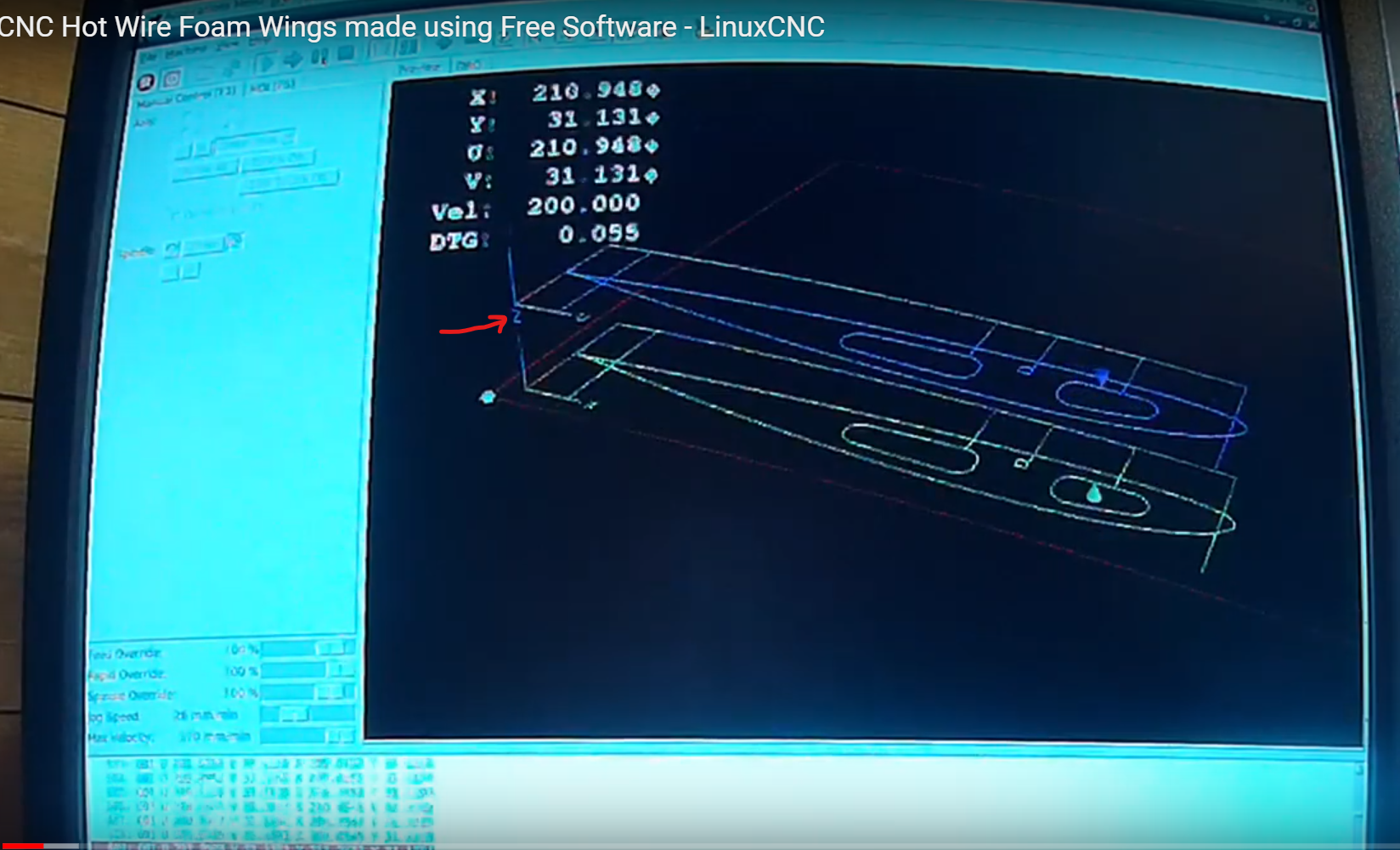

Hi
I have the foam cutter working really well and have posted several videos on YouTube which are quite popular.
But on the display it shows an Z-axis at 38.1mm which doesn't exist in the configuration. Doesn't affect the cutting but just confuses some of my YouTube subscribers.
I've had a look a foam.ngc but that doesn't seem to have anything to do with it.
Any ideas ?
I have the foam option set in the ini
Any ideas ?

it is the just display coordinate system
you cdan get rid of this by VIEW show offsets and cordinate
or in the AXIS.tcl do show cordinate system off
there is a Airfoil python addon for linuxcnc that puts out NACa profiles

Thanks yes that helps. The airfoil generator I have seen before and is quite interesting.

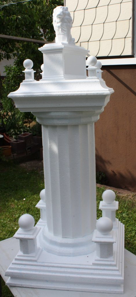

24 Sep 2019 13:55 #146072
by pl7i92
Replied by pl7i92 on topic Foam Cutter GUI shows not existent Z-axis
- rcKeith
- Posts: 15
24 Sep 2019 14:04 #146074
by rcKeith
Replied by rcKeith on topic Foam Cutter GUI shows not existent Z-axis
Thanks for taking the time to look at this. I've seen this in the foam.ngc file is this where I change it ?
Keith
Keith
- Posts: 21895
- Thank you received: 7465
24 Sep 2019 16:07 #146091
Replied by tommylight on topic Foam Cutter GUI shows not existent Z-axis
@PL7i92
That looks nice.
That looks nice.
