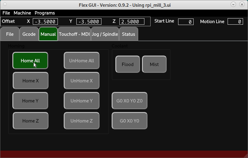

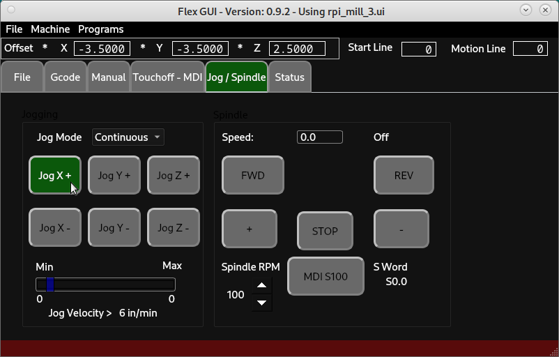

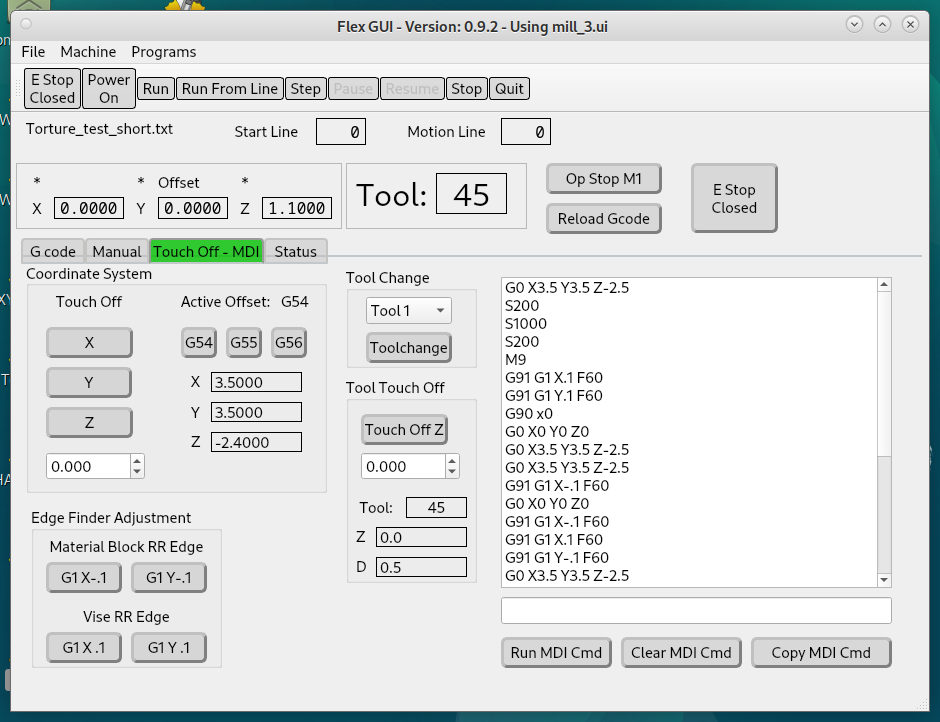

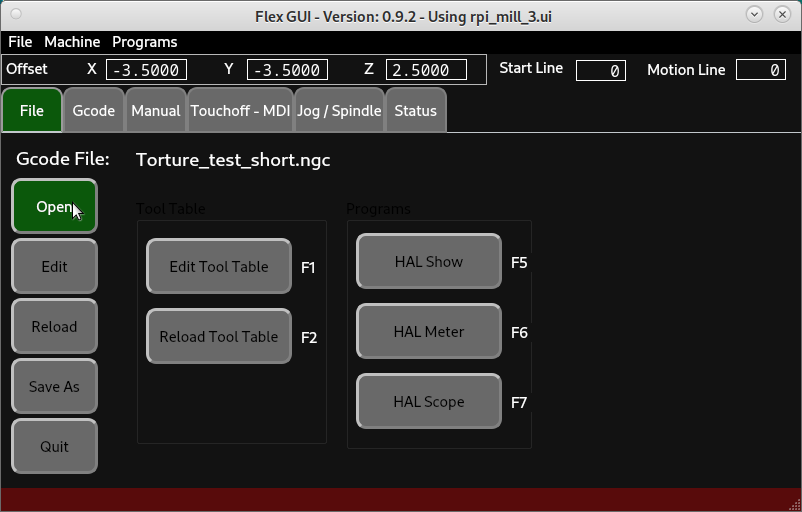

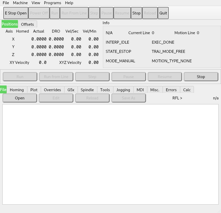

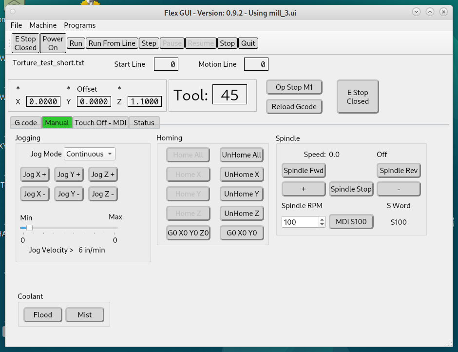

If anyone wants to look at the flexible GUI I'm working on it's
here
and the terse docs are
here.
The idea is to allow users to build a GUI to fit their needs and not be forced to use some predefined GUI. There are some minimal items required, the rest are "discovered" and if there "connected" to the functions. The way this works is you have to name the buttons, labels etc with specific names. They can be placed anywhere you like in the gui. You can use built in stylesheets or use your own. I will probably rename this to Flex in the near future, but for now it's JET cause that's me. You can also use the stock ui file that I'm working with. So pretty flexible!
This is created with PyQt6 and Python 3 so it's future proofed for a few years unlike older GUI's.
JT

Yes, one of the design concepts is no special widgets need be installed in a complicated way like qtvcp and qtpyvcp. No complicated coding is needed just us the Qt Designer to layout your GUI as you please with attention to widget names.
And you're correct all you have to do is name the widgets correctly and the program "finds" them and connects the widgets to the correct code. I'm attempting to make only a few widgets mandatory and the rest optional.
No HAL pins are exported everything is done with the python interface. If creating HAL pins is useful then that can be added.
And sadly the docs are a bit terse and behind development. I'll try and catch them up this morning.

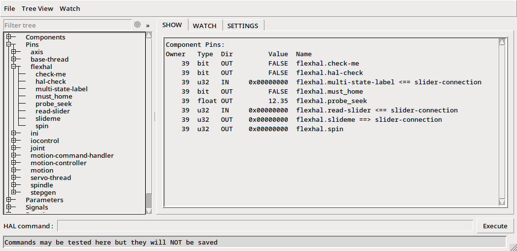

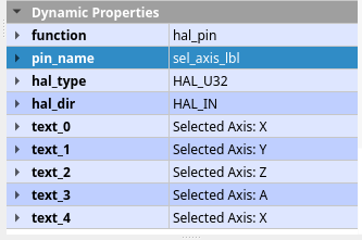

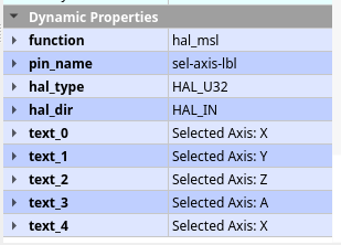

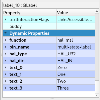

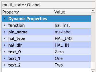

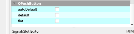

The idea is you create a button for example with a few dynamic properties and the code "discovers" them and makes the pins and connects the button to HAL.
I'm thinking at this point having at least the following dynamic properties (you add them by clicking on the green plus sign in Property Editor for the object and adding a string property.
JT
Replied by JT on topic Flexible GUI

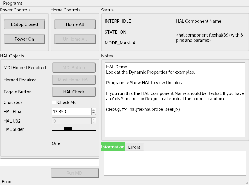

Thanks to Chris helping me figure out why the HAL pins were not showing up I'll have HAL pins connected to widgets by tomorrow!I'd think you can just have the Python handler create a component and export hal pins straight out of Python right?
I think this is a really good idea for most of us who can wire up just about anything but draw a blank stare at anything that doesn't end in .hal or .ini
Name Property
function hal
pin_1 name, type, direction
pin_2 input, hal_bit, hal_inJT

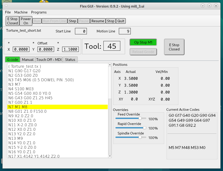

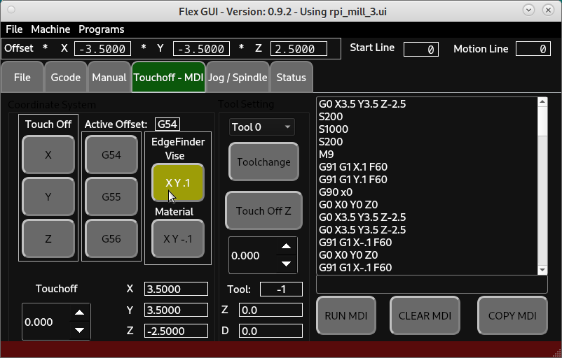

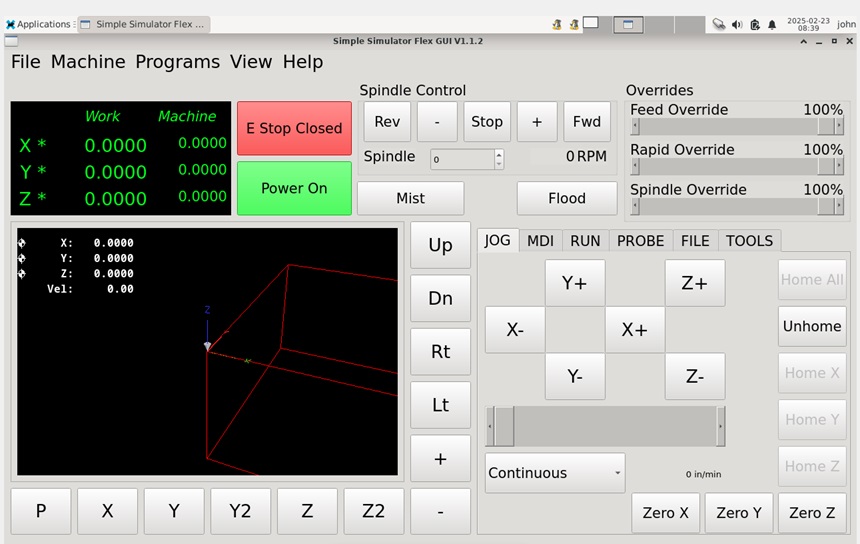

Got the MDI button code working.
You may notice the DRO pausing while running the MDI command and that has been fixed.
JT
JT

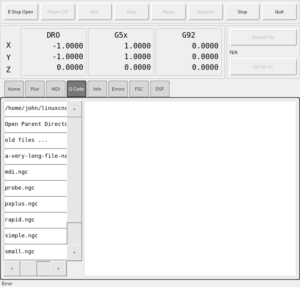

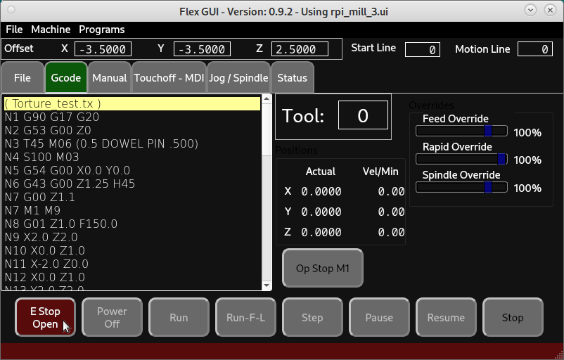

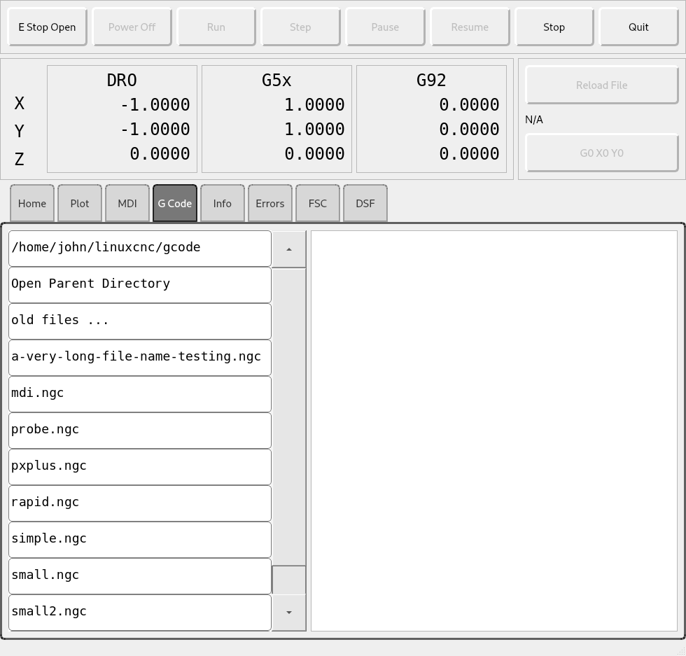

What is the "Plot" tab? is that supposed to be Gremlin? Didn't seem to show anything when I ran the example.
- JT
- Posts: 1103
- Thank you received: 593
07 Feb 2024 17:17 #292761
by JT
JT
No it's not gremlin, it's a brand new plotter based on PyQt6 and OpenGL... just not done yet. Everything in Flex GUI is based on the latest tools so it will last a long time I hope.What is the "Plot" tab? is that supposed to be Gremlin? Didn't seem to show anything when I ran the example.
JT
