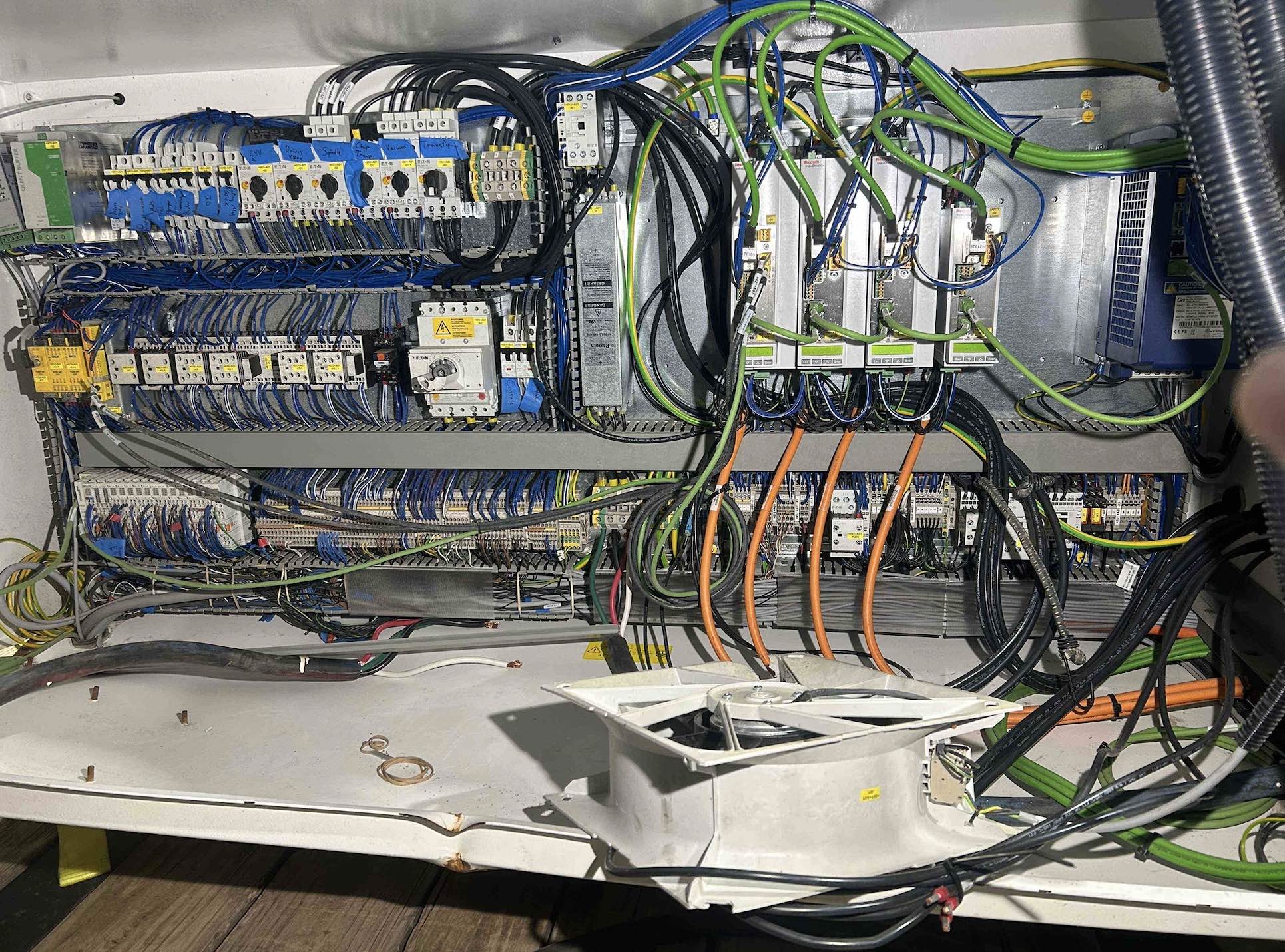

- kworm
- Posts: 60
- Thank you received: 16
25 Sep 2024 13:54 #310771
by kworm
Replied by kworm on topic Flex GUI version 1.0.0
The following user(s) said Thank You: JT
- JT
- Posts: 1017
- Thank you received: 524
25 Sep 2024 14:32 #310776
by JT
Let me know if you need anything or anything in the docs is not clear.
JT
Replied by JT on topic Flex GUI version 1.0.0
That's a lot of I/O.I'm planning on using Flex for the interface on an industrial router that I'm converting. I have to deal with the 100+ I/Os first though
JT
