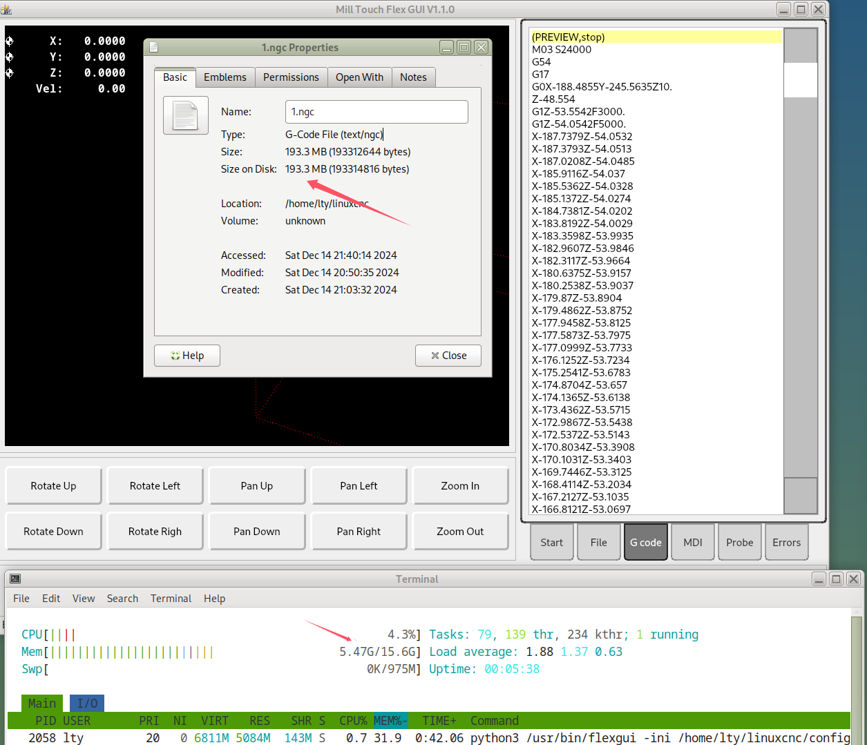

Hello expert, look at the picture description, can you optimize the memory usage?专家你好,看图片描述,你能优化内存使用吗?

(PREVIEW, stop) is some other GUI command, in Flex you uncheck the show program button like I showed above. I have no control over what LinuxCNC does when you open a program, I can only turn off or on the preview.

Is there any way to improve the loading speed of G-CODE, reduce the memory footprint, and operate the response speed of G5X? Updating the plot in real time is too much of an impact on the experience, and the GUI is unresponsive.

Sure just delete the plotter.

Deleting the plot page in QT-Designer has no effect.

I don't think plotter is a must-have feature, and if you can optimize the responsiveness of the Flex GUI to large files, then it's perfect. Thank you!

Does Axis open that large file without any delay?

Could be the gcode text preview. The high lighting can be cpu intensive.
Could you post a sample large file that shows the problem?

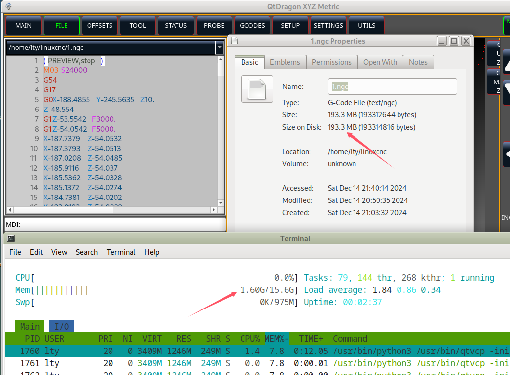

AXIS also takes a long time to open it, plus (AXIS, stop) is the same (BUG?), tklinuxcnc response is positive, whether it is loading G-CODE or artifact coordinate offset, but it only has 3 axes.
