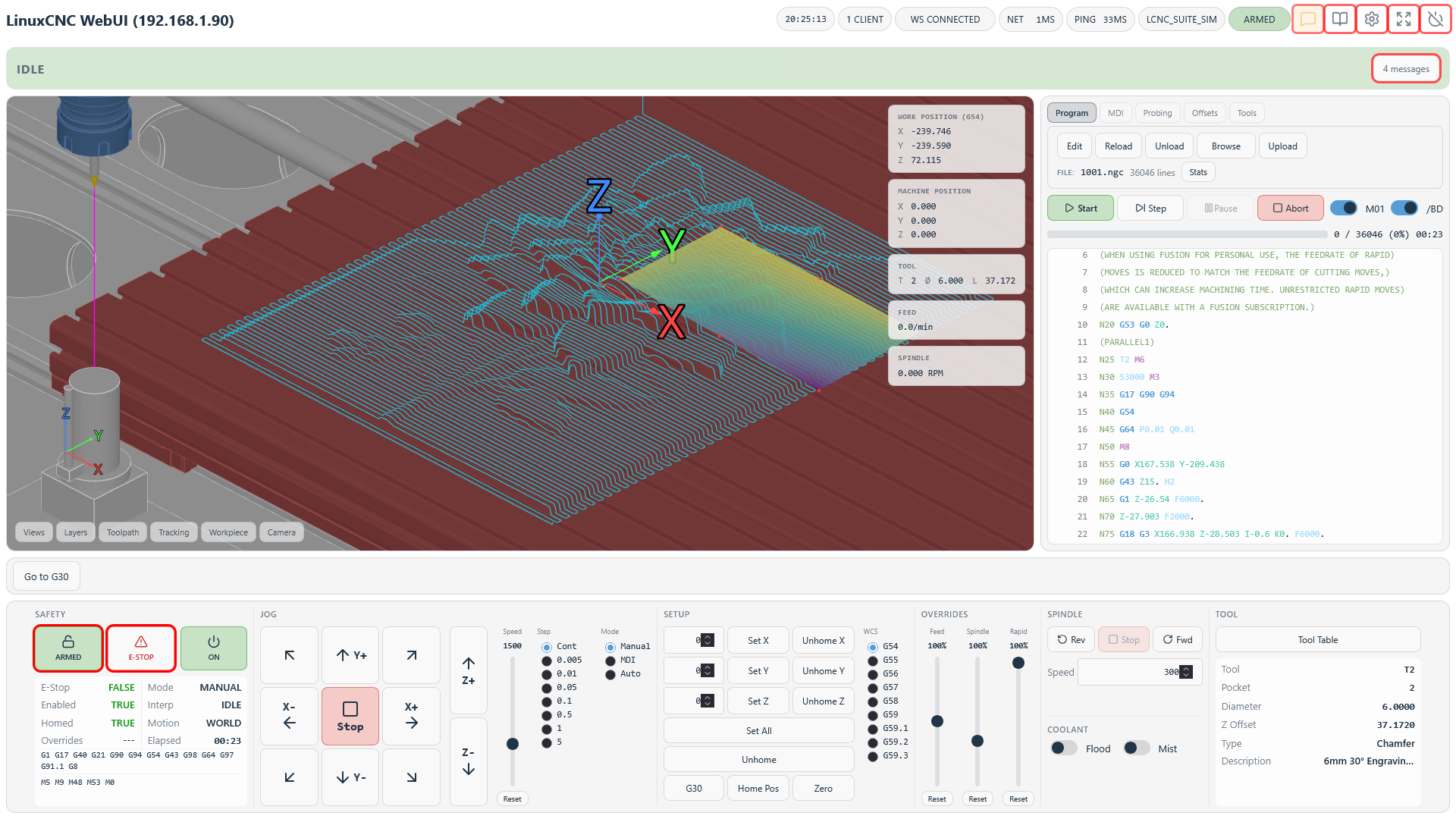

Hello everyone
I've been working on a web UI for LinuxCNC for my own use and thought I'd share it in case anyone finds it useful. Note that I'm not a professional programmer and this was largely AI-assisted, so take it for what it is.
Greetings
github.com/bildobodo/lcnc-suite.git
Greetings

Looks fantastic. Its great seeing more UI options beyond Qt. Just curious, is the display optimized for touch or keyboard input?
Being more of a C/C++ person, I’ve been building a similar pet project focused on a C++ interface layer for LinuxCNC. The idea was to wrap both the NML and HAL polling sides in a clean, multi-client-safe bridge so the same core can support a WebSocket interface for remote clients and a Node.js addon for local UIs. The main goal is to decouple machine access from the frontend layer, making it possible to run multiple displays and control interfaces against a single machine. It's proving to be about as much work as I anticipated
