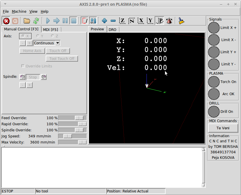

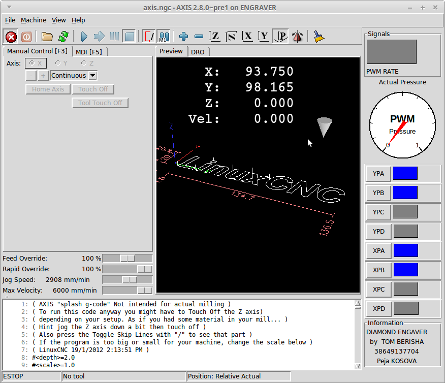

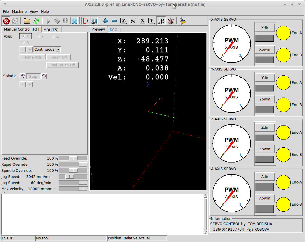

- Posts: 21959
- Thank you received: 7478
14 Sep 2016 17:02 #80448
Replied by tommylight on topic Ausgabe von motion.current-vel
Nice.
Here are some of mine
The following user(s) said Thank You: Tchefter
- Tchefter
- Posts: 197
- Thank you received: 34
14 Sep 2016 17:26 #80451
by Tchefter
Hmm...welll... they are nicer
Pic4/4 can give a Winter-Challenge for me.
Cool Jobs Tommy
Replied by Tchefter on topic Ausgabe von motion.current-vel
Nice.
Cool Jobs Tommy
