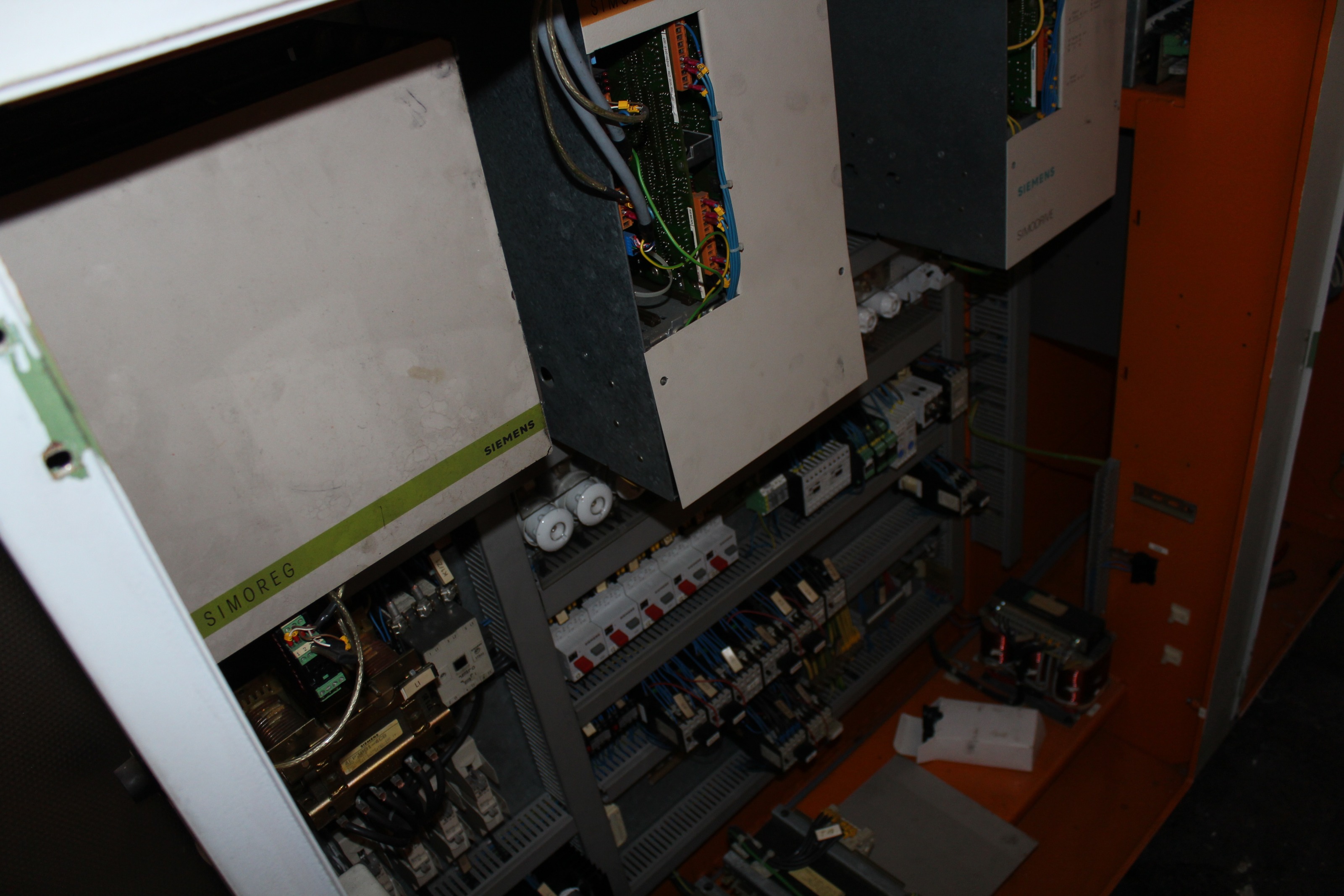

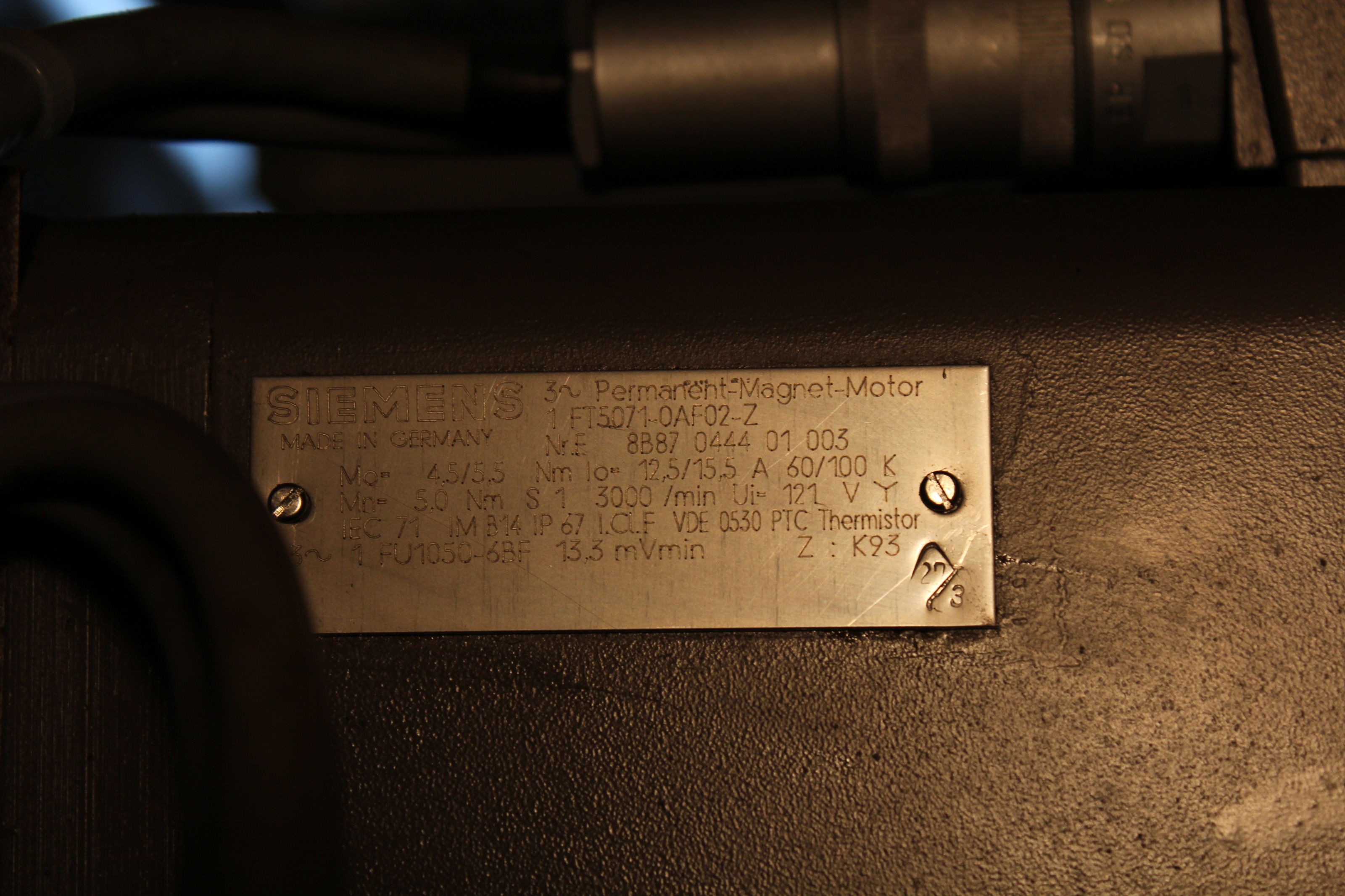

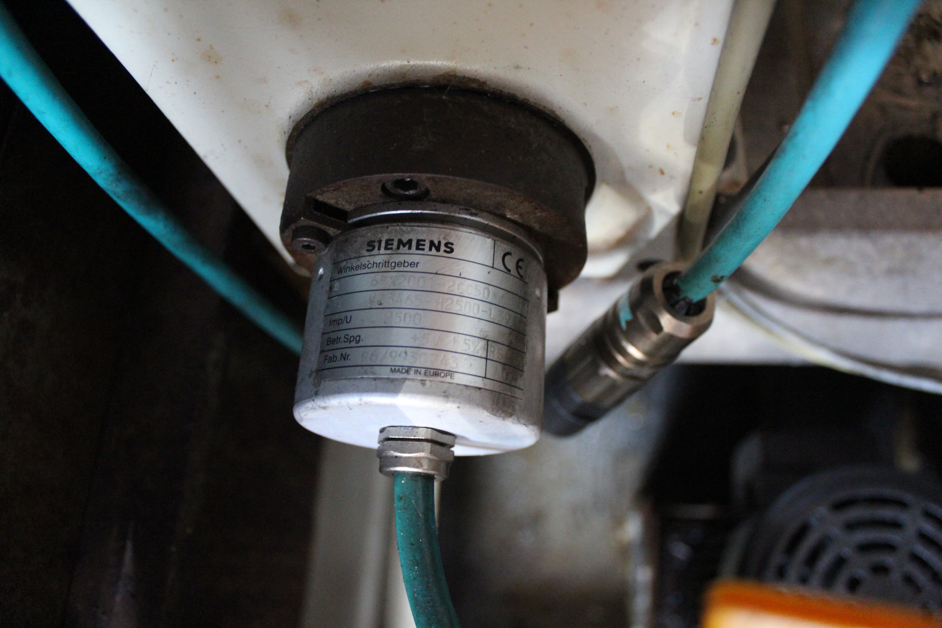

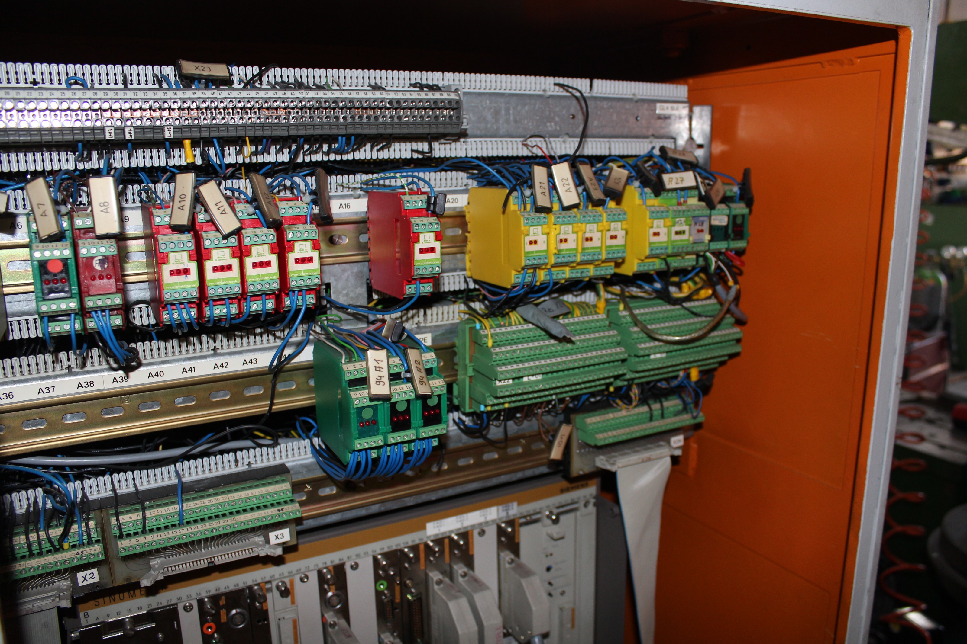

- Leow91
- Posts: 15
27 Mar 2017 21:13 #90395
by Leow91
Replied by Leow91 on topic Umrüstung einer Sinumerik 3T 3-Achs Drehmaschine

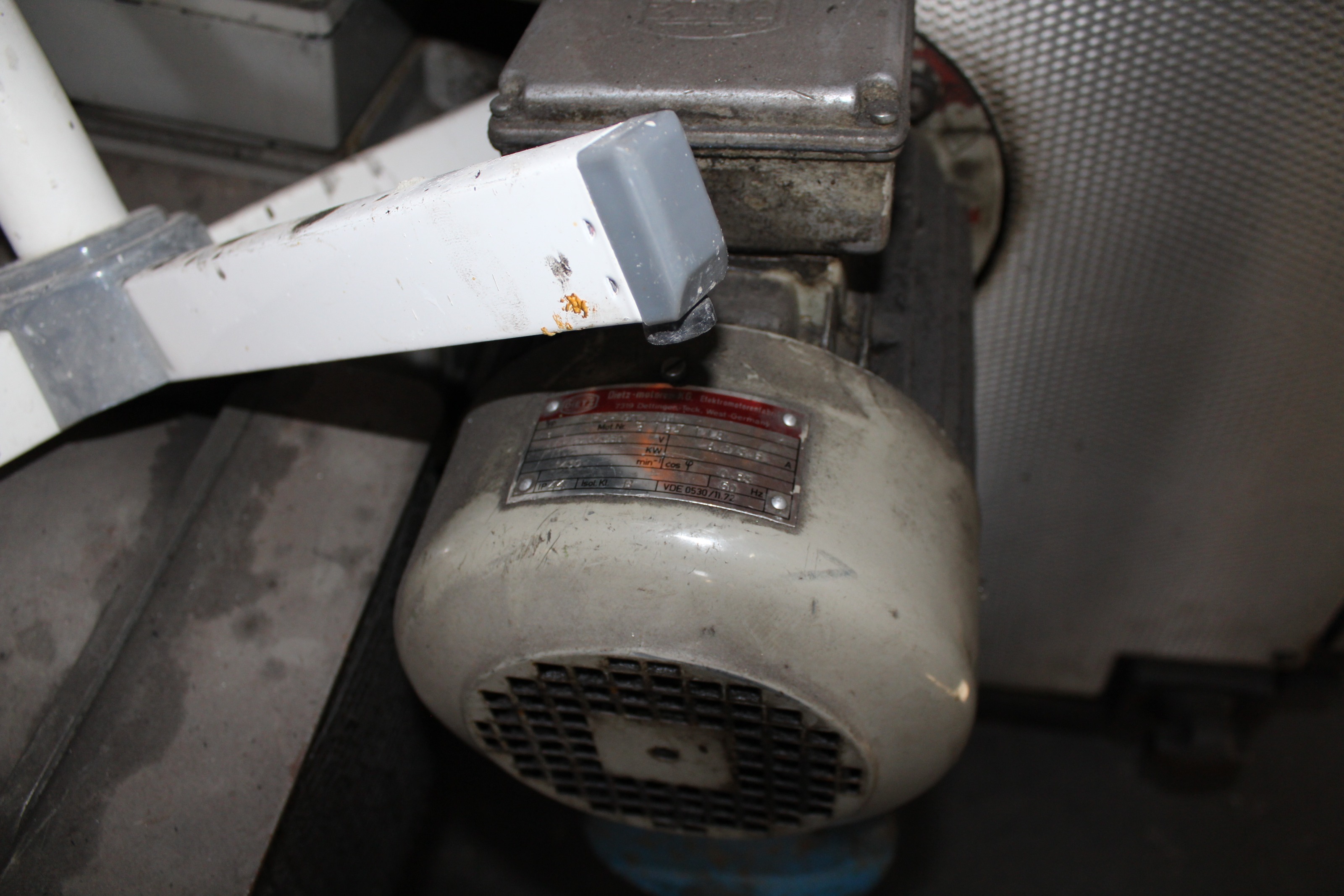

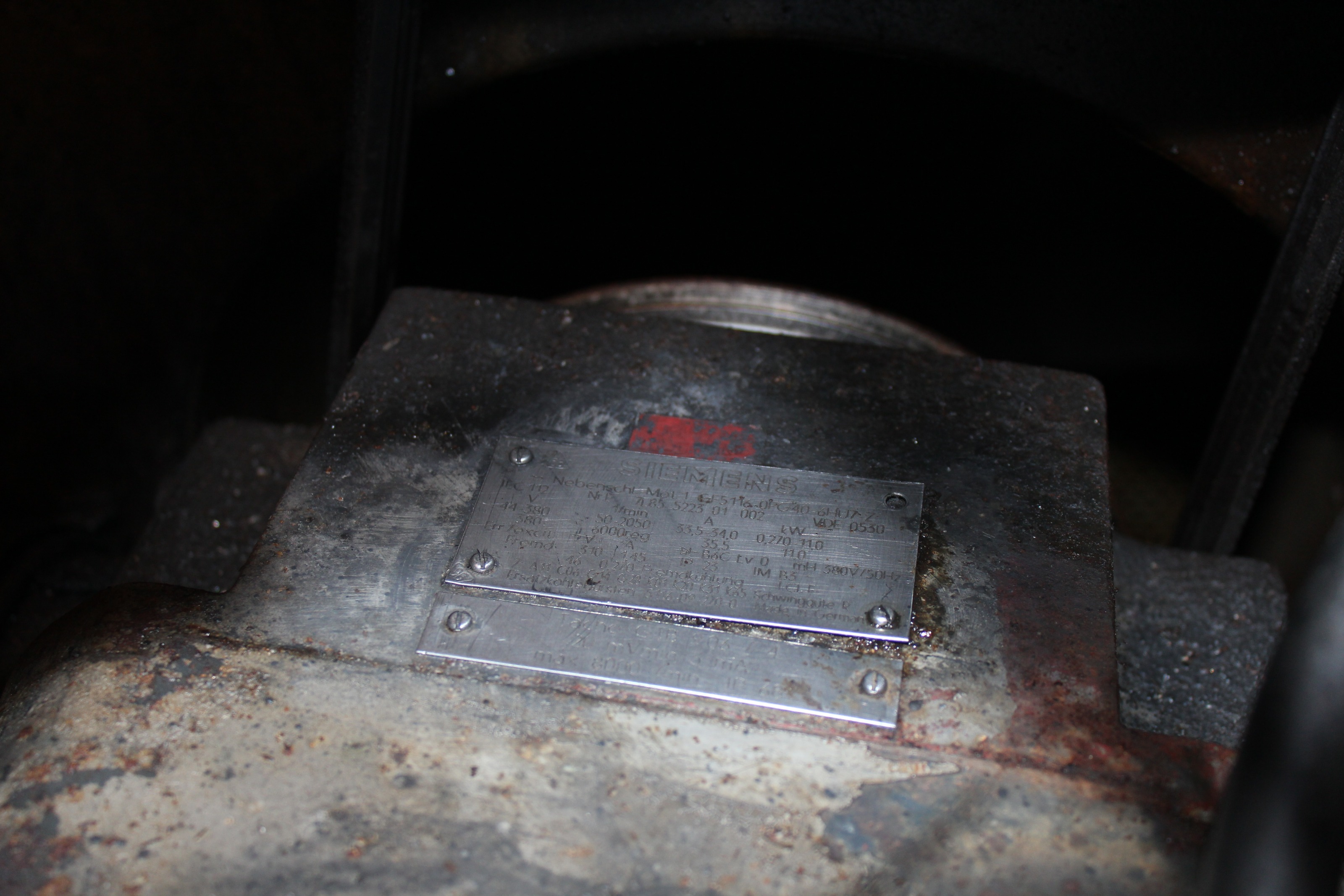

Here are the pictures.
I now will follow up to Tom´s recommendation. I will post again if i know everything of the machine.
If anybody could interpret something about the servo´s that would help me!
The board i got is really the false one. But okay what are other points around the right board? I would now take the 7I77 because of the servo´s are there other points i have to care about?
Best regards
Best regards
- Posts: 21905
- Thank you received: 7465
27 Mar 2017 23:36 #90406
Replied by tommylight on topic Umrüstung einer Sinumerik 3T 3-Achs Drehmaschine
On the first picture that looks like an induction motor, not a servo. Is that the spindle motor?
The second one is a permanent magnet 3 phase servo motor, can be used as is with the existing drives or with other drives.
Encoder looks like a normal incremental encoder with 2500 pulses per revolution, so it can be used with Mesa 7i77, but do check the voltage for it as Mesa works with 5V ones, even 24V ones can be made to work but require simple voltage dividers and have to be powered from the existing power source, not from the mesa board.
Drives csn not be seen good, but look to have Siemens writen on it, so check if they are +-10V controlled ones. You have to be sure for this as the Mesa 7i77 works only with those. Anything else for control and we would need more info.

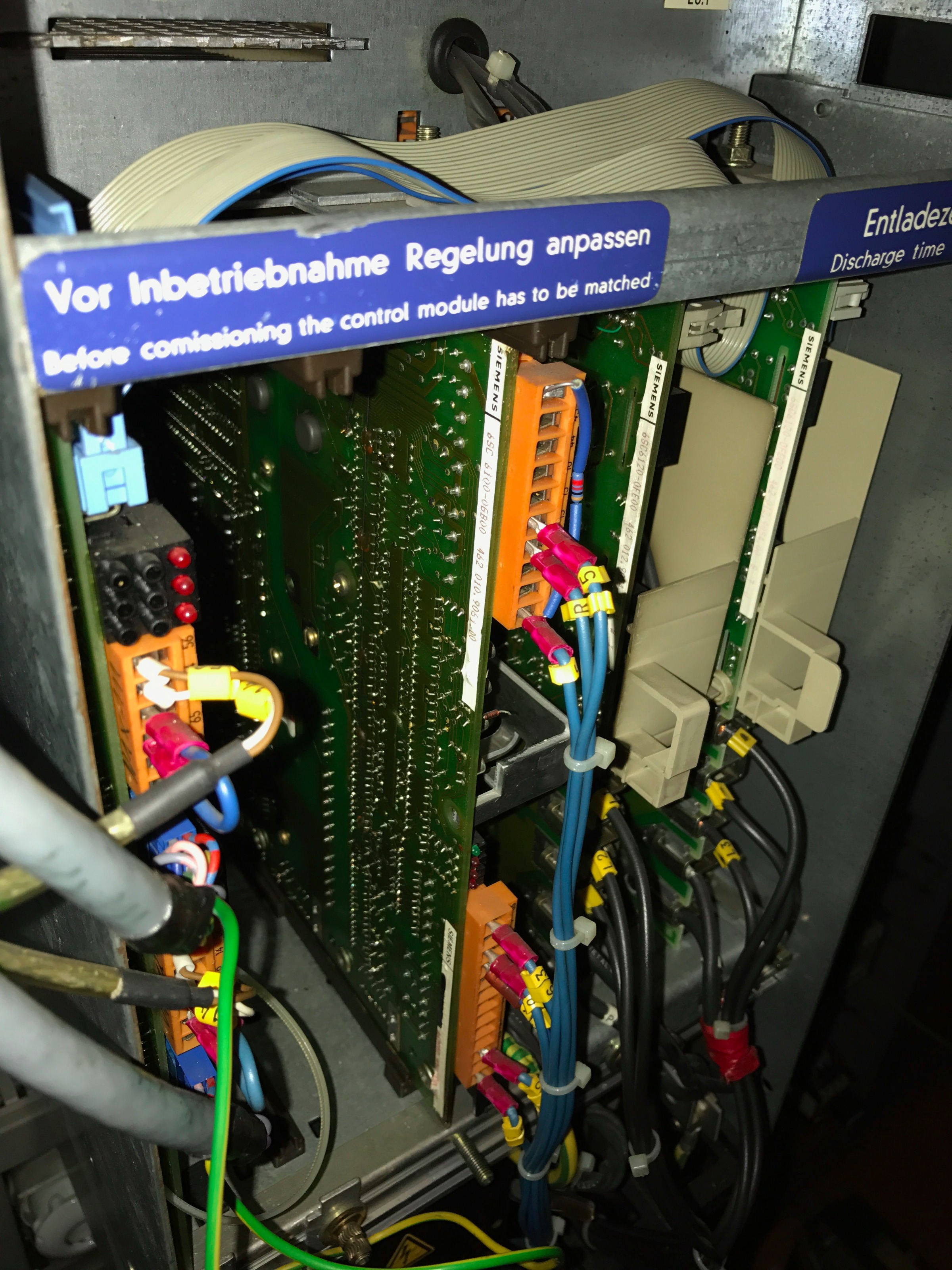

- Leow91
- Posts: 15
03 Apr 2017 21:31 #90819
by Leow91

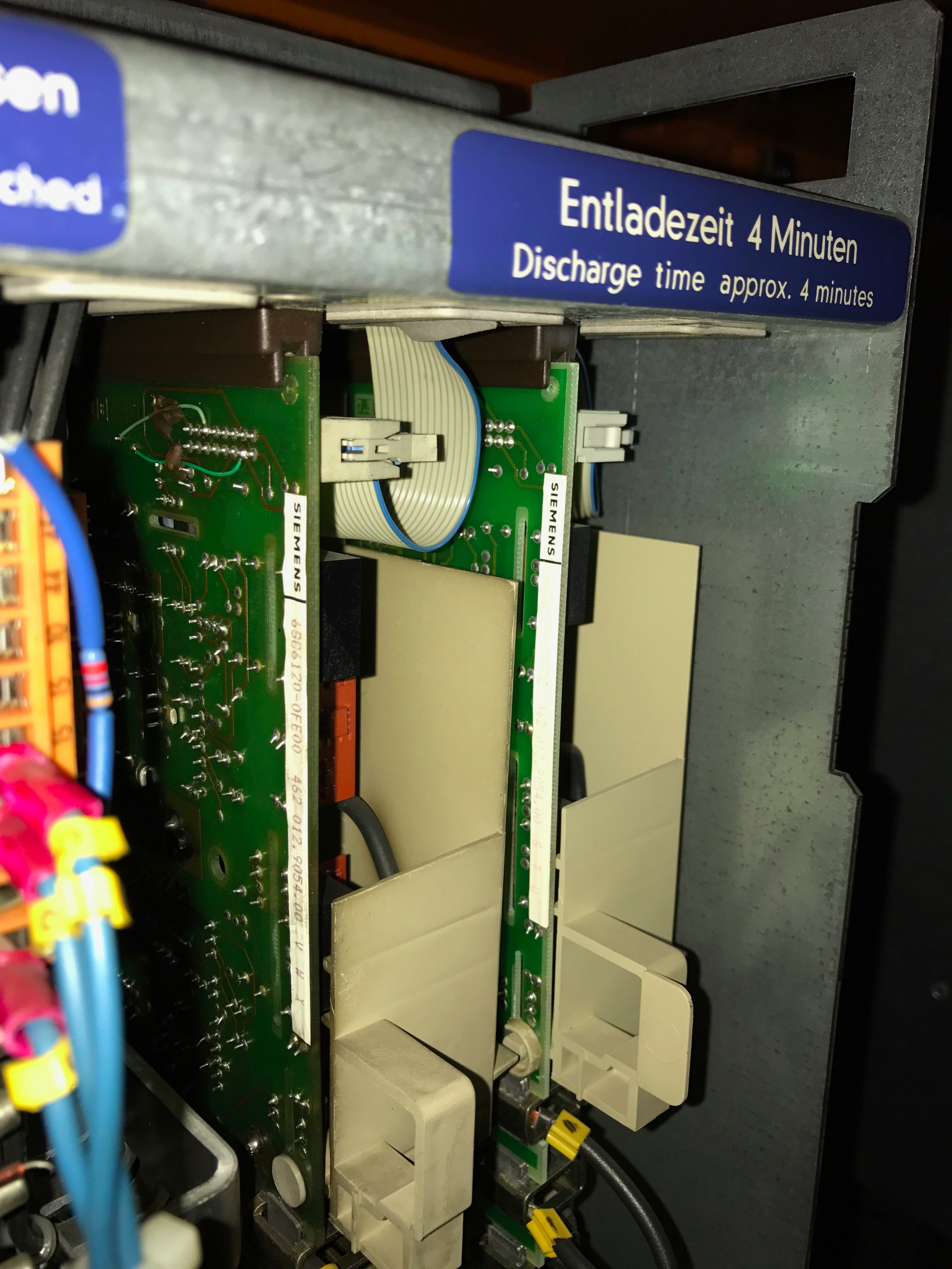

- Leow91
- Posts: 15
03 Apr 2017 21:34 #90821
by Leow91

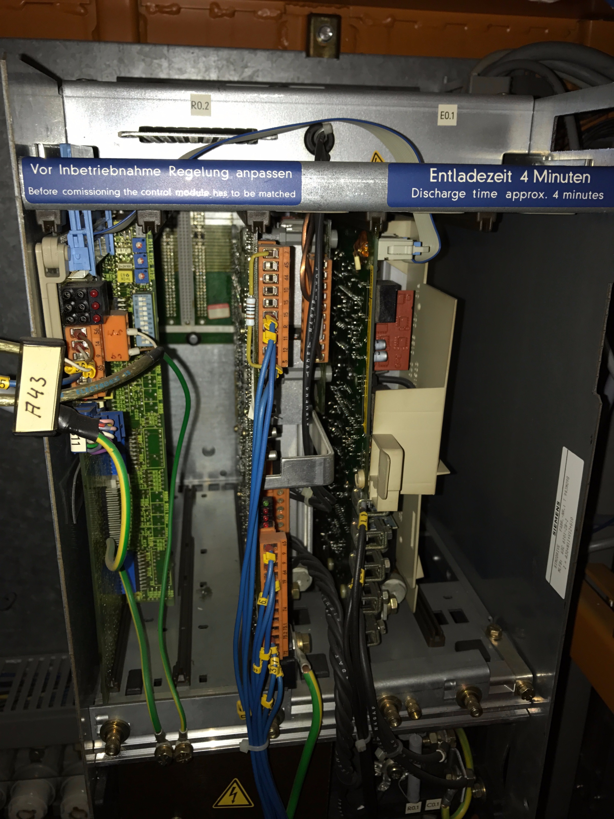

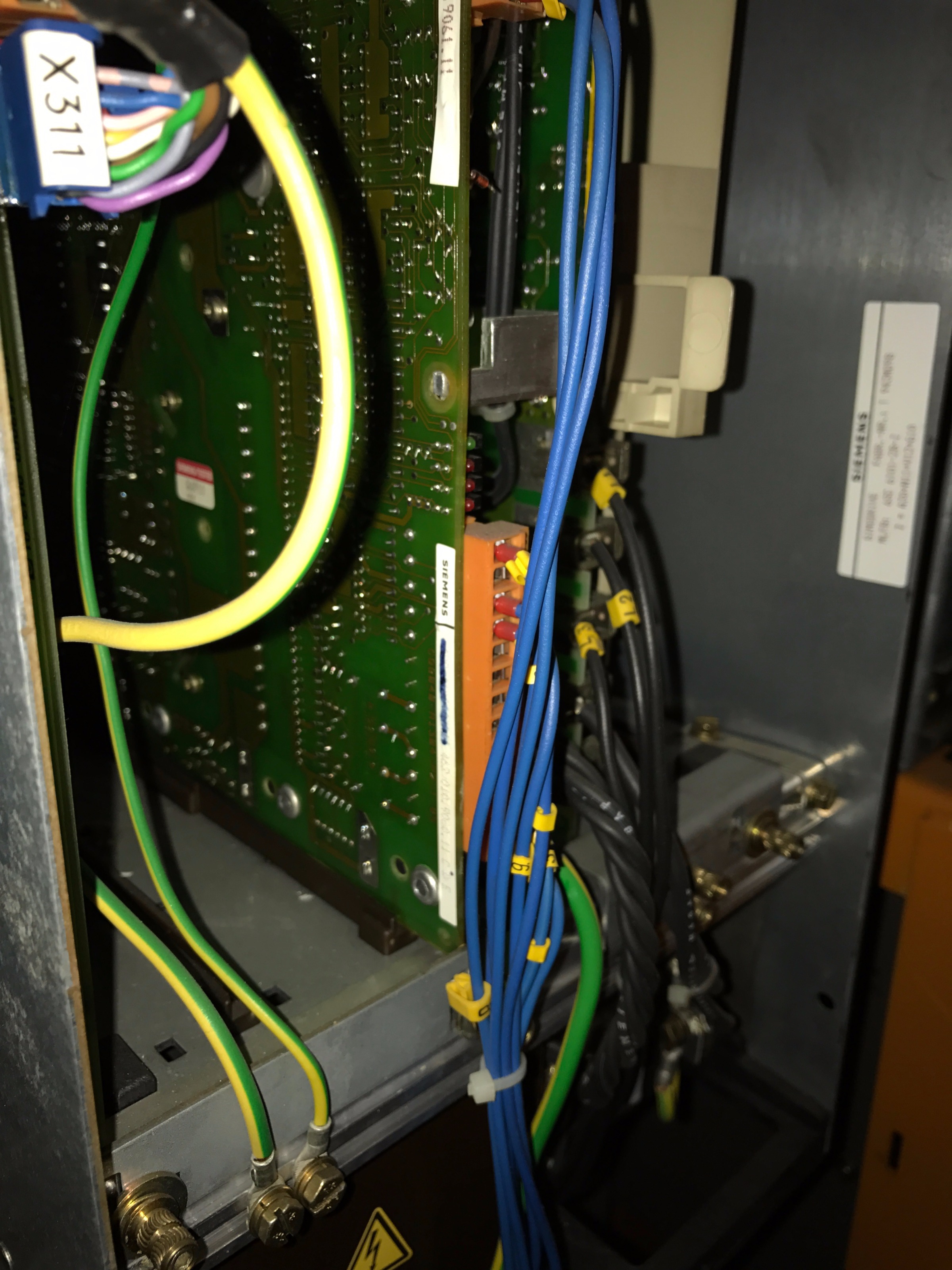

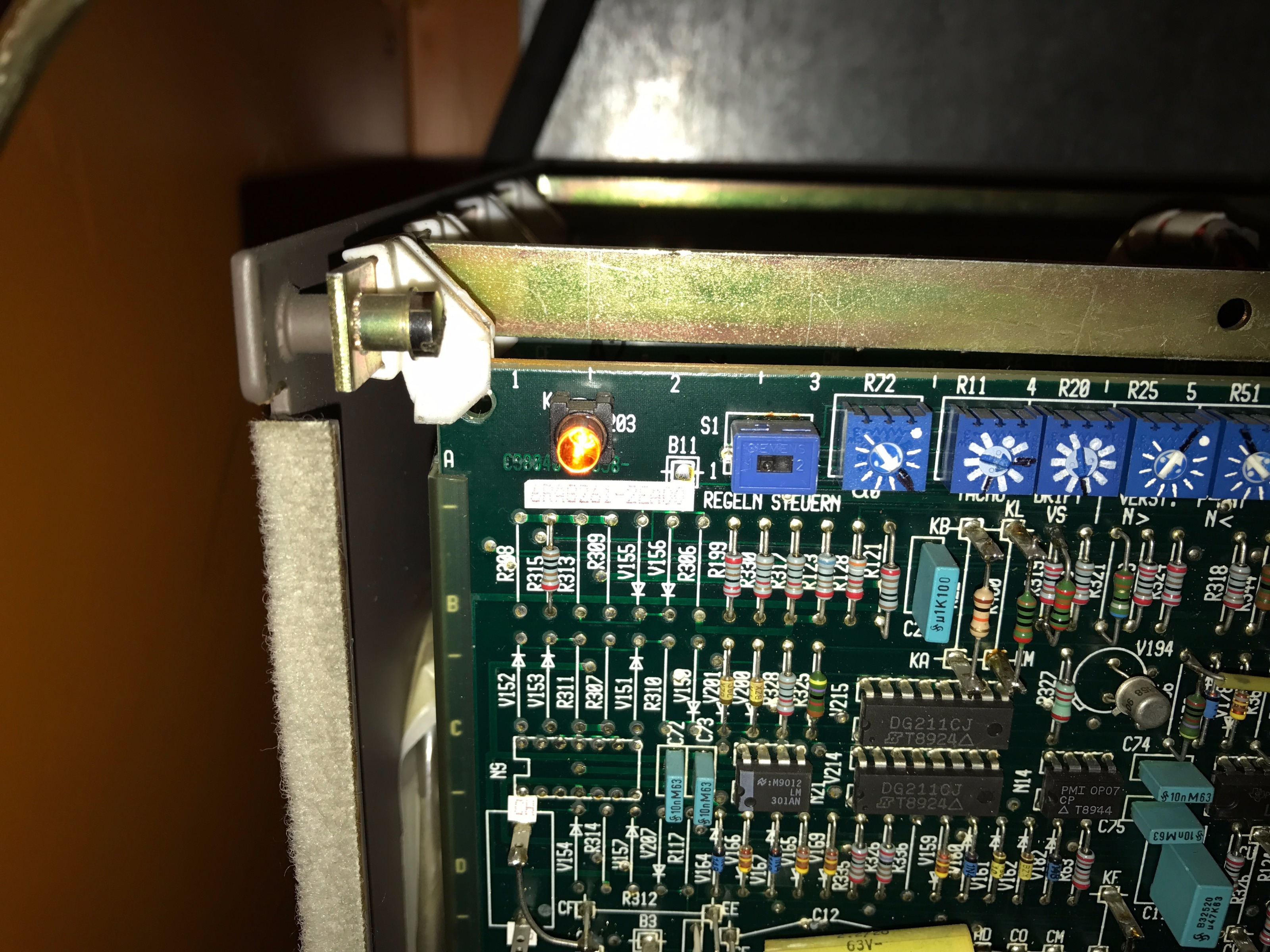

I have made some new pictures from the simudrive.
Could you tell me if this are the ones i have to deassemble for wiring with the controller? I can´t find the signal or something around the signal i think thats because i don´t know whats the encoder and what it´s look like.
Here are some pictures which i think are nearly to the servos right?
Maybe anybody near 92676 Eschenbach -Germany to help me out?
