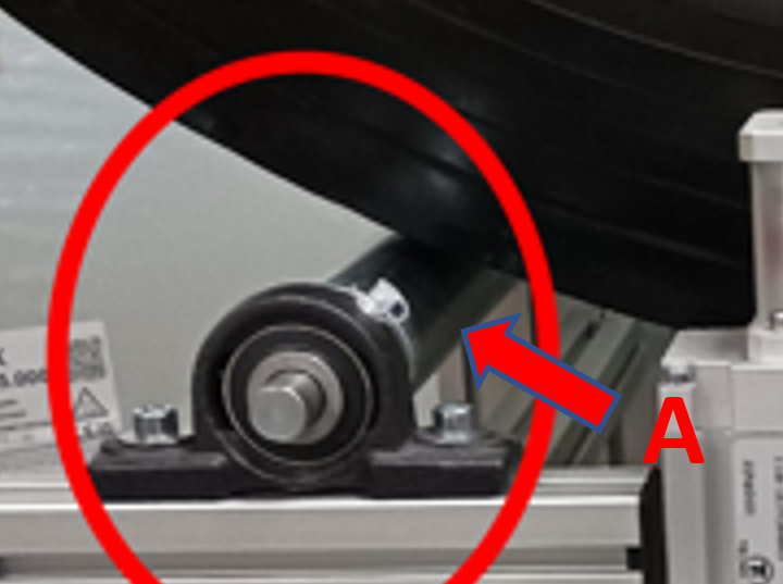

This axle turns a car wheel, it doesn't have to run fast but it would be nice to run a little faster than now.
Picture, the motor with dribble is on the back, I don't have another picture right now.

Nothing in that picture has a perimeter of 360mm.
what diameter shaft?
what wheel size?
what tire size?
Do you want to scale it to shaft or to wheel?
Replied by tommylight on topic stepgen.03.maxvel is too big for current step timings & position-scale, Clipping
Of what?Corner of travel: 360 mm / revolution
what wheel size?
what tire size?

I used 360mm because that is the number of degrees of a circle
The shaft A has a diameter of 5cm (I think, I have to measure it).
The tyre can have a diameter of 40cm to approx. 110cm.
If you ask like that, I would do the dimensioning based on the shaft.
I have tested by hand a speed of about 7mm/second when I want to rotate the tyre under load.
It would be good if I could move the shaft at 7mm/second under load, more than that in rapid traverse.
At the moment I doubt that I can achieve these speeds with this gearbox.
