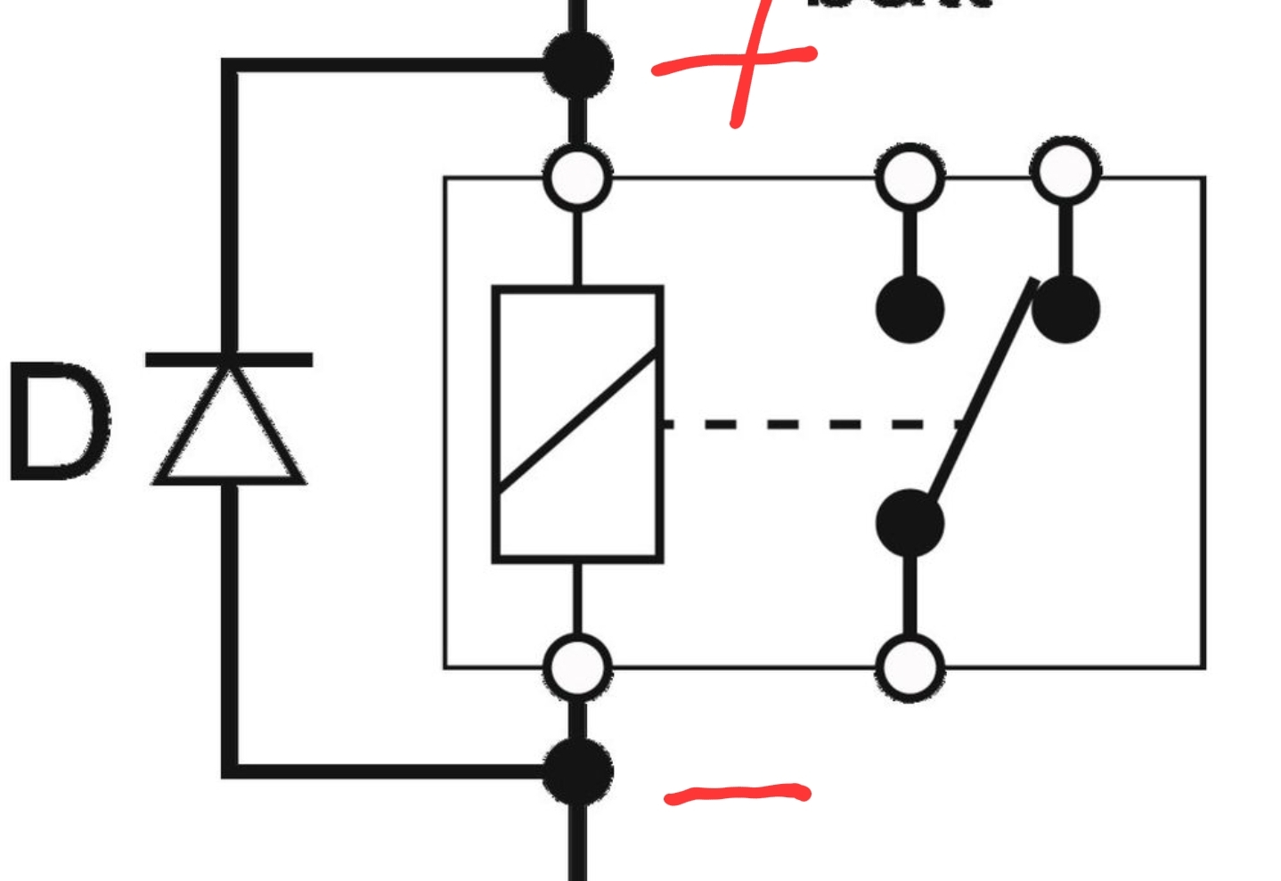

-Get another mouse with better/thicker cable
-Put a ferrite "doughnut" on the motor wires just outside of the VFD
-Put a diode in parallel with the relay coil, mind the polarity

13 Jan 2025 20:48 - 13 Jan 2025 20:49 #318879
by chrischan
Replied by chrischan on topic Maus funktioniert nicht bei Spindel Start
Last edit: 13 Jan 2025 20:49 by chrischan.
- Posts: 21959
- Thank you received: 7478
13 Jan 2025 21:11 #318882
Replied by tommylight on topic Maus funktioniert nicht bei Spindel Start
Yes.
Do check if the ralay has one already, some do but mostly do not have it.

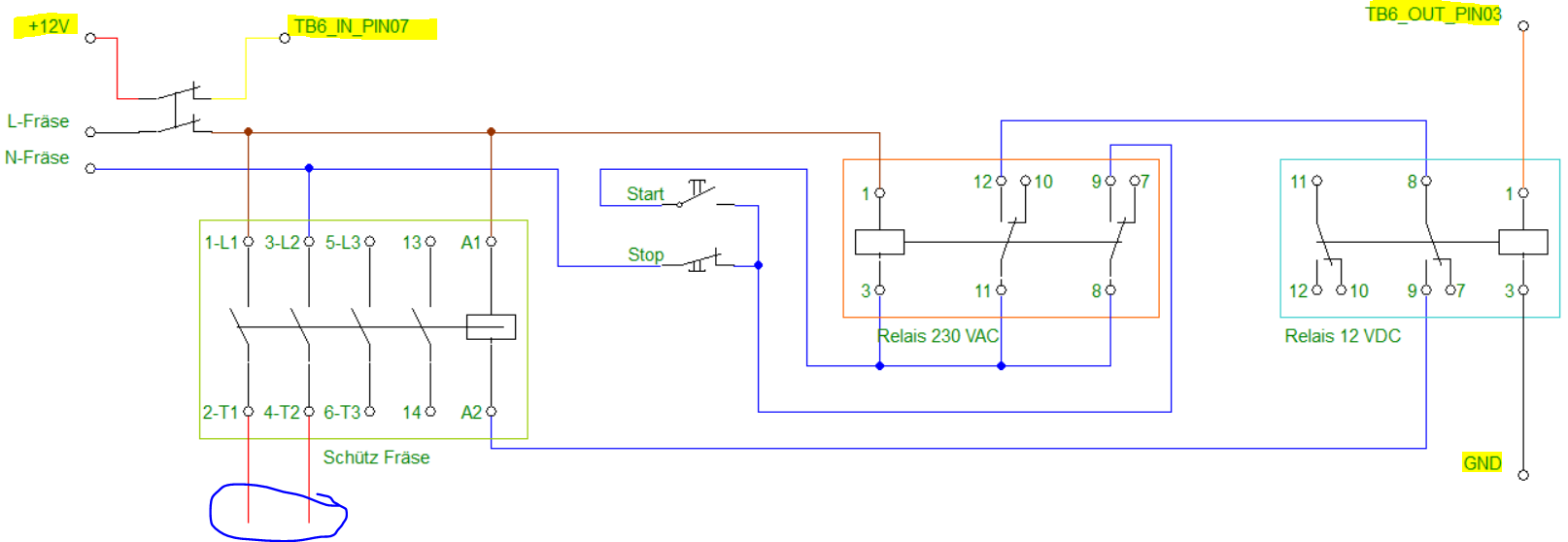

- chrischan
- Posts: 34
15 Jan 2025 07:25 #319004
by chrischan
Unfortunately the VFD is a special construction from Paulimot (Paulimot F207-V). I have to take a closer look insight the machine if it is possible to use ferrite beads.
Propably for better understanding I added the wiring diagram of my relays:
Yellow marked are the contacts that are provided by the Mesa 7i76. The TB6_OUT_Pin03 switches +12V when spindle is activated in LinuxCNC.
I made 2 tests:
- When disconnecting Pin03 and using 12V directly from power supply, there is no problem with the mouse.
- When using Pin03 (activated) and then stopping the spindle with stop switch (in the middle) the mouse is also Ok.
On the left side the 2 red cables at the bottom are connected with the internal VFD.
I already ordered a SSR and will test it the next days. And I will have a look inside the VFD.
I made 2 tests:
- Plasmanfm
- Posts: 130
- Thank you received: 22
15 Jan 2025 16:22 - 15 Jan 2025 16:28 #319035
by Plasmanfm
Replied by Plasmanfm on topic Maus funktioniert nicht bei Spindel Start
was ist das für ein Schaltungs Müll !!!
Mal den N und mal den L zu schalten ist absoluter Müll man schaltet nur den den L !
What kind of circuit garbage is this !!!
To switch the N and sometimes the L,
Juegen
Juegen
