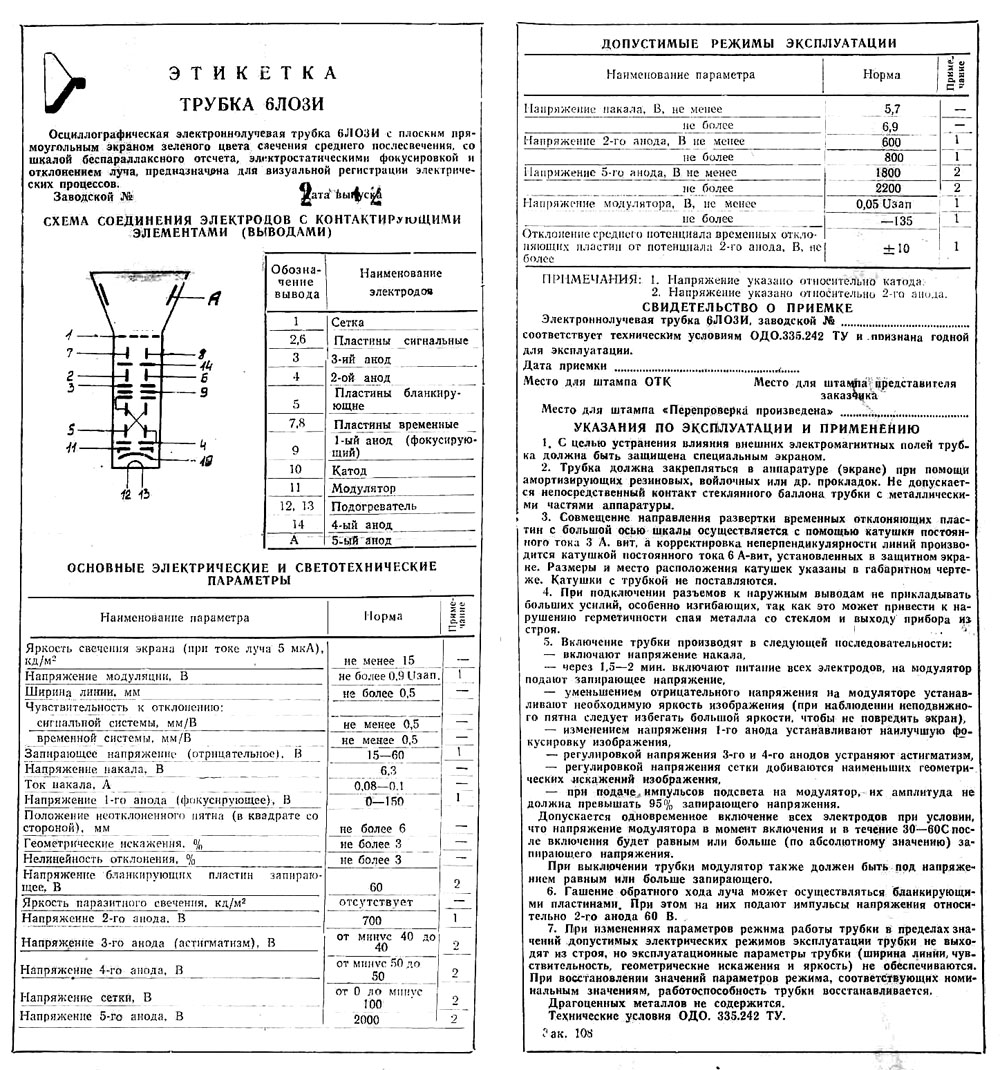

Sorry for being off-topic.
I am in search of someone who can translate a Russian language datasheet for me. It is not LinuxCNC related, it's a picture tube for a piece of old test gear. I can't buy the original tube, but this one is the same dimensions and I *think* same voltages. (Looks almost identical) I just need some help verifying what it says. It's part of an ultrasonic thickness tester.
Mostly the table right next to the picture, would help me get started. Eventually I'll have to figure out the whole thing, but so far Google Translate has not been terribly helpful.

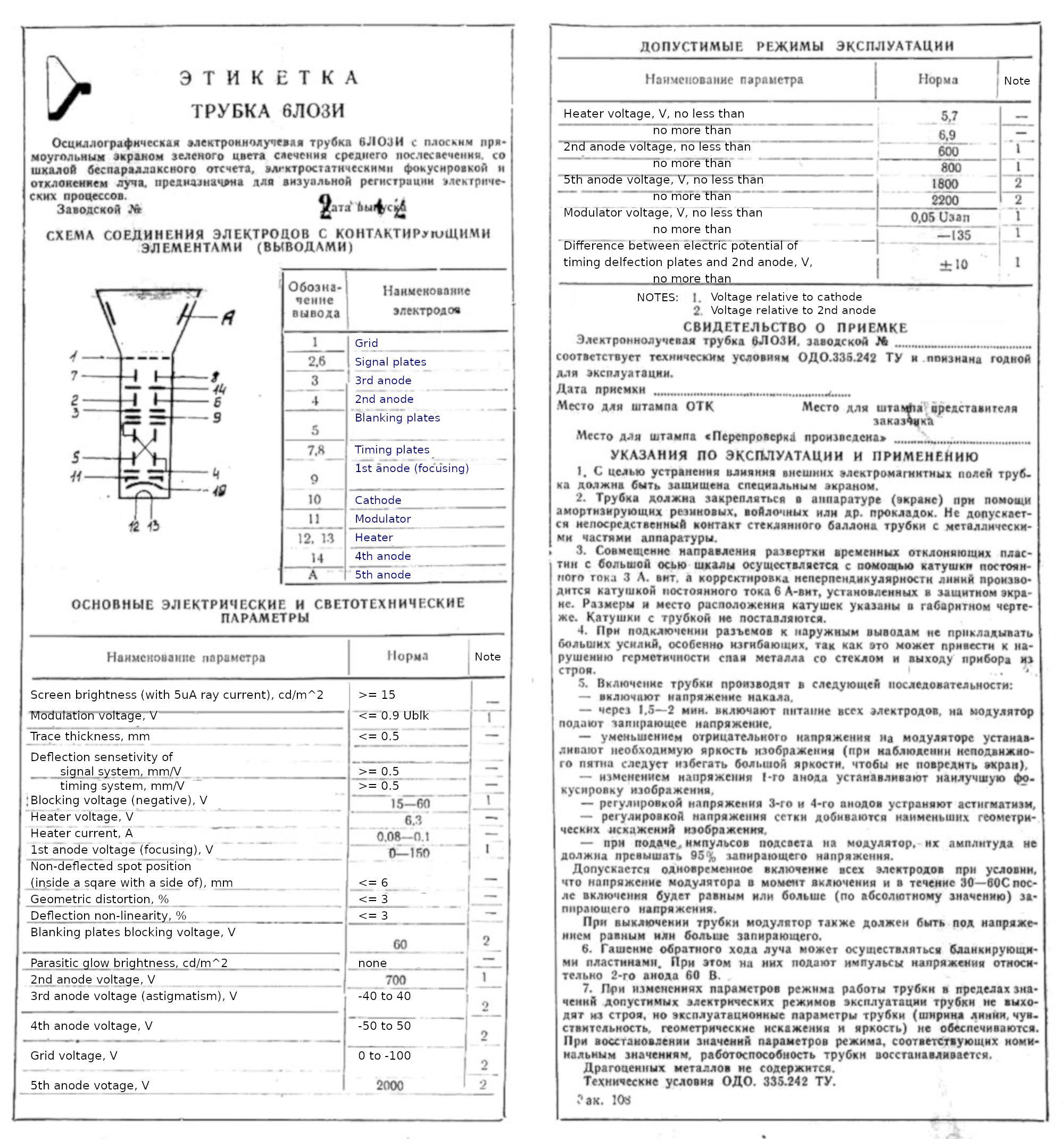

here you go. i'm not into vacuum tube tech, tell me if something doesn't make much sense...

That's fantastic. You did a great job.
It seems like I'll have to change a few reisistors here and there but everything else is within specification, so I should be able to get my ultrasonic tester back working properly again.
Thank you very much. I could have bought a new tester-but I just like this old one. It works well, and has that "cool factor" that gets a lot of my customers curious-makes for an easy sell to check all the old engine blocks laying around their shop!

no problem.
btw, those 6LO3I CRTs are still available here as NOS, for $15 apiece
