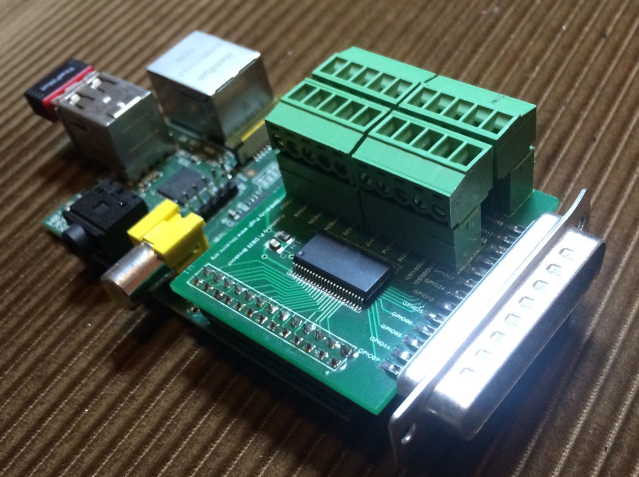

06 May 2016 22:43 - 06 May 2016 22:44 #74321 by andypugh
Replied by andypugh on topic raspberry + linuxcnc
Pi avec parallel port (buffered 5V)
Last edit: 06 May 2016 22:44 by andypugh.
07 May 2016 14:12 #74342 by Amedee
Replied by Amedee on topic raspberry + linuxcnc
Nice one Andy!
Still, I guess we would need an RTAI kernel -- I don't think we will get good enough latency with RT-Prempt/userspace to drive through parallel port...
