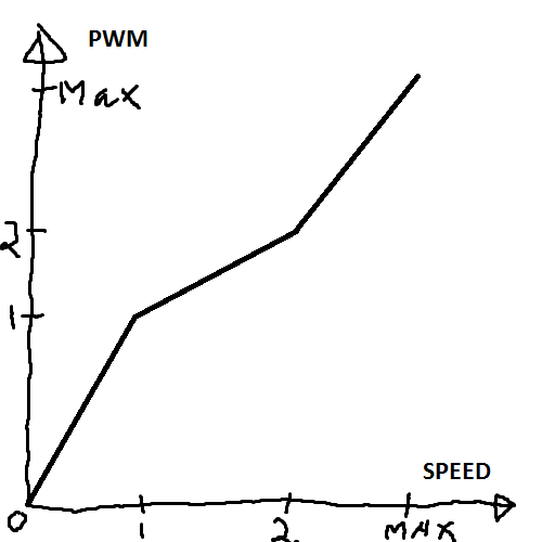

- olesk
- Posts: 11
06 Sep 2014 17:01 #50841
by olesk
Yes, that sounds like a good manual override. I can't for the life of me get the RPMs to fit at all with the PWM ("non-linear" is a massive understatement), but since I'm using an Arduino between the PWM from LinuxCNC and the final PWM the speed controller is getting, I'll probably cheat and simply do the conversion on the Arudino, so that S12000M3 in your example, _actually_ gives me 12000RPM
Replied by olesk on topic Spindle RPM control and Z-axis homing
Not an answer to your original question, but my preferred method to turn on the spindle at the desired speed is to go the the MDI tab (press F5), and enter S<desired rpm>M3. Thus, if you want 12000rpm, you enter S12000M3. Then press F3 to go back to the jogging/homing tab.

06 Sep 2014 18:25 #50845
by DaBit
Replied by DaBit on topic Spindle RPM control and Z-axis homing
Maybe you can use a
lincurve
component between the spindle speed output of motion and the PWM?
The following user(s) said Thank You: olesk
