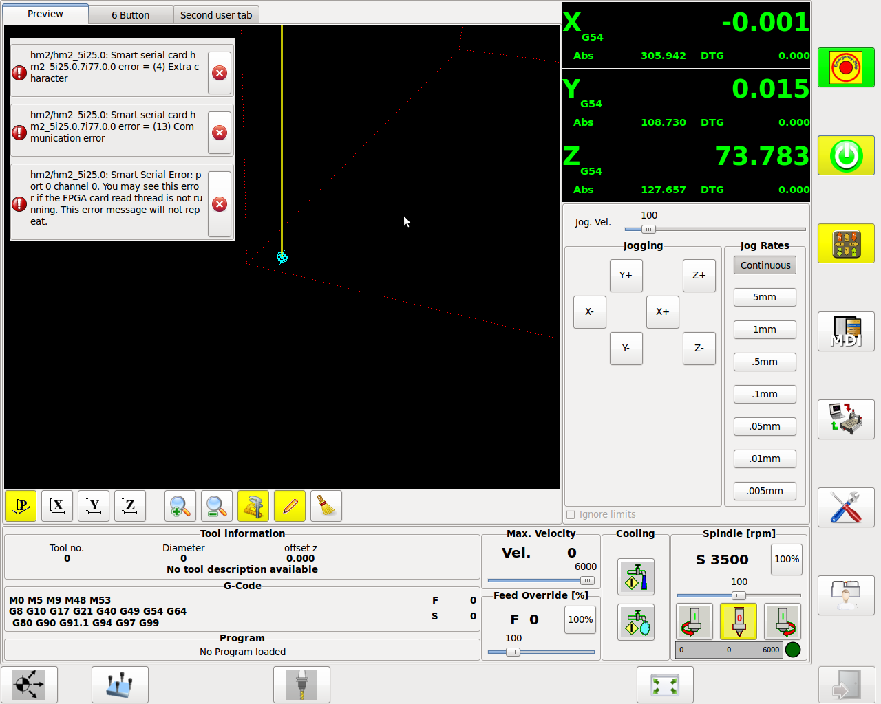

26 Sep 2014 01:30 #51575 by Tom_R2E3
Replied by Tom_R2E3 on topic Unexpected real time delay on servo system
as an aside, I also get this error whenever switching on my coolant (please see attached image)
I have a push button linked to a field input on the 7i77, then a field out drives a 24v relay which operates my coolant pump. The functionality always works, it just sometimes gives me that error...
26 Sep 2014 02:55 #51576 by ArcEye
Replied by ArcEye on topic Unexpected real time delay on servo system
I think this error is caused by the serial link going down.
One thing that will certainly cause it, is an interruption in the field supply to the daughter board.
PCW will be able to say for sure.
Just makes me think about wiring and the source of the supply voltage.
regards
26 Sep 2014 04:18 #51578 by cncbasher
Replied by cncbasher on topic Unexpected real time delay on servo system
Yes the error can be caused by the loss of momentary power ,
this could be either the power supply is not able to supply demand to pull the relay etc , and theirs a surge on the field power
so check out your supplys , or perhaps the wiring is too thin for the current used etc
