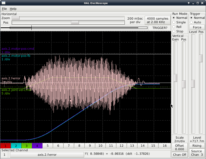

My mother board bit the dust so I upgraded to an ASUS J1800I which required Wheezy and 2.6
I updated all the 7i64 pins and fired up the machine knowing I had to retune.
The axis were much louder and on the edge of being unstable during jog and homing.
I loaded the tuning repeat program and started to tune. To get the machine stable the P values are 1/4 of what they used to be and the both the motor and plots are very noisy.
I tried setting pins pid.N.error-previous-target back to false like in 2.5 and this impacts the FF1 but everything is still noisy.
Is there something that I'm missing?

files attached

The 7I48 filters are hardware so other than component failure should stay the same
I would not expect _any_ tuning change going from 2.5 to 2.6 other that needing to set pid.N.error-previous-target. false
maybe something else in your system changed
Note that on the axis you showed in the HALScope plot you have no D term (while the other axis have significant D term)
net motor.02.vel-fb hm2_5i23.0.encoder.02.velocity => pid.2.feedback-deriv
will have no effect unless you have some D term
Last edit: 19 Dec 2014 03:58 by PCW.

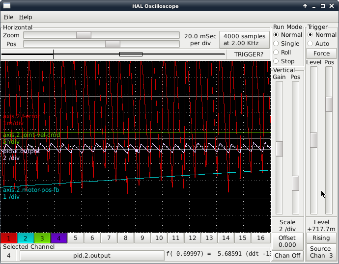

19 Dec 2014 04:22 #54147
by clkeck1
Replied by clkeck1 on topic upgraded from 2.5 to 2.6 tuning issues
I tried D from .001 up to 1 and it doesn't change the amplitude of the noise I started with the Z axis because it was acting the worst.
I even tried switching the 7i48 over to cable power to isolate it from the machine power supply and put it on the computer power supply.
The plot shows a constant 300IPM move and as expected when PID output (pink) is high F-error (red) is also high. and when one is low so is the other.
What can be causing this?
