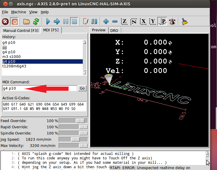

I'm wondering if is possible to assign a keyboard keystroke as an HAL pin? My objective is to use 3 keys, witch one will call a subroutine.
the first will open a log file, the second to log the X and Y coordinates, and finally the third to close the log file. If I can use this with the present keyboard keys it will be great.

02 Oct 2015 00:10 #63352
by jtc
Replied by jtc on topic keystroke as a hal pin?
with thios post help :
www.linuxcnc.org/index.php/english/forum...gging?start=10#62208
and seeing the axis.py file
I add to my ini file configuration on the display area:
and the keystroke.py contains this code:
so, at this point, if I have some mdi command on the "buffer"
but I cant find any "commands.send_mdi" that have a string as an argument. or a way to write on the "buffer".
João
[DISPLAY]
USER_COMMAND_FILE = keystroke.pyand the keystroke.py contains this code:
root_window.bind("<KeyPress-j>",commands.send_mdi )so, at this point, if I have some mdi command on the "buffer"
João

06 Oct 2015 21:14 - 06 Oct 2015 21:18 #63514
by jtc
I already had seen this link, I tryed to use the following code on my .py file:
hopping to see to be executed on simulation, but without success.
regarding the original idea of the topic, using a keystroke as an hal pin, in axis.py file, next to line 3226 I find this:
that create the axisui pins, but if I changed the name of one of these pins, when start linuxcnc I can´t see any difference in axisui pin names.
So, I'm missing something...
João
Does this help?
www.linuxcnc.org/docs/html/config/python-interface.html
import linuxcnc
s = linuxcnc.stat()
c = linuxcnc.command()
def ok_for_mdi():
s.poll()
return not s.estop and s.enabled and s.homed and (s.interp_state == linuxcnc.INTERP_IDLE)
if ok_for_mdi():
c.mode(linuxcnc.MODE_MDI)
c.wait_complete() # wait until mode switch executed
c.mdi("G0 X10 Y20 Z30")hopping to see to be executed on simulation, but without success.
if hal_present == 1 :
comp = hal.component("axisui")
comp.newpin("jog.x", hal.HAL_BIT, hal.HAL_OUT)
comp.newpin("jog.y", hal.HAL_BIT, hal.HAL_OUT)
comp.newpin("jog.z", hal.HAL_BIT, hal.HAL_OUT)
comp.newpin("jog.a", hal.HAL_BIT, hal.HAL_OUT)
comp.newpin("jog.b", hal.HAL_BIT, hal.HAL_OUT)
comp.newpin("jog.c", hal.HAL_BIT, hal.HAL_OUT)
comp.newpin("jog.u", hal.HAL_BIT, hal.HAL_OUT)
comp.newpin("jog.v", hal.HAL_BIT, hal.HAL_OUT)
comp.newpin("jog.w", hal.HAL_BIT, hal.HAL_OUT)
comp.newpin("jog.increment", hal.HAL_FLOAT, hal.HAL_OUT)
comp.newpin("notifications-clear",hal.HAL_BIT,hal.HAL_IN)
comp.newpin("notifications-clear-info",hal.HAL_BIT,hal.HAL_IN)
comp.newpin("notifications-clear-error",hal.HAL_BIT,hal.HAL_IN)
comp.newpin("resume-inhibit",hal.HAL_BIT,hal.HAL_IN)that create the axisui pins, but if I changed the name of one of these pins, when start linuxcnc I can´t see any difference in axisui pin names.
João

07 Oct 2015 00:33 #63522
That ought to work, it normally does.
Replied by andypugh on topic keystroke as a hal pin?
if ok_for_mdi():
c.mdi("G0 X10 Y20 Z30")[/code]
