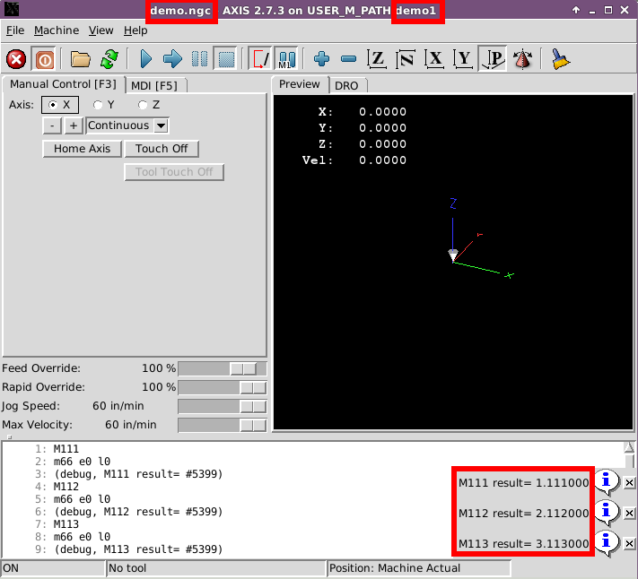

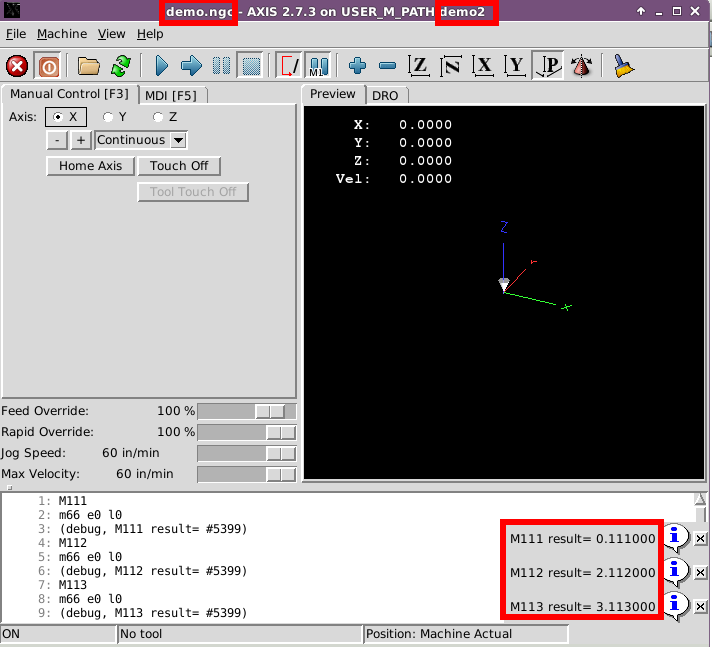

27 Feb 2016 00:40 - 27 Feb 2016 00:42 #70693
by dgarrett
Replied by dgarrett on topic Difference between USER_M_PATH and nc_files path
The attached demo illustrates USER_M_PATH usage.
The config directory is named 'demo'.
The config directory also contains subdirectories named
d1,d2,d3, and nc_files.
The two included ini files (demo1.ini, demo2.ini) use a minimal
axis gui simulation configuration to access a simple gcode starup
file named demo.ngc
The demo1.ini config specifies:
The demo2.ini config removes (comments out) the PROGRAM_PREFIX:
Each subdirectory contains simple M1NN files to
identify their usage by encoding the value of the
motion.analog-in-00 pin which is read in the gcode file
named demo.ngc using the m66 cmd which populates the
variable #5399
To try:
file named demo.ngc
[DISPLAY]
PROGRAM_PREFIX = ./d1
[RS274NGC]
USER_M_PATH= ./d2:./d3:./nc_files
...The demo2.ini config removes (comments out) the PROGRAM_PREFIX:
[DISPLAY]
#PROGRAM_PREFIX=./d1
[RS274NGC]
...Each subdirectory contains simple M1NN files to
variable #5399
$ cat d1/M111
#!/bin/bash
halcmd setp motion.analog-in-00 1.111 # 1.xxx for dir d1
$ cat d2/M111
#!/bin/bash
halcmd setp motion.analog-in-00 2.111 # 2.xxx for dir d2
# ... etc.
$ cat nc_files/M111
#!/bin/bash
halcmd setp motion.analog-in-00 0.111 # 0.xxx for dir nc_files
[code]
Note that there are several files with the same name to
illustrate how the search works:
[code]
├── d1
│ └── M111
├── d2
│ ├── M111
│ └── M112
├── d3
│ ├── M111
│ ├── M112
│ └── M113
├── nc_files
└── M111To try:
mkdir /tmp/demo # make a test directory
cd /tmp/demo # work in that directory
wget https://forum.linuxcnc.org/media/kunena/attachments/512/mpath_demo.zip
unzip mpath_demo.zip # extract archive
linuxcnc demo1.ini & # try demo1
# F1 (clear Estop)
# F2 (machine On)
# R (run included program named demo.ngc)
# menu/Exit
linuxcnc demo2.ini & # repeat for demo2
Last edit: 27 Feb 2016 00:42 by dgarrett.
