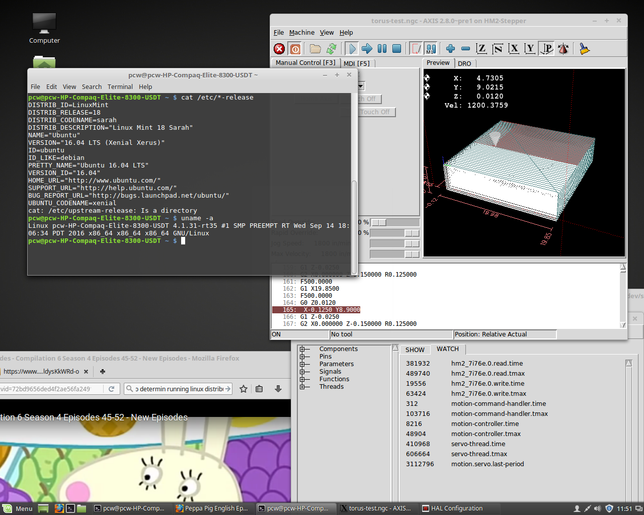

02 Dec 2016 20:04 - 02 Dec 2016 21:15 #83596
Replied by PCW on topic What dists and versions really works?
Last edit: 02 Dec 2016 21:15 by PCW.

- Moronicsmurf
- Posts: 53
02 Dec 2016 22:21 #83598
by Moronicsmurf
Replied by Moronicsmurf on topic What dists and versions really works?
I'm guessing your are compiling from source then, and running in uspace. Is that 4.1.13 preempt kernel included in the 18? i tried to follow some instructions for 17.3 but ran into dependency issue around GCC-4.6 every way i tried to get it to work..

- Posts: 18111
- Thank you received: 5330
03 Dec 2016 00:06 - 03 Dec 2016 00:37 #83604
Haven't noticed any major issues with Mint18/cinnamon
its fast and very usable on the machines I have it on: Core Duo, I5, N3150, all with SSD
Only graphic issue I notice is that Axis comes up minimized (some WM issue but not a big deal)
