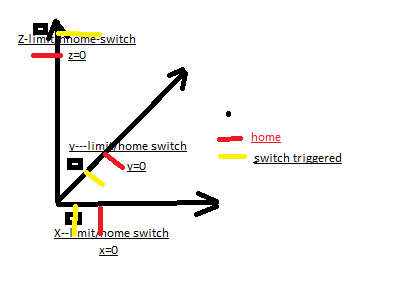

Hi guys,
I'm newbie in linuxcnc and I have just subscribed to the forum,
I ask your help cause i cannot perform homing correctly (the homing procedure appear to be not correct).
Home switches triggered but... instead stopping, axis continue going to the original position START with home_final_vel velocity

Can you start by describing precisely the homing behavior you want to achieve. (and probably a better description of exactly what is happening now.)
For example as you have the X axis now configured, this is what the machine will try to do; first is will search for the home switch in the negative direction at 1mm/sec, then when the home switch changes to true, it will move in the positive direction at 2.5mm/sec until the home switch goes false, at that point that position of the axis is set as 5mm, and finally the machine will move (or try to move until it hits a limit switch) a rapid rate (or what ever you set HOME_FINAL_VEL=) to point 0 (towards your home switch.)
This is obviously not going to be the movement you desire (probably not even physically possible.)
Edit: If you have the axis directions and or the state of home/limits configured backwards can and will throw a wrench in it all. For example if your home limit is a normally closed switch, you need to negate the pin to them by using "hm2_7i76e.0.7i76.0.0.input-00-not" in your hal file.

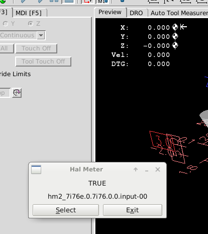

Before you even _try_ to home you should verify that the home switches work and as Todd mentioned have the correct polarity.
You can do this by watching or halmetering:
hm2_7i76e.0.7i76.0.0.input-01
hm2_7i76e.0.7i76.0.0.input-02
As you trip the associated proximity switches
If these signals are true when not tripped (away from home) you need to use the inverted signals

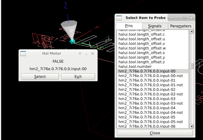

07 Feb 2018 20:37 - 07 Feb 2018 20:37 #105542
Replied by PCW on topic Fail to homing
And before you even worry about the polarity you should check that LinuxCNC "sees" the switches
One way is this: ( in a terminal window when LinuxCNC is running )
halmeter hm2_7i76e.0.7i76.0.0.input-00
and the activate the switch to see if its state changes in halmeter
Last edit: 07 Feb 2018 20:37 by PCW.

08 Feb 2018 15:39 #105579
by Evgi
Replied by Evgi on topic Fail to homing
what should i do now?
new problem
a line is not initialized: RS274NGC_STARTUP_CODE = G17 G21 G40 G43H0 G54 G64P0.5 G80 G90 G94 G97 M5 M9.
I run the test program and saw that the code G64P0.5 does not work, but if you enter in the MDI then everything is fine/
And yet why is there no correct search at home?Always returns to the START point.
