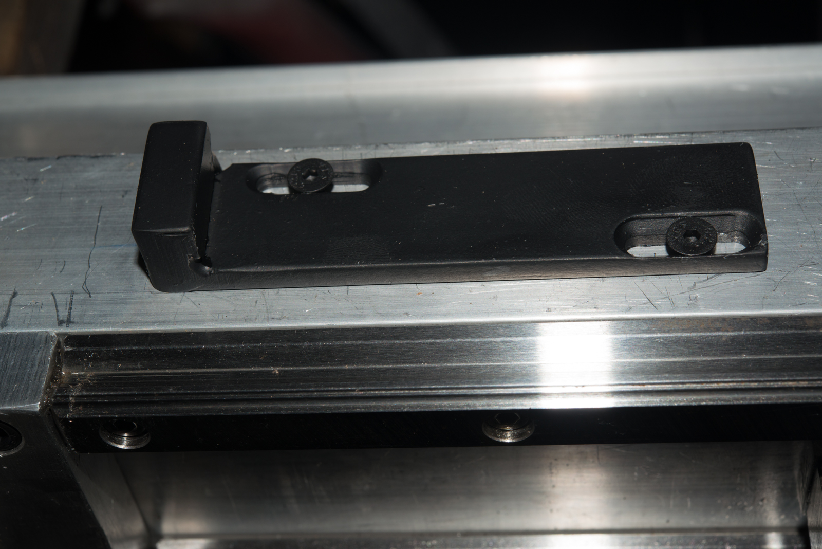

You can place your home switch wherever you like, It just needs to remain activated all the way to one limit switch.
Say you placed the limit switch at the centre of travel and the machine was designed so that the limit switch remained activated from that point to the left side limit switch. When the homing sequence is commenced if the home switch is activated (eg axis is to left of centre), LinuxCNC will see that the home switch is triggered and will move to the right until such time the home switch turns off and then homes to the point of switch activation.
Here is an example of how to set up separate home and limit switches using proximity switches taken from my machine
The home switch is triggered on the right edge of the plate.
The limit switch is triggered by the raised section on the left.
The length of the plate is sufficient to allow the axis to coast to a stop and could be half the length of the axis if thats what you want.

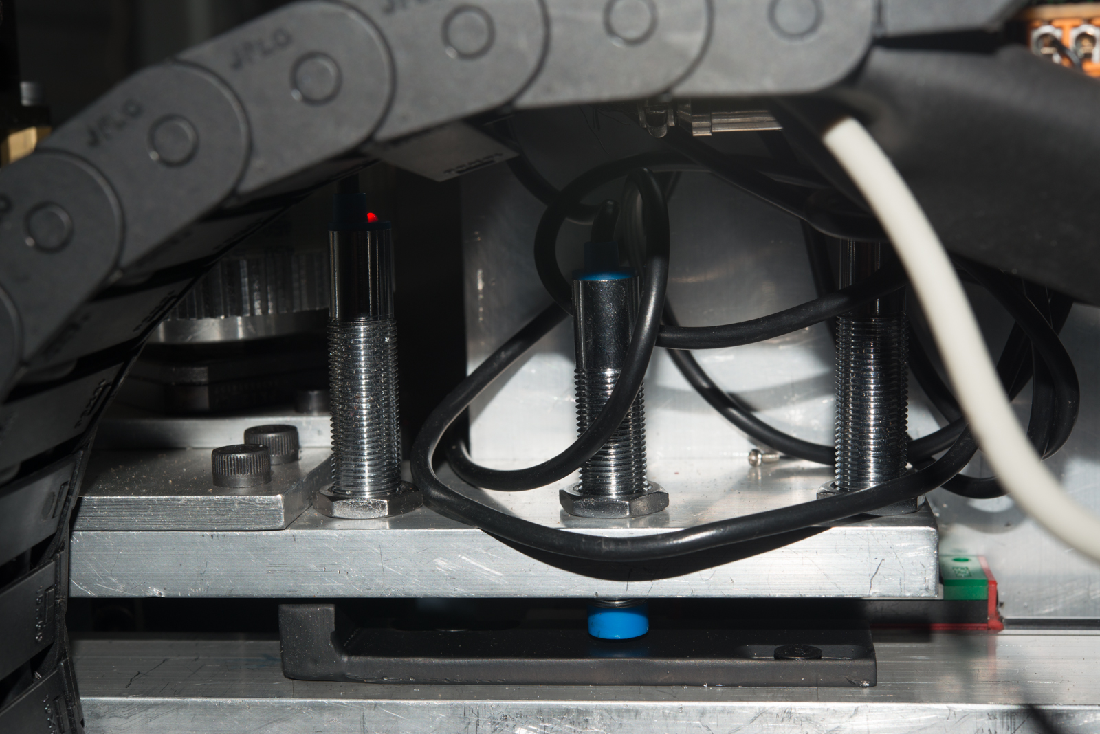

And here are the proximity switches.
The centre sensor is the home sensor and the limit switch sensors are the outside ones.
This is the final home position after a home offset has been used to move as close to the limit as possible to maximise axis travel.
So if the axis was homed from this position, Linuxcnc moves the home sensor off the plate before the homing sequence is commenced.
If you use a shared home/limit switch, you must add a home offset to move the axis away from the tripped position (eg, in my case, the sensor in the second photo needs to be moved to the right until its no longer above the plate that activates it). If you do not do this, you get a limit switch error the moment the homing sequence is completed.
So for this machine, the axis travel would be reduced by 40mm - 50mm if a shared home/limit switch was used due to the distance required to coast to a stop. This coasting distance can be reduced by slowing down the homing velocity, but on a 1200mm long axis, homing would take a loooong time if at the opposite end.
