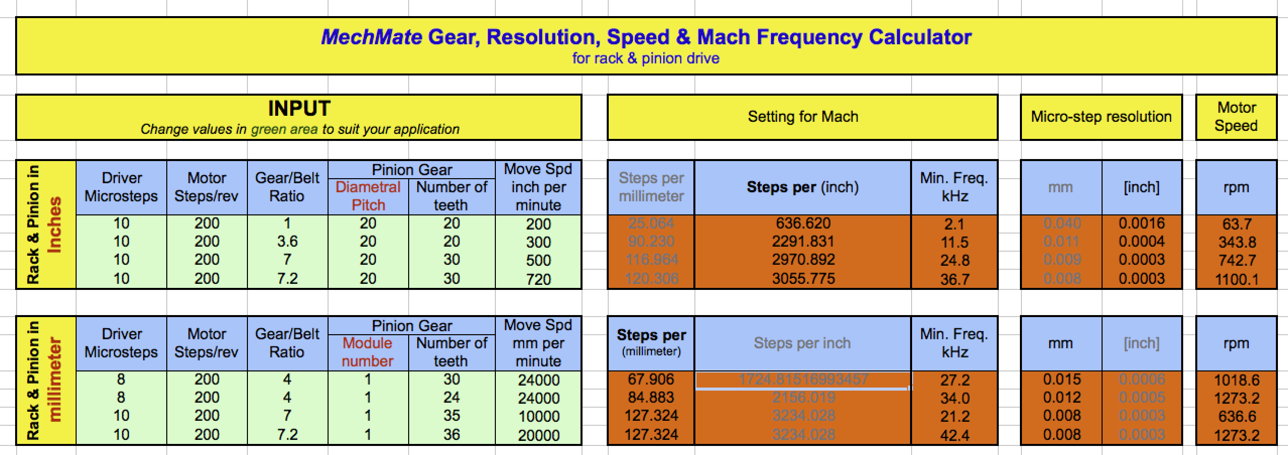

Thanks everyone, it looks like I have opened a rather large can of worms!
I feel my original post was badly worded, I was purely after the information of wether my 14 decimal places made a difference to Linuxcnc. Now I asked that because I use a spreadsheet designed by the original maker of my machine and that spreadsheet was targeted at Mach3. I have no idea (and could care less) if Mach3 can use anything but 3 decimal points in calculations of scale or steps per inch.
Here is a screenshot of the sheet with my 2 scenarios in the metric part of the sheet. The first 1 is default with 3 decimal points in the calc.
this second shot is the same but the value has been expanded to 11 decimal points.
Not wildly different, just accuracy in the calculation.
I know my self built machine is not going to be as accurate as a Haas for example, mine is for wood not metal etc etc. I was just looking for a definitive answer if LCNC could use any more than 3 or even no decimal points at all.
