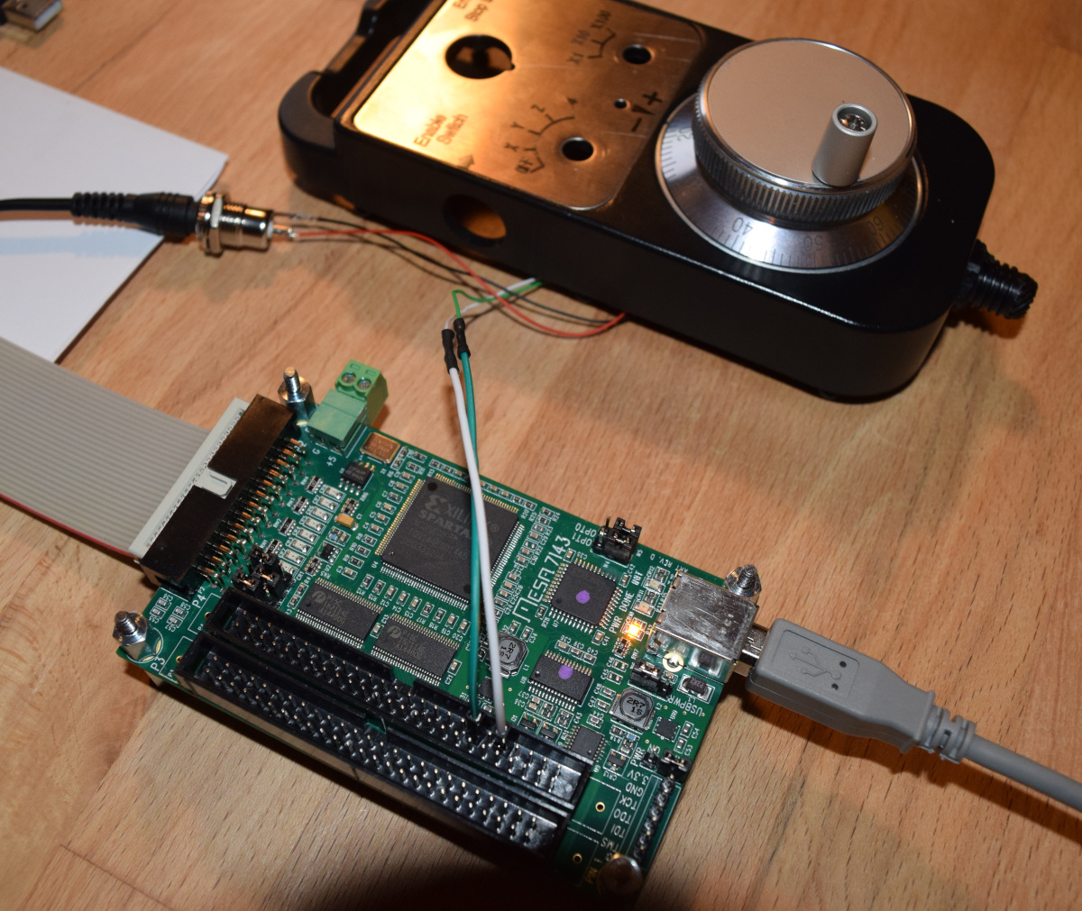

- mane
- Posts: 46
08 Mar 2019 20:52 - 08 Mar 2019 21:26 #128108
by mane
Replied by mane on topic MPG Pedant on 7i43
No, at the moment spindle is in manual mode. Only a motor switch and a small gearbox.
I choose one encoder only for the MPG pedant.
I will take a look with dmesg tomorrow. Thanks so far.
Powered the MPG with 5V and connected A and B form MPG to mesa to these pins.
(P4-05): Encoder #0, pin B (Input)
(P4-07): Encoder #0, pin A (Input)
But i guess thats not all. At the moment MPG has no effect on my system. At the moment its only a configuration with no machine behind.

[ 119.542061] hm2_7i43.0: board at (ioaddr=0x0378, ioaddr_hi=0x0778, epp_wide ON) found[color=orange][/color]Powered the MPG with 5V and connected A and B form MPG to mesa to these pins.

- mane
- Posts: 46
09 Mar 2019 19:30 #128174
by mane
- Posts: 18117
- Thank you received: 5335
09 Mar 2019 20:37 #128178
Replied by PCW on topic MPG Pedant on 7i43
Yes, you have your wires connected to P4 pins 9 and 13
- Posts: 19902
10 Mar 2019 02:47 #128198
Replied by andypugh on topic MPG Pedant on 7i43
A good example of why a picture is a great idea, we would have been chasing this for weeks.
- mane
- Posts: 46
10 Mar 2019 07:53 #128204
by mane
Connecting to the correct pins i see now encoder signals A and B in halscope.
