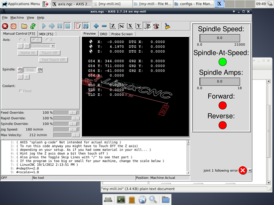

unfortunately, i both updated from 2.7.0 to 2.7.14, and loaded the converted INI file at the same time, so no telling which change caused the conflicts. i highly suspect the errors are from my INI file changes, so we will work with that.
all my config files are on my GitHub, here: github.com/travisfarmer/my-linuxcnc-conf
after homing the machine, (slow but it seems to work), i intended to verify my software limit settings by jogging toward the extremes, and noting where the machine stops. i only got as far as testing axis Y (AXIS_1). the MIN limit worked perfectly, though when i jogged toward the MAX software limit, it moved a bit over 4 inches, and shut down the machine ("Joint follower error" i think).
it is extraordinarily stupid of me that i didn't save the INI as a backup, per-conversion from MM to Inch. i think i can roll back my GitHub, but i am not keen on that, just yet. perhaps some more eyes on the configs will spot something.
Thanks in advance for any help.
~Travis

Traj
default velocity is higher than max velocity
Same on display section, 9 and 90
There are no entries for stepgen_max_velocity but it should work without them.
I see no other issues there.

29 Oct 2019 16:40 #149077
by toplakd
Replied by toplakd on topic curious errors after converting INI from MM to Inch
Take a look at the section of .ini where it says which velocities should be 25% higher.
As you might have them same value as your normal velocity, and that can lead to that error.

29 Oct 2019 16:52 #149078
by travis036
Replied by travis036 on topic curious errors after converting INI from MM to Inch
ok, sounds good. i have set the max velocities to 25% higher. i will test them tomorrow, as i have not installed lights in the CNC shed yet, and it is now dark out.
thanks for the fast response!
~Travis

30 Oct 2019 10:25 #149180
by travis036
well... same issue, same error.
I changed some values regarding the acceleration, and i got further travel, but very slow acceleration, so i moved them back, and it brought about the error again.
I am starting to wonder if it would be wise to wipe the configurations, and re-run the step config. then i can replace bits from the current configs, a little at a time, just to see where i went wrong. seems like a real PITA, but i don't know what else to do at this point.
~Travis
~Travis

30 Oct 2019 10:53 #149182
by toplakd
I checked your .ini on your github link.
MAX_ACCELERATION = 5.04
STEPGEN_MAXACCEL = 4.56 <= this should be 25% higher than one above

30 Oct 2019 11:44 #149188
by travis036
same error and issue...
really getting frustrating.
~Travis

30 Oct 2019 11:47 #149189
by toplakd
Than create new similar config with stepconf.
And look what is different.
