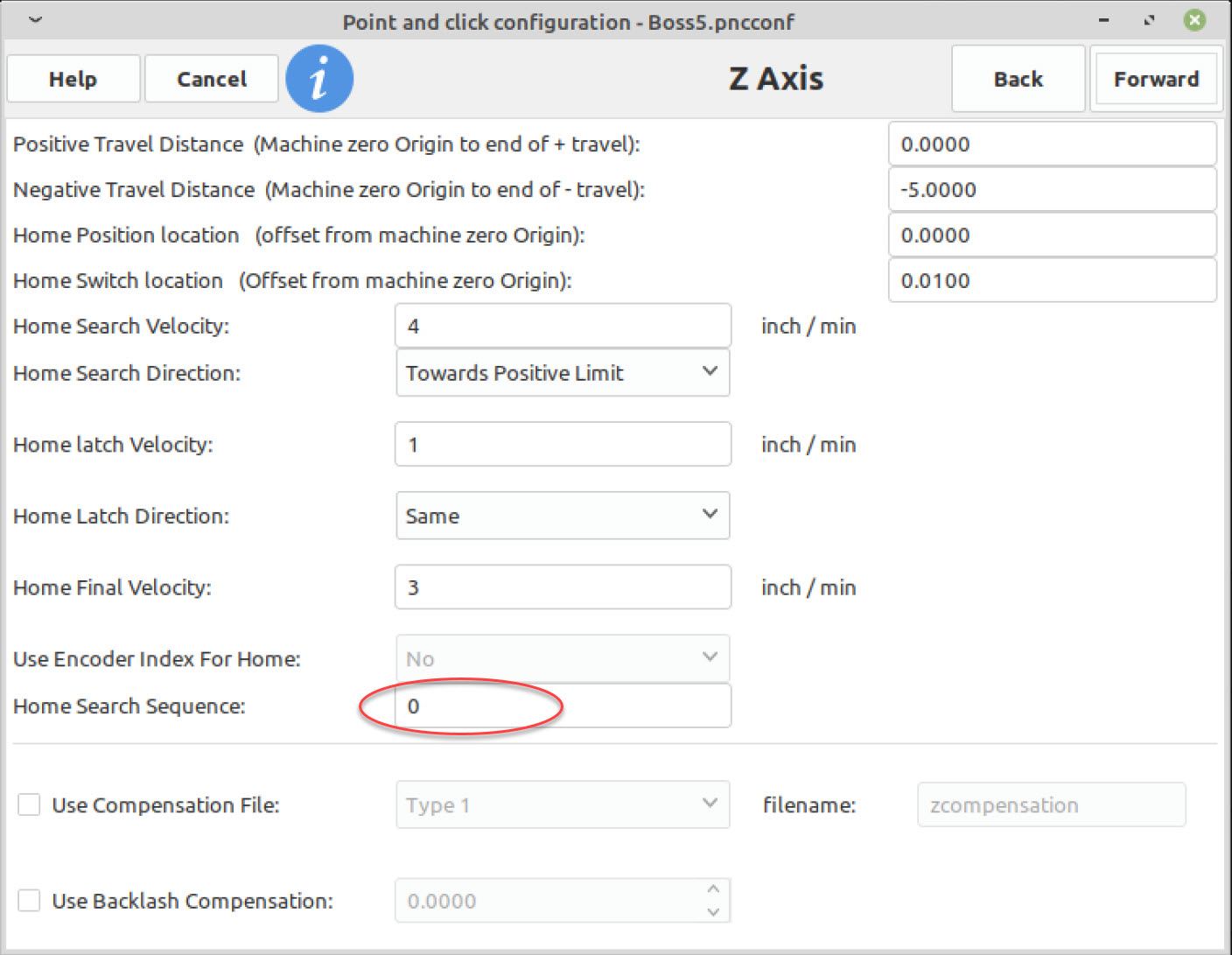

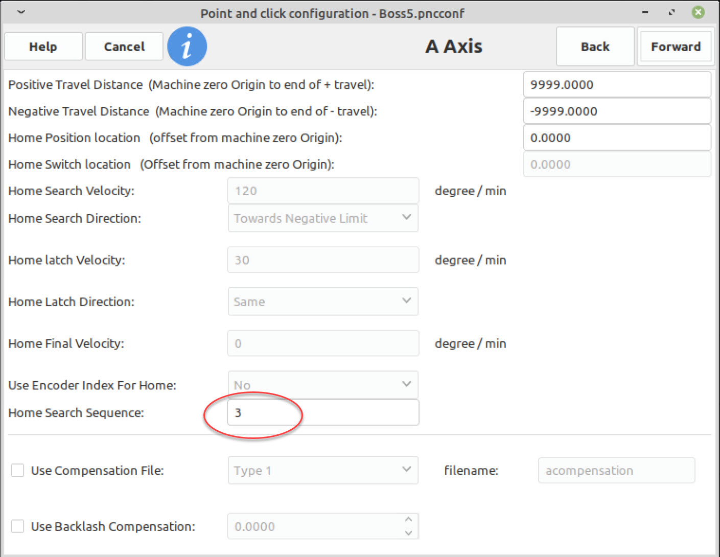

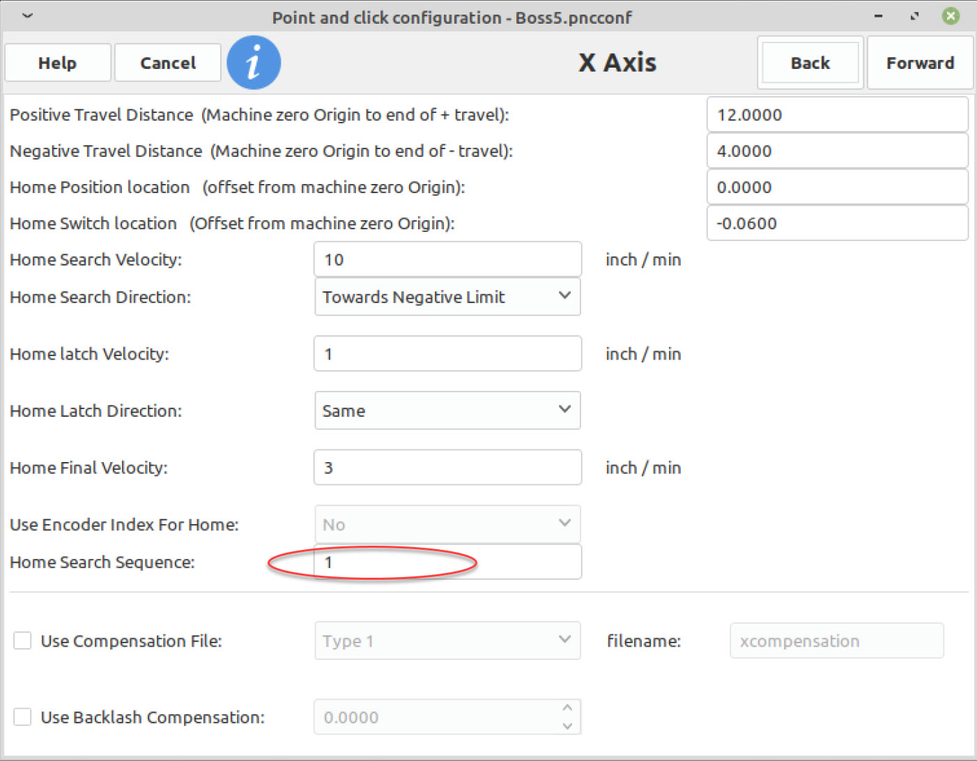

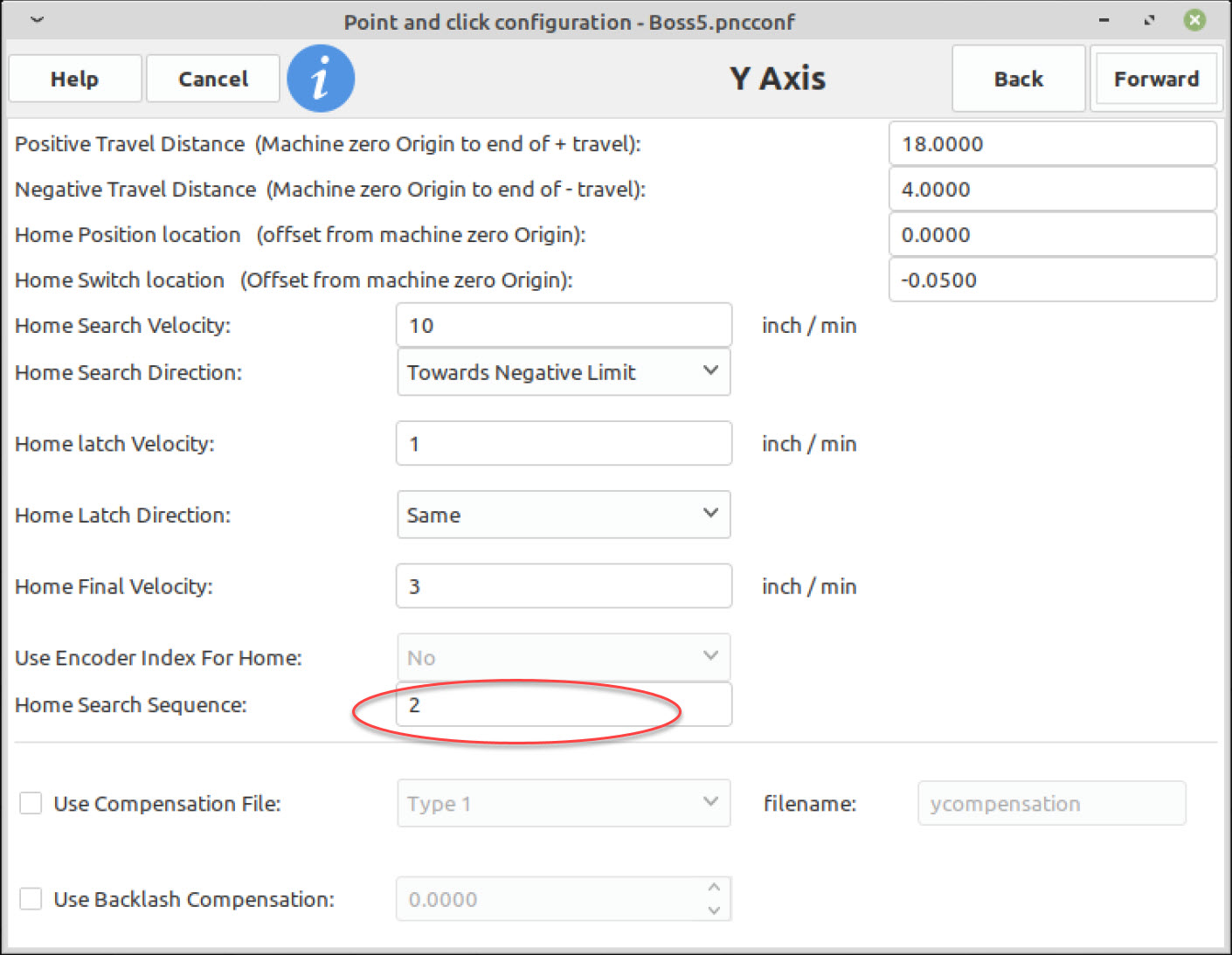

From reading other posts I believe this is an error in my homing configuration so this button in not displayed. I suspect this issue relates to my 4th axis. This machine is a Bridgeport knee mill with a rotary 4th axis (A) which spends most of it's life on the floor next to the machine unplugged. I have my XYZ where I can home them individually. Z is Home search sequence 0, X is 1, Y is 2, A is 3. When I home all I want X,Y,& Z to seek to home and A to just Home where it is. Am I on track or totally off base?
Thanks!

Perhaps there is an error in the pncconf wizard? Or more likely I've done something wrong. I'll certianly go back and try editing my ini file directly , but shoulden't the screen shots below have worked? Thanks

05 Oct 2020 06:14 #184931 by cmorley
Replied by cmorley on topic No Home All button in Axis
i believe you have an A axis with no homing switches. It's why pncconf didn't set the home sequence. I have modified pncconf to ignore the A axis home switch requirement.
joints are the motors that are required to make an axis move.
Some axis require more then one motor (joint)
The following user(s) said Thank You: Aciera, BeagleBrainz
