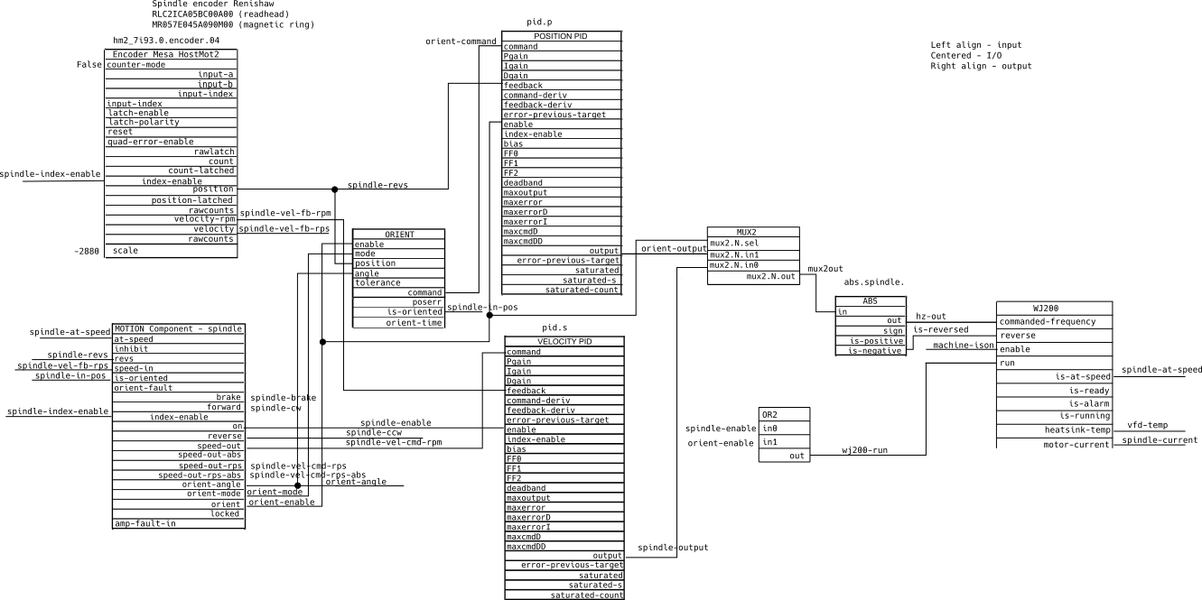

- lrak
- Posts: 114
- Thank you received: 22
27 Feb 2023 02:44 - 27 Feb 2023 05:51 #265471
by lrak
Replied by lrak on topic Index pulses
Not able to attach svg file - so here is a png
Last edit: 27 Feb 2023 05:51 by lrak. Reason: updated png
- Posts: 18078
- Thank you received: 5316
27 Feb 2023 03:03 #265475
Replied by PCW on topic Index pulses
g33 will hang if spindle-at-speed is not true
or the spindle encoder position scaling is backwards

27 Feb 2023 08:01 #265487
by lrak
I was missing spindle.0.speed-in
Never got M19 to work??
I don't see the signal index-enable happen with M19? I do see it with G33.1
Seems like index-enable has to happen for M19 to work. I think the signal would originate from the motion's spindle end - but isn't happening.
LinuxCNC ver 2.8.2
LinuxCNC ver 2.8.2

- lrak
- Posts: 114
27 Feb 2023 22:13 #265522
by lrak
I have it all connected (see the png above). I've done what you are talking about - it wants to unwind all the turns from after the spindle homing..
Doing a g33.1 should home the spindle.
I would say that m19 is broken as is - it should have a requirement to home and some way to ignore the full turns (what would work would be to reset position with a homing event.).
I've done more than a few searches - never saw confirmation where someone had it working? If I'm wrong - please post here.
