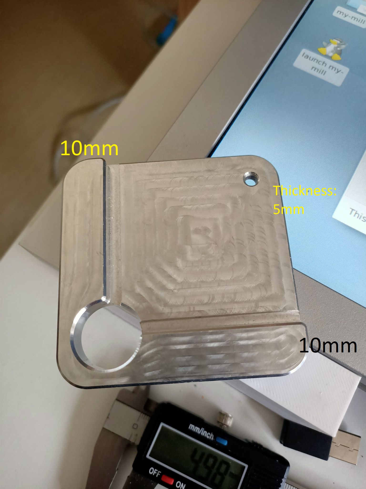

Hi there,
I've got a touch plate I previously used with GRBL and I'd like to use it with the Probe Screen/LinuxCNC.
I can touch off corner edges no worries, as well as the Z height, however if I want to use this touch plate, I'll have to manually adjust the XYZ and rehome.
This is no issue of course, but just wondering if there was a way to build it directly into the code/variables itself.
Thanks!

Maybe
this
can help you. I am currently investigating how to use it with such a touch plate. However, I still have to find out how to tune the different parameters taking into account the dimensions of the touch plate. I will report as soon as I know. Finally, I am looking to reproduce a behavior similar to Estlcam edge finding as you can see
here
