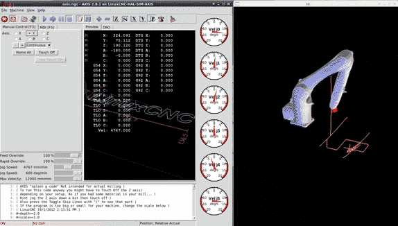

Dear linuxcnc-community
First of all a big thank you all to this great community: I‘m successfully operating my homebrew 4ax router with linuxcnc since 8 years now and most of my issues and questions could be solved and I found a lot of hints for experiments like implementing EtherCat-Amps with the help of this forum
→ So thank you very much
Right now, I’m running V2.8.1 and since I operate my mill on trivkins , my latest project is to experiment with the kinematics implementation with the aim of upgrading my configuration to 4ax-kinematics (either with modded linear-genserkins or a close solution algebraic transformation).
Therefore, I set up a simulation-configuration with genserkins and parameterized a Kuka Agilus KR10, because I have this one already running in Matlab including the dh-parameters and know the results for the forward and inverse transformation, and got this to a working state in linuxcnc including the visualization with vismach, except one thing:
In the ini-file of the configuration, I parameterized among other things the max_velocity for each axis and each joint. The parameters seem to be accepted correctly since linuxcnc starts without error and:
My expectation in this case was, that the [JOINT_N].MAX_VELOCITY would never be exceeded. Instead, the TCP/axis-velocity should be slowed down so that the [JOINT_N].MAX_VELOCITY gets not exceeded.
I also encountered this behavior for the example-configurations “sim-xyzbc-trt”, “sim-xyzac-trt” and the “ldelta”…
So my question is now: is my expectation wrong, and this behavior is as it should or am I missing something in my configuration?
Attached is the gif that visualizes the overrun of the JOINT.MAX_VELOCITY limits, the ini-file of my configuration and the hal-file with the genserkins-parametrization
If more files are helpful, please let me know.
Thanks in advance for your hints and sorry for the long post. Just wanted to make my problem clear
- when jogging joint_0 in joint-mode, the actual velocity is [JOINT_0].MAX_VELOCITY
- when jogging axis_x in world-mode (after homing) the actual velocity is [AXIS_X].MAX_VELOCITY

Replied by tommylight on topic Exceeding JOINT_N.MAX_VELOCITY limits with genserkins kinematics
Something i noticed in your ini file, the velocity settings are all over the place, they should be the same for the corresponding axis/joint.
Try starting that config from the terminal, see if you get warning about velocities not being set correctly.

Hi Tommy,
thanks for your fast reply. I started linuxcnc from terminal, please find the output below.
Unfortunately no warnings, I just get a "note" about the VMAX. I'll check the origin of this value and remove the tooltable error...
Am I missing an option to get more information?
Thank you,
Dominik

Hi again Tommy,
I startet linuxcnc from terminal with debugmode 0x7FFFFFF and can't see anything suspicious regarding the parametrization of the axis/joints, except the entries "waiting for s.joints<0>, s.kinematics_type<0>". is this normal, or is this a kind of sync-problem?

It all seems OK, and it shows at what value the velocities are being set for each joint:
emcAxisSetMaxVelocity(0, 100.0000) returned 0
So that will be 6000mm/m, and that still falls under what you are getting in the video above, so all is good.
I would definitely set the same value for the corresponding joint/axis for velocity and acceleration.

Thats right, all seems ok.
You are right, the 100mm/s for the AXIS are larger than the driven speed, so that limit is not violated.
But the values for the JOINTS maximum velocity (emcJointSetMaxVelocity) are all set properly to 1mm/s and 10mm/s respectively, and these are the limits that get exceeded when driving in world-mode. That the values are somehow set properly, which can be shown when driving in joint-mode: then the joint-limits are respected properly.
regarding your last suggestion, if I understood you correctly:
Why would you set the same values for corresponding axis/joints? This would make the separation in joints and axis kind of redundant, or?
and how would you determine the correct axis/joints-correspondances, since there is (for this six-roational robot-kinematic) never a generally valid correspondace between a cartesian axis and any of the joints?

I followed your suggestion from your previous post: all joints and all axis set on 10mm/s max velocity. But the result is the same: The TCP-Velocity is limited to the values from the axis-sections, and the limits of the max_velocities of the joints seem not to be considered...
I don't want to keep you from your rest, maybe you can share a document or link, that explains this context in particular for linuxcnc because I thought (till now) I'm sort of familiar with this axis/joint topic since I implemented the transformations for several kinematics in matlab that implicate this joint/axis item

one additional note: according to the linuxcnc 2.8.1 documentation the demand on "axis value must be the same as joint value" is only necessary for idendity-kinematics like "trivkins"...
I am confused
Cheers, Do
I am confused

Do the individual joints violate their limits?
Think about this. If you are moving the X & Y axis to traverse at 45 degrees, and both axes are travelling at their max velocity, the actual velocity of the milling cutter will be higher.
