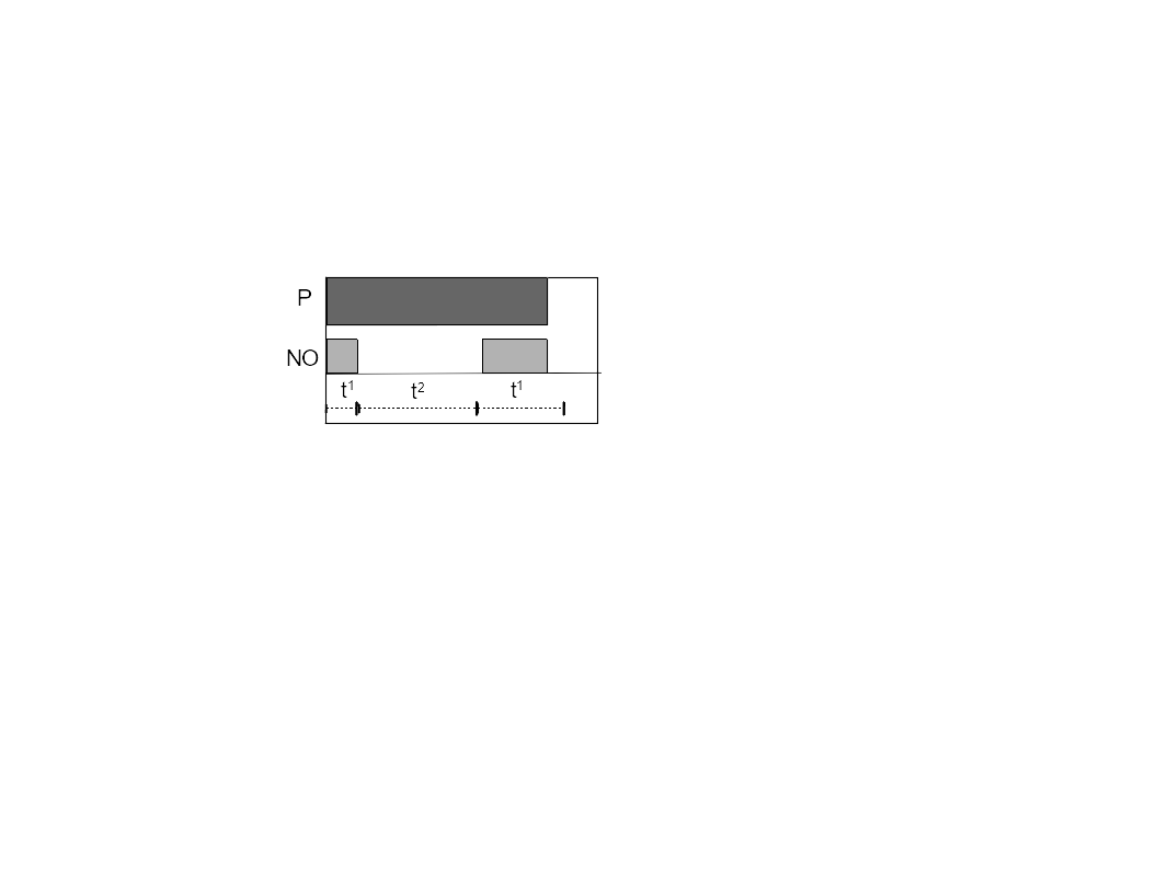

I'd like to set up an air blast (not continuous mist) to pulse on/off. I can use a siggen to do this, but I'd also like to be able to adjust the on and off times independently from a hardware button/knob. I set something up like this on a friends commercial VMC with stand-alone timer relays and it's been a huge hit clearing deep pockets while running unattended.

I've been testing both pwmgen and stepgen all evening and have run in to a couple problems.
I don't really want to go down the VCP rabbit hole - was hoping to get this working with meat-space pots. And I'd like to get a range of about 0.5-1.5 seconds ON time and 1 to 30 seconds OFF time.
Is it possible to use hal pins/signals to adjust hal parameters on the fly? (if so, I can use stepgen)
Is there a way to get the pwm frequency slower than 1hz?
chris@cnc - is that a non-standard hal component you attached? I've never done anything like that - still a newbie at this.
- pwmgen.N.pwm-freq doesn't appear to be able to accept a value lower than 0.5. This results in a cycle frequency of one second. I can set the value and scale to get a blinking output, but I can't seem to get the cycle longer. Every time I use halshow to input 0.1 (for a 10-second cycle) in pwmgen.0.pwm-freq it reverts to 0.5 when I enable the output.
- stepgen also (sort-of) works, but because I can't adjust the steplen and stepspace parameters by connecting a pin (analog value) to them I can't change them on the fly.

I would say that like is not the appropriate adjective for ladder programming, but I'll have a go at it. I spent some time last night reviewing Ladder and watching some of the great Feral Engineer vids on CL.
The basic function I'm after seems pretty simple in concept, but I don't know how to pass/change values from hardware to a Ladder variable. So far, all I can think of is having multiple values in Ladder that I can chose from with a change in input... but not change the values themselves.
If I cant change timer or counter values on the fly, I might was well do it in HAL with a multi-click button and a few pre-set siggens. No on-the-fly adjustment possible - just 3 or 4 different on/off cycles to choose from.
See picture of timer relay scheme. I want t1 and t2 independently adjustable with a pot or encoder.

You can do this with the time delay component:
loadrt timedelay
loadrt not
addf timedelay.0 servo-thread
addf not.0 servo-thread
net timeloop1 timedelay.0.out not.0.in
net timeloop2 timedelay.0.in not.0.out
And then net timedelay.0.on-delay and timedelay.0.off-delay to
pins from encoders etc that set the appropriate times
loadrt timedelay
loadrt not
Last edit: 05 Jan 2022 10:33 by PCW.
