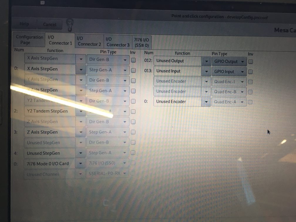

I'm using a mesa 7i76e to drive a machine (XYYZ) with 4 servo's with integrated controllers that accept STEP/DIR.
The motors/drivers/controllers have an Enable input and Alarm and PED (position reached) outputs.
I am planning to use the Alarm outputs to trigger a(n e-)stop if one of the motors goes into error, to force manual re-enable and re-home, if it occurs.
With the HAL tutorial I can probably figure out how to do that.
What I'm trying to figure out at the moment, is how I can elegantly reset the motor when they are in error.
At the moment this is done by pulling the plug that connects the motor power supply to mains....
The Enable input of the motor resets the alarm when I put 5V on it, so that seems promising.

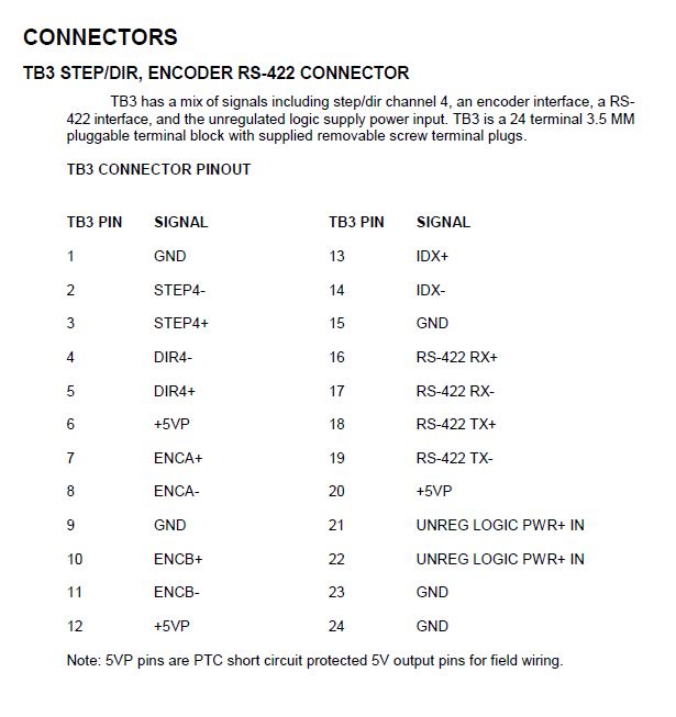

I'm using 4 of the 5 stepper possible stepper drivers, so I should have the 4 5V outputs I need on TB3.
They are numbered 008, 009, 012 and 013. The latter two are also available if I tell the configuration I use 5 stepgens.
My problem is that I can't map them to physical pins using documentation or measurements.
A picture of the configuration page and the pin function according to the documentation is attached.

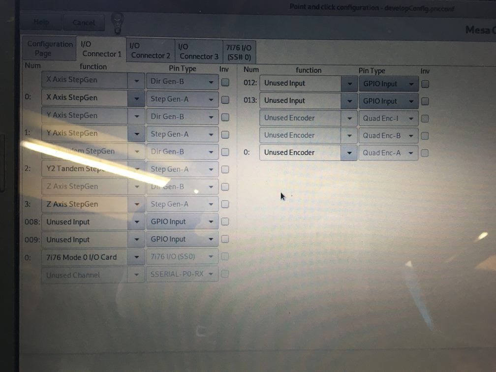

What I have tried so far is:
- Setting the 4 pins to GPIO-OUTPUT
- Define them as DigitalOut0 to 3, and try to toggle them with hal show, but I couldn't get the commands right
- Define them some of them as "Force Pin True", in different combinations, and measure the pins each time to try and derive what is what.
Neither of these approaches have lead to information I can use.
Is there anyone here that knows which physical pins to the ones I can configure in the software?
Or am I on the wrong track for controlling these enables?
Thanks for the help,
P

Ah, the Dir+/- and Step+/- are still linked ofcourse, explains the measurement results I got. And now I get what these Amplifier outputs are for
The fault can indeed sink or source 24V (luckily), so they are already connected to the 24V inputs.
When I have something working I'll share here
Replied by pCNC on topic 7i76e use outputs to toggle motor enable
Stepgen 4 outputs would be GPIO bits
008 (Dir4+ and DIr4-) and 009 (Step4+ and Step4-)

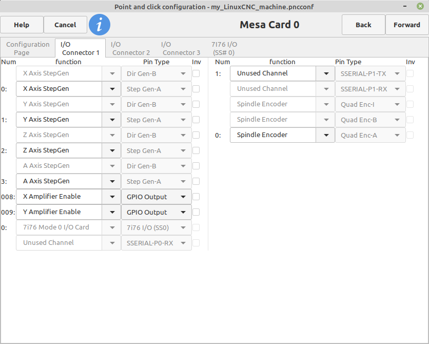

I've set up output 008 on I/O Connector 1 as "Machine Is Enabled" in pncConf, and connected pin 4 of TB3 (DIR4-) to all the motor enables, so they are toggled all together.
The alarm signals are now linked to joint.N.amp-fault-in, using the attached custom_postgui.hal.
Now when one of the motors goes into error, Linuxcnc shows an joint amplifier error and takes away the enable for all joints. When I toggle the enable, everything can be jogged/homed again, without power cycling the drives.
The error is reset almost immediately (at least way before I can go look for a red light) instead of when I toggle the enable again, so either something is slow (my very old laptop for instance) or the driver responds a little differently than I was expecting.
It was confusing for a moment, but it is workable and I can continue working from here
Thanks for the tips!
