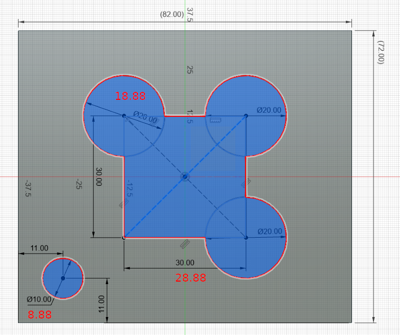

If you take a look on image
This is current values from milled example, RED values are measured via kaliper
Big circles should be 20mm but measured are 18.88mm
Small circle in left corner should be 10mm but is 8.88mm
And square should be 30mm but it is 28.88mm
Not sure if this is step slipping or something else so any suggestion is more then welcome

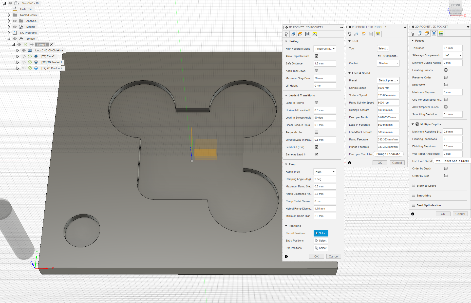

Replied by ddB0515 on topic IHSS60-36-30 motor tuning/issues
So here is image with all important settingsTool I'm using is 5mm flat mill 3 flute (and is brand new, few cuts so wear is out of questions)I didn't see compensation at all in settings and Gcode there is no G41/42 so that is off also

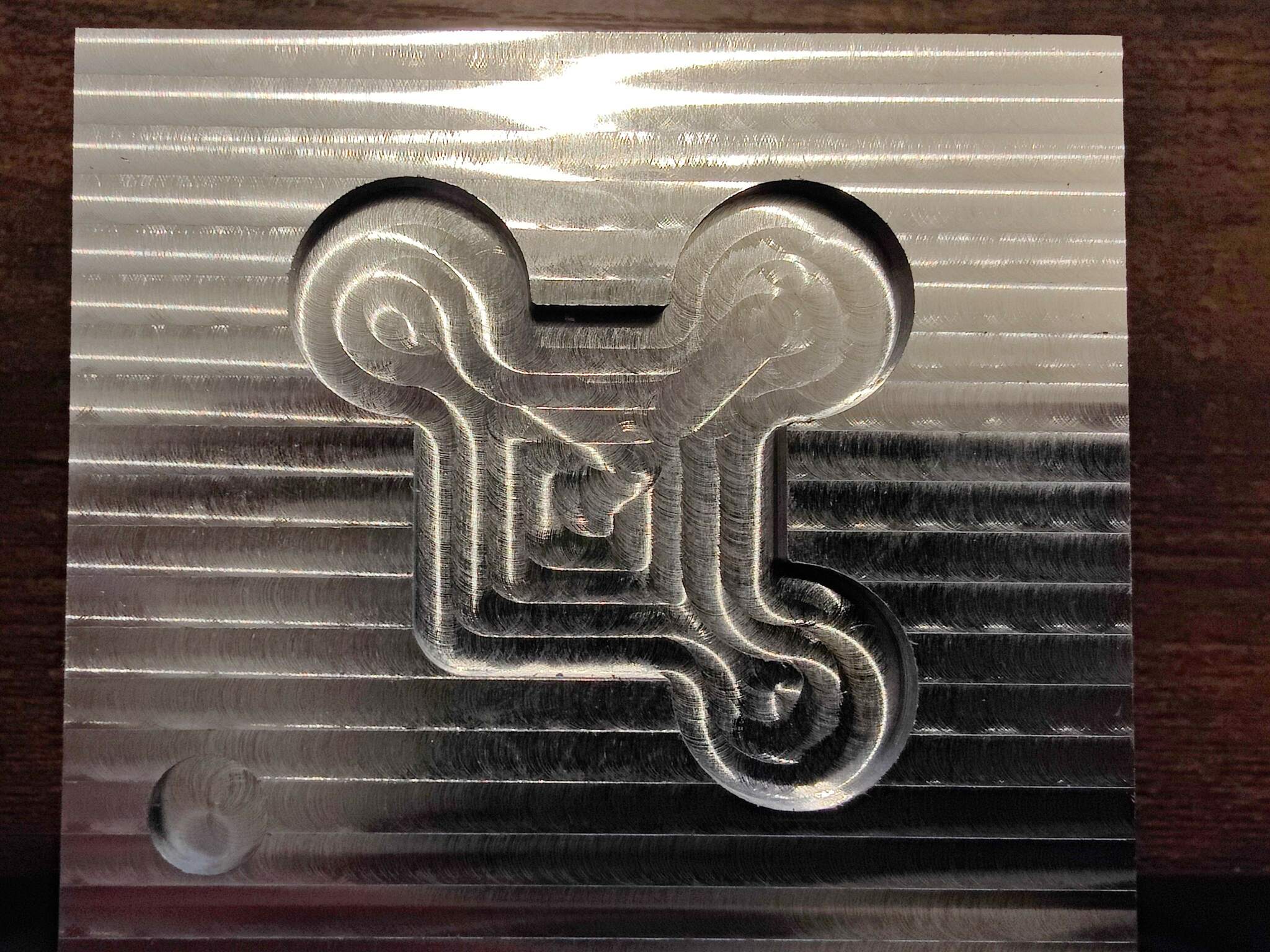

Attached milled part

I know this sounds a bit wild/ like a longshot, but having measured ALL the dimensions at 1.12mm off, I would questions my metrology (if cutter comp, stock to leave and tooldiameter are ruled out).
Any scaling or ballscrew error in an axis should not result in the same absolute error over different distances. You mentioned that the square is off, are both of by 1.12mm? Some questions for the circles: Are they off the same way across both main axis (xy)?
The attached part looks ok, albeit the spindle trim may be off a bit and the cut shows some vibration.
Do you have a known 10mm reference (and be it an endmill) - does that truly measure around 10.00 with the same caliper? It got tricked by an offset caliper before, hence my question...

Share the settings for the 2d contour.
2d pocket is for roughing out the pocket. Finishing to size should be done with a 2d contour toolpath.
Since the difference is the same everywhere I expect a CAM issue.
Oher question, depth of the pocket, what was the difference there?.
