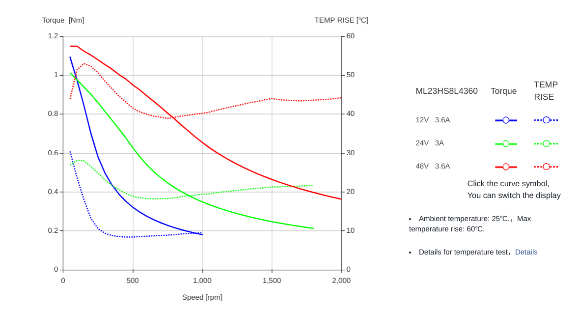

25 Nov 2022 06:37 - 25 Nov 2022 06:39 #257619
Replied by rodw on topic Help! Stepper stalls high speed problem?
Tommy, sorry you are wrong. As you increase the voltage, the torque curve lifts as shown here for a random Moon Industries NEMA 23. Moon are an industrial quality manufacturer up there with Sanyo Denki
In this graph I added a 48 volt plot using Moon's cool customisable graphing module on the product web page. Compare that with the 24 volt plot. You will note torque has increased
www.moonsindustries.com/p/nema-23-standa...0-000004611110011248
But yes, you definitely increase the top end speed as well as torque so you can harness more of that torque with reduction gearing.
The temperature goes up by 44 deg but if you add 35 deg ambient to 44, we end up with 79 deg well below the maximum temp of 130 deg the insulation is rated to.
As a general rule, low inductance motors perform better, but I am yet to be convinced it is the best parameter to design to.
In all of the 100s of drives I benchmarked in our stepper design model that was developed over several months, inductance is definitely not relevant. Its much more important to match the rotational inertia of the system with the motor's rotational inertia. Ideally, you want a 1:1 relationship and it needs to be below 1:1 to prevent the motor from burning up. A low ratio implies the motor is underutilised (eg. too big for the application)
Take for example the amazing NEMA 24 Sanyo Denki 103H7823-5740, it has high inductance of 9.5 but a very high rotor inertia of 840 g/cm^2. I suspect the size of the rotor is the reason why this is only a 2 amp motor as there is not much room for the coil windings! But it outperforms all motors in its class. I've benchmarked it to over 60 m/min and settled on a safe 5m/sec/sec accelleration with a 30mm pinion and 3:1 motor reduction.
What I did learn with all the benchmarking I did is that design of stepper motor motion systems is complex and poorly understood. Its much easier to design servo driven motion systems.

25 Nov 2022 11:50 #257633
Replied by tommylight on topic Help! Stepper stalls high speed problem?
I am not wrong, read my post again and watch the graph, there is no change in torque at low RPM, at all, not even at 12V!
This is getting tedious, several times i said the exact same thing, it does not increase anything at low RPM, it increase everything at higher RPM.

25 Nov 2022 13:08 #257636
by JPL
Replied by JPL on topic Help! Stepper stalls high speed problem?
@tommylight is right
See attached document. This is the older version made by Marius from Geckodrive. The first 3 pages explains this very well.
Basically:
- Torque vs Voltage curves clearly shows that voltage is irrevelant at low speed.
- Higher supply voltage will reduce current thus I2 x R loss. This apply ONLY to higher speed.
- Double 2x voltage will generate 2x torque at higher speed (theorically, although slightly less in real application)
- Inductance is the real enemy, this is why larger motor have a torque/speed curve dropiing much faster than smaller motor.
