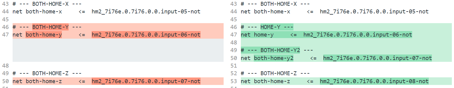

When I originally setup my hal with PNCConf I was planning to only use the limits/home switches on one of the Y joints (Y2 - Joint 2). But now I have added just a Home switch on the other Y joint (Joint 1) so that I can use it to auto square the machine.
You can see that I rearranged the pins to the following to make it easier:
pin 05 = X (Joint 0) - 2 limit switches (Both-Home)
pin 06 = Y (Joint 1) - 1 limit switch (Home)
pin 07 = Y2 (Joint 2) - 2 limit switches (Both-Home)
pin 08 = Z (Joint 3) - 2 limit switches (Both-Home)
My question is in the following image.

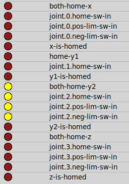

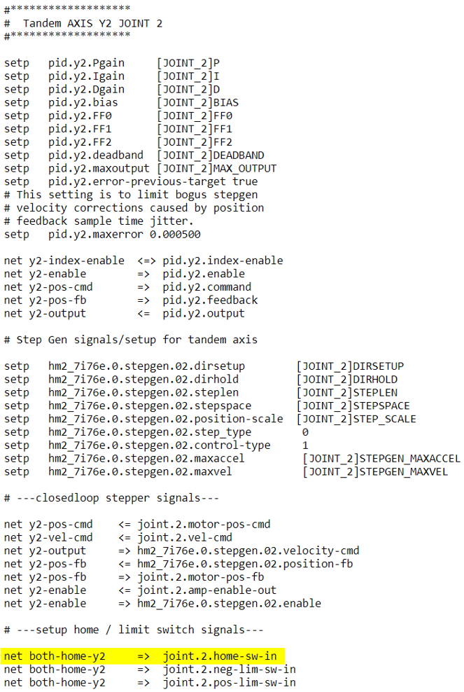

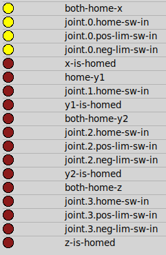

06 Mar 2023 10:49 - 06 Mar 2023 10:54 #265961
by Sray69
I have checked every setting I can think of and it all looks correct to me.
Here you will see the Y2 changes state when I engage the switch.
Here is the X switch engaged. The X joint homed correctly.
In the attached HAL file ( this post ) you will see that "both-home-y2" is connected to pin 07 on the Mesa board. I also verified the wires in the cabinet to be sure.
You can also see that "both-home-y2" is connected to "joint.2.home-sw-in". It is setup exactly the same as the X & Z joints and they both home correctly.
Does anything stand out? Copies of my INI/HAL files are in this post .
I have read through the homing configuration docs for LCNC 2.9 many times and nothing looks incorrect.
