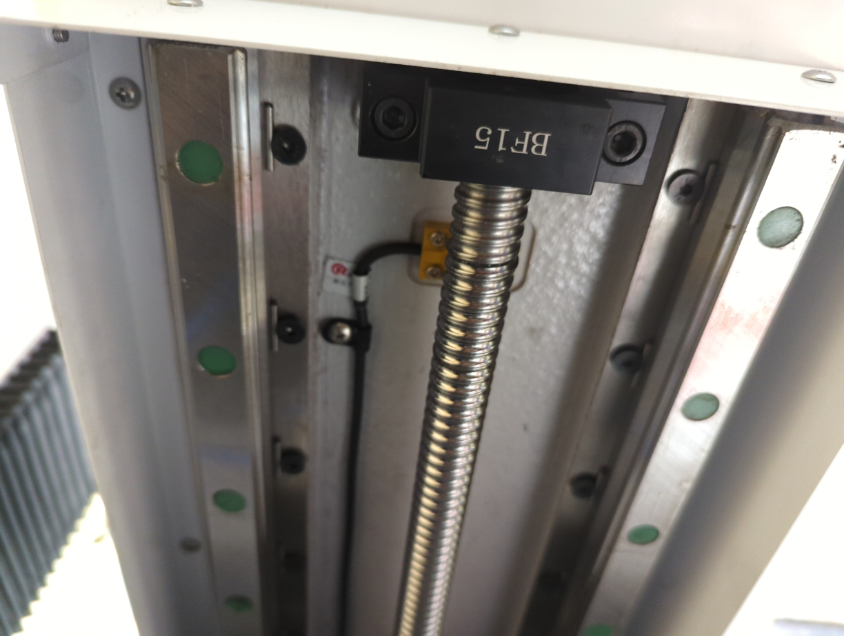

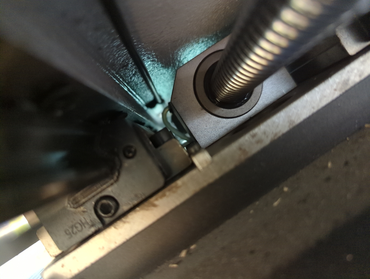

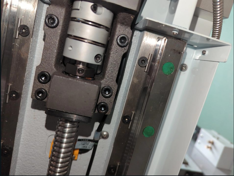

- spacestate1
- Posts: 59
- Thank you received: 10
31 Jan 2024 12:56 - 31 Jan 2024 14:50 #292093
by spacestate1
Replied by spacestate1 on topic Closed loop stepper driver configuration help
Not that it's possible to determine much from these but here's what they look like, on the Y axis.
It's a LyCNC cast Iron 4020 mill, I'm piecing together information as I find it but it's not been easy.
X=380MM,Y=220MM,Z=280MM
thanks again
thanks again
Last edit: 31 Jan 2024 14:50 by spacestate1.
- spumco
- Posts: 2180
- Thank you received: 905
31 Jan 2024 14:57 #292105
by spumco
Replied by spumco on topic Closed loop stepper driver configuration help
Those are significantly nicer components than I was imagining.
The linear rails appear to be properly side-clamped against ground registration surfaces with those screws & dowels, and I believe the rails are name-brand Hiwins. I'd be surprised if there's any serious misalignment-induced binding.
You may actually have AC bearings in the combination ballscrew/motor mount. And your coupler is a zero-backlash type.
I'd remove the motor and proceed with checking screw fixed bearing slop. If there is any you can try snugging up the nut. The machine looks clean but used, so it's possible the bearings are a little worn out. On heavy or fast machines ballscrew fixed bearings take a beating.
After that, the nut, nut adapter, and motor mount screws are now (in my mind) the most likely culprits if there's a mechanical problem. Likely the nut & balls, TBH.
Aliexpress has a few vendors of Taiwanese "C3" double-nut ball-screws around $400-$800 depending on length & dia. I don't know what the machine is, but it looks nice enough under the hood to be worth a set of ground ballscrews if you can scrape up the money.
