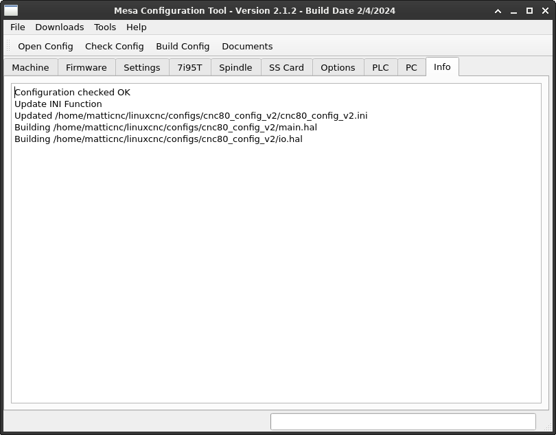

When i press build config, i get the following on the info screen:
Configuration checked OK
Update INI Function
Updated /home/matticnc/linuxcnc/configs/7i95t_xyz/7i95t_xyz.ini
Building /home/matticnc/linuxcnc/configs/7i95t_xyz/main.hal
Building /home/matticnc/linuxcnc/configs/7i95t_xyz/io.hal
It seems it does not complete the building of the files maybe....?
Thanks for the help.

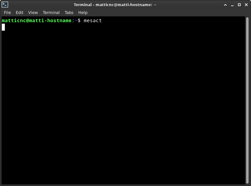

15 Feb 2024 17:36 - 15 Feb 2024 17:38 #293422
by Mattias
Replied by Mattias on topic Configuration problems 7i95t Mesa card with servo drives
When i run from terminal i do not see a lot happening (see screenshots).
Also tried with sudo; it creates configs in /root.. It does also make a tool.hal file which it does not do when running without sudo..
Thanks for you quick answer
