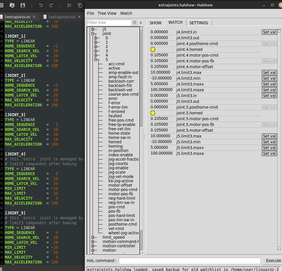

Maybe have a look at the simulation configurations using limit3 in the folder 'configs/sim/axis/extrajoints'

thanks for the answer, I've been looking at the extrajoints configurations, I missed something before and that is that I don't need to use GCode, just update the joint.N.motor-pos-cmd values from the GUI so that the joints move to the new measurement, thanks

1- Not sure what you mean by 'managed in part by the motion controller'. Extrajoints home in the same way as regular axes do, the softlimits are handled by the limit3 component. Extrajoints do not have an axis letter (eg 'X','A', 'B') associated and are not accessable by gcode.
2- you can only declare the joints you need (eg X). If you want two extrajoints you do not declare 'AB' as that is used for regular axes.
As far as I can see there needs to be at least one regular axis defined (eg X) but I think there is also a way to use only HAL without the motion controller but I don't know how that works.

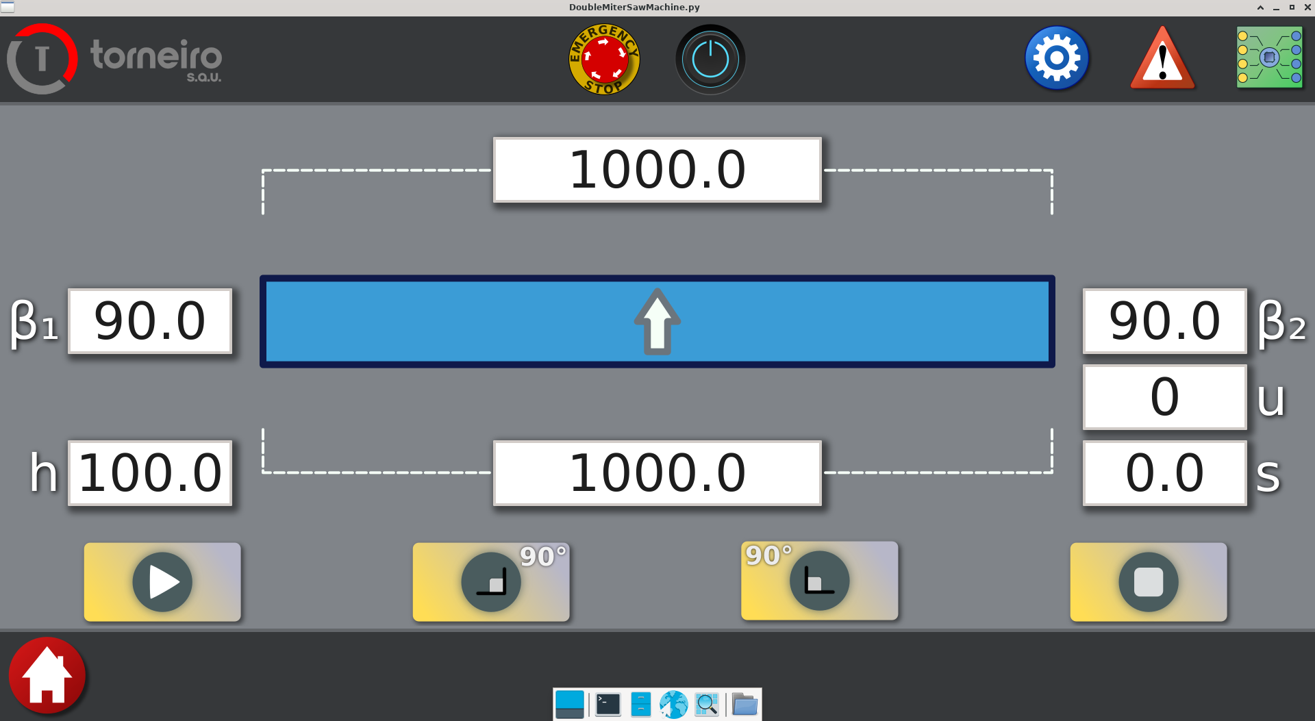

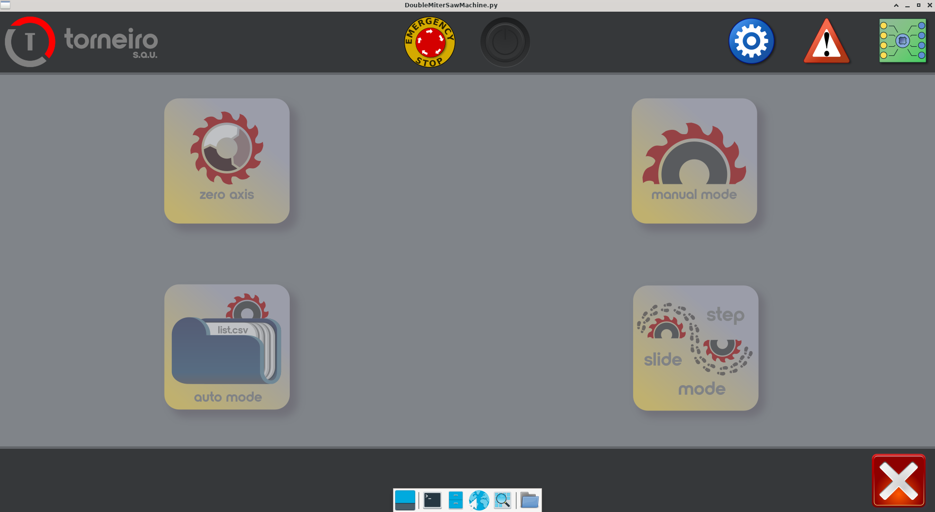

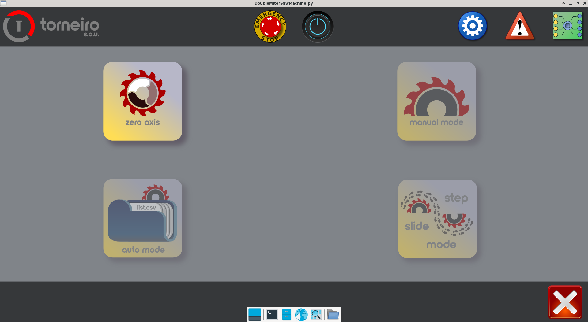

Attached I leave some photos of the user interface, the idea would be to simply establish a measurement in X of the angles on the right and left heads, press play and the machine positions itself.
