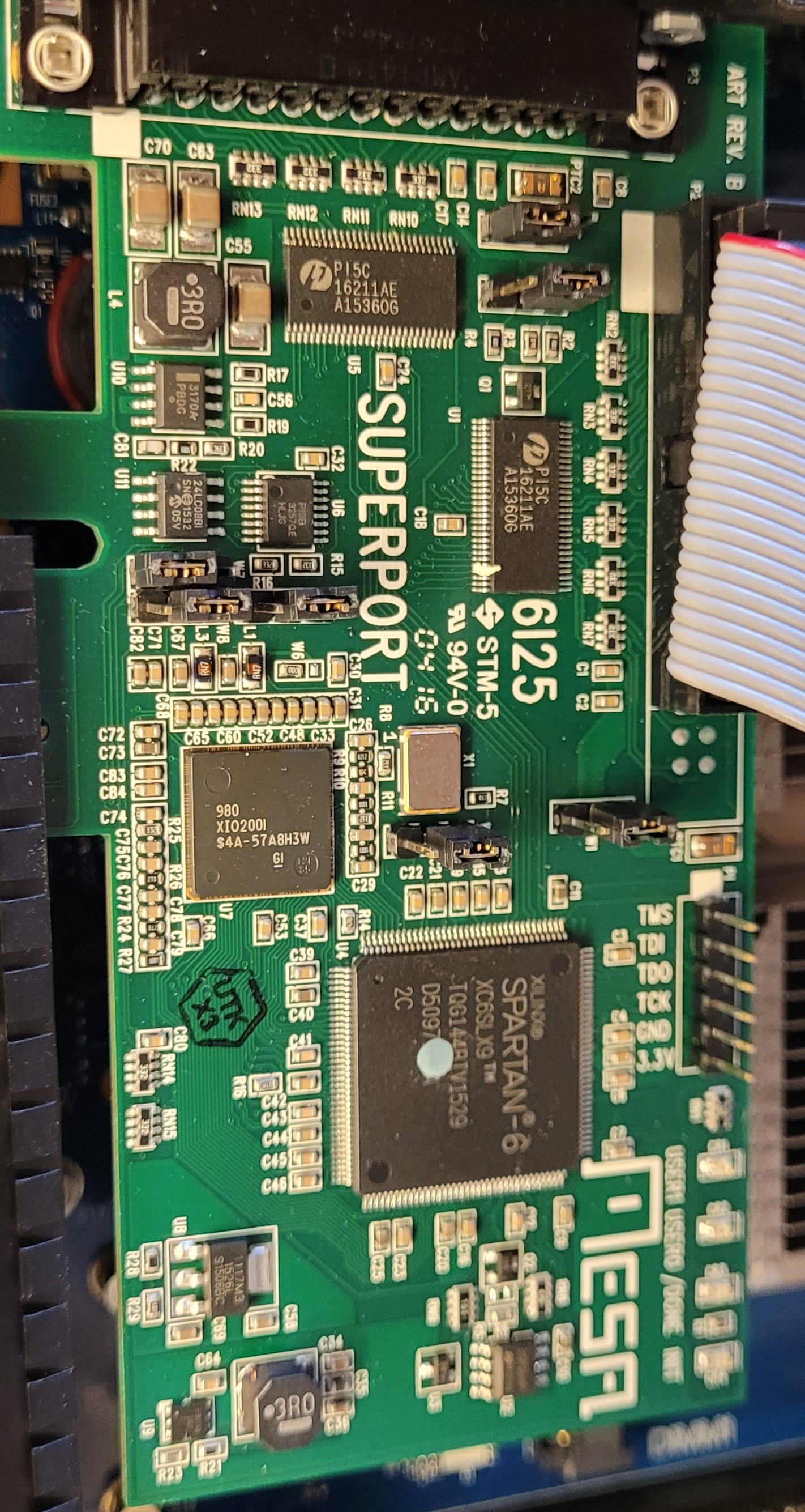

Hi all.
Im new on here.Im struggeling with spindel start up when linuxcnc program startup.
M5 start the spindel.
M3 and M4 turn it off.
Spindel enable seem to have been reversed.Using a 6i25 card with a no name china model bob. I got for free.
So can I make it work or should i buy a different card.
Like a daugther card from mesa.

Do you have any recommondation on mesa daugther card.Considre 7i76there are also D and U card but dont know what that means.
Im more used to lasers/3d printers.So I went in to this blind.

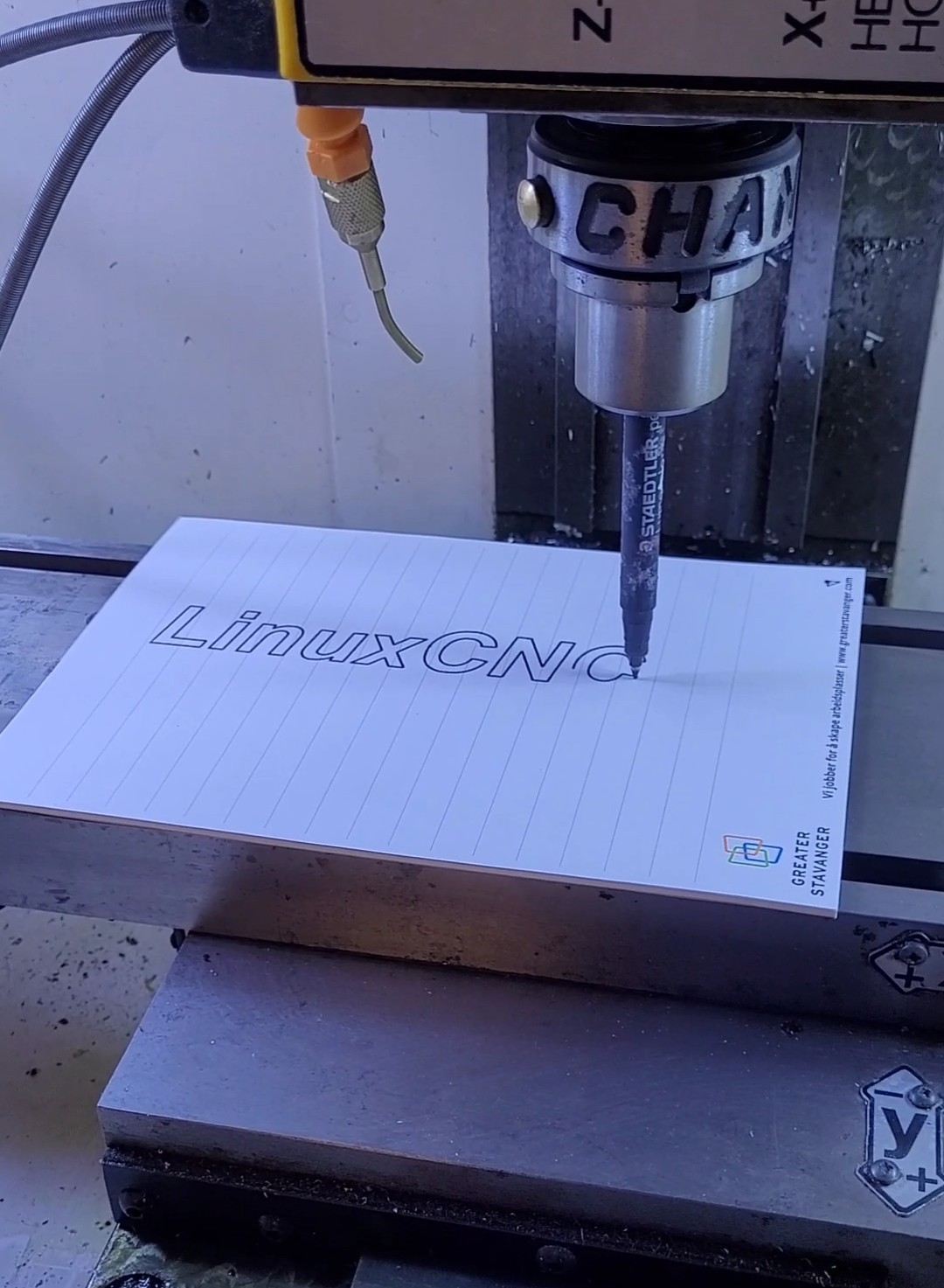

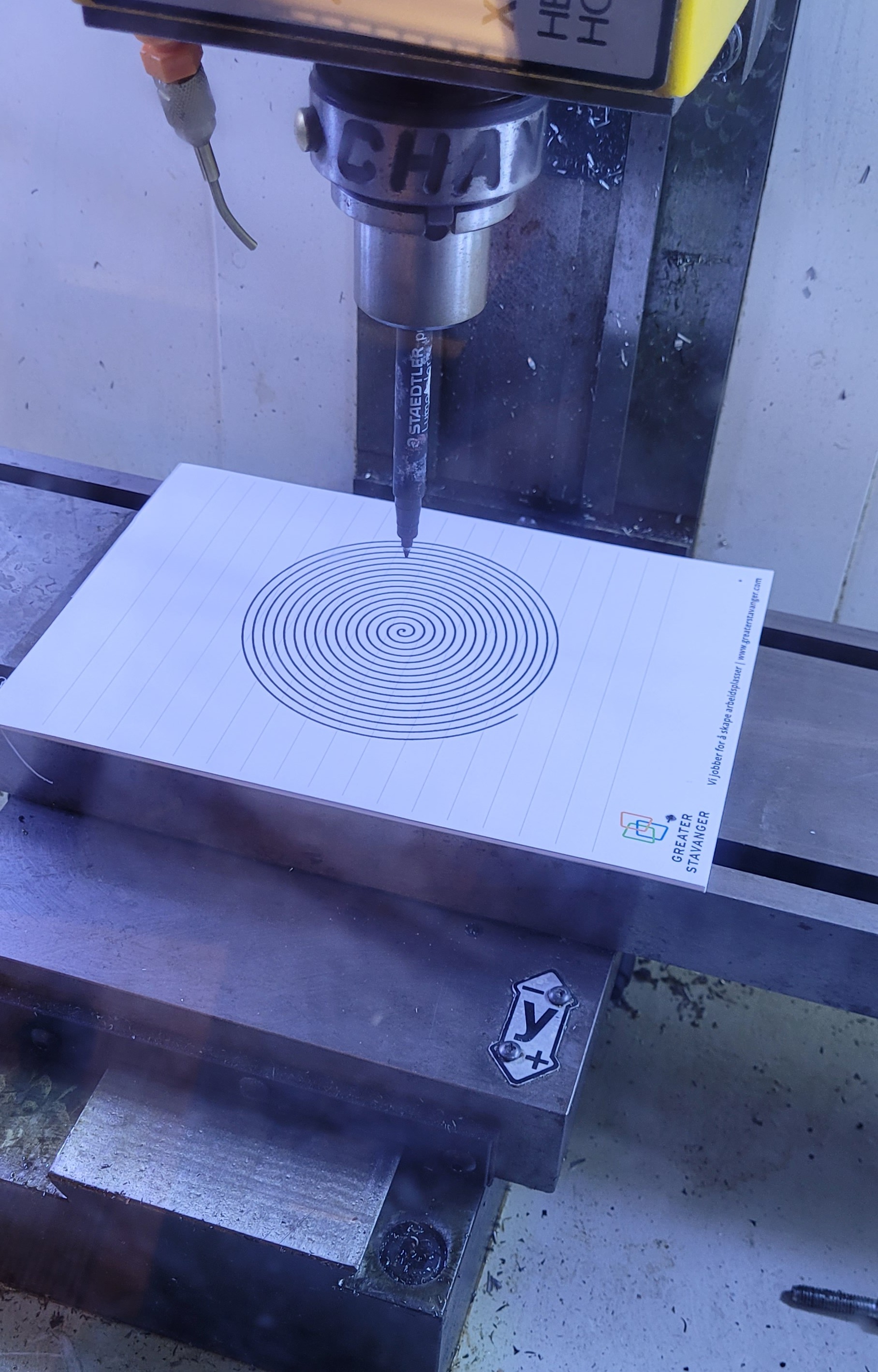

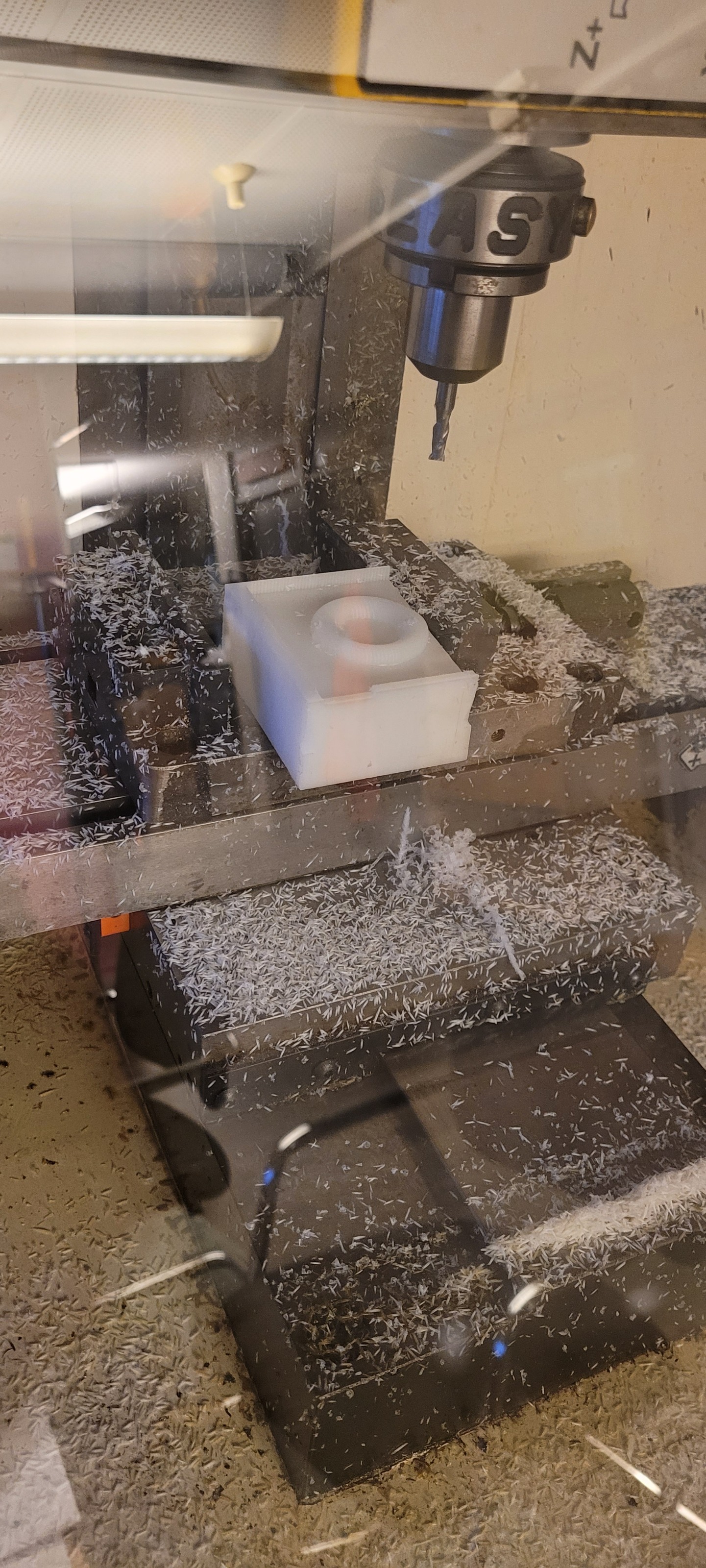

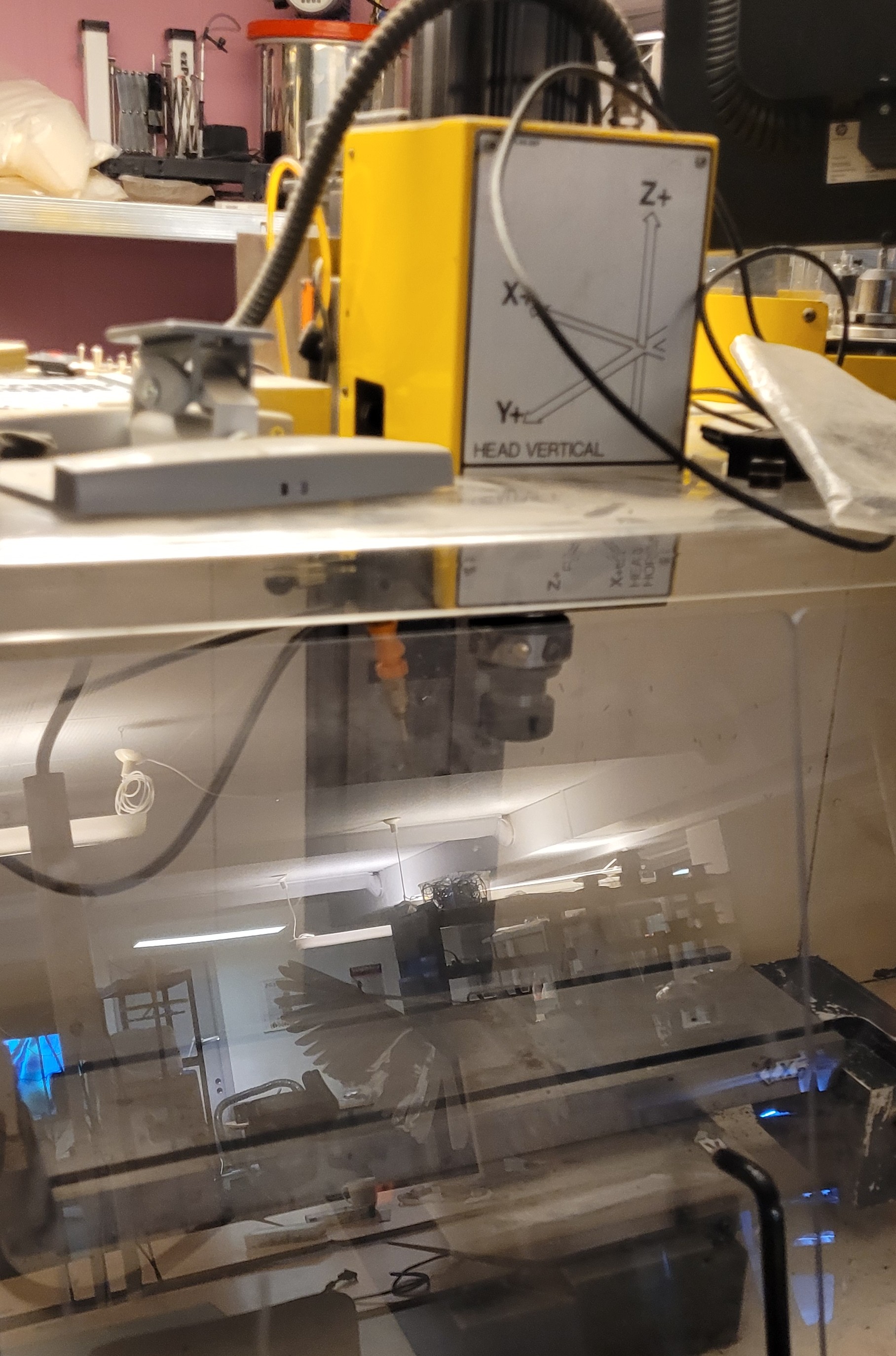

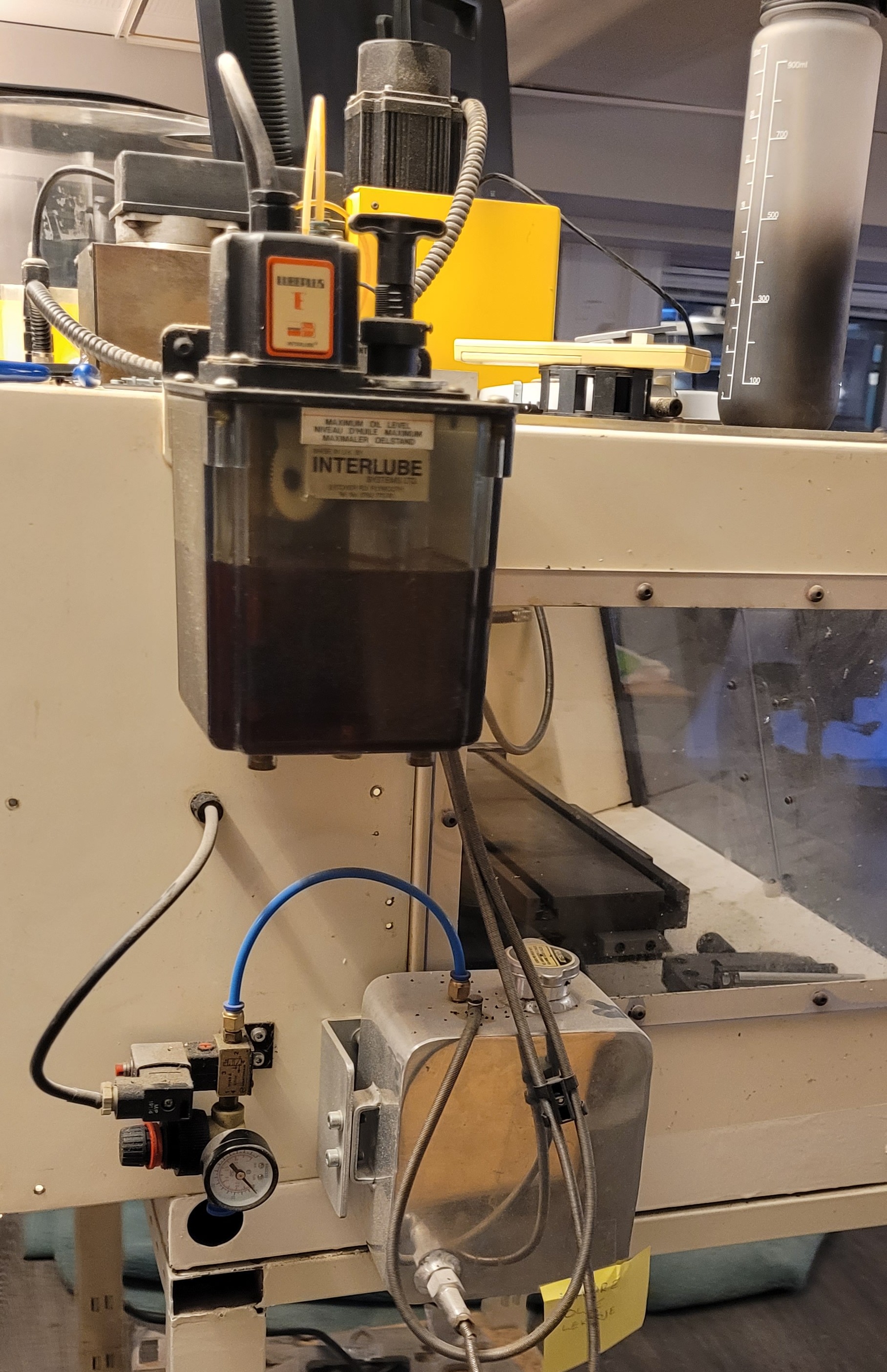

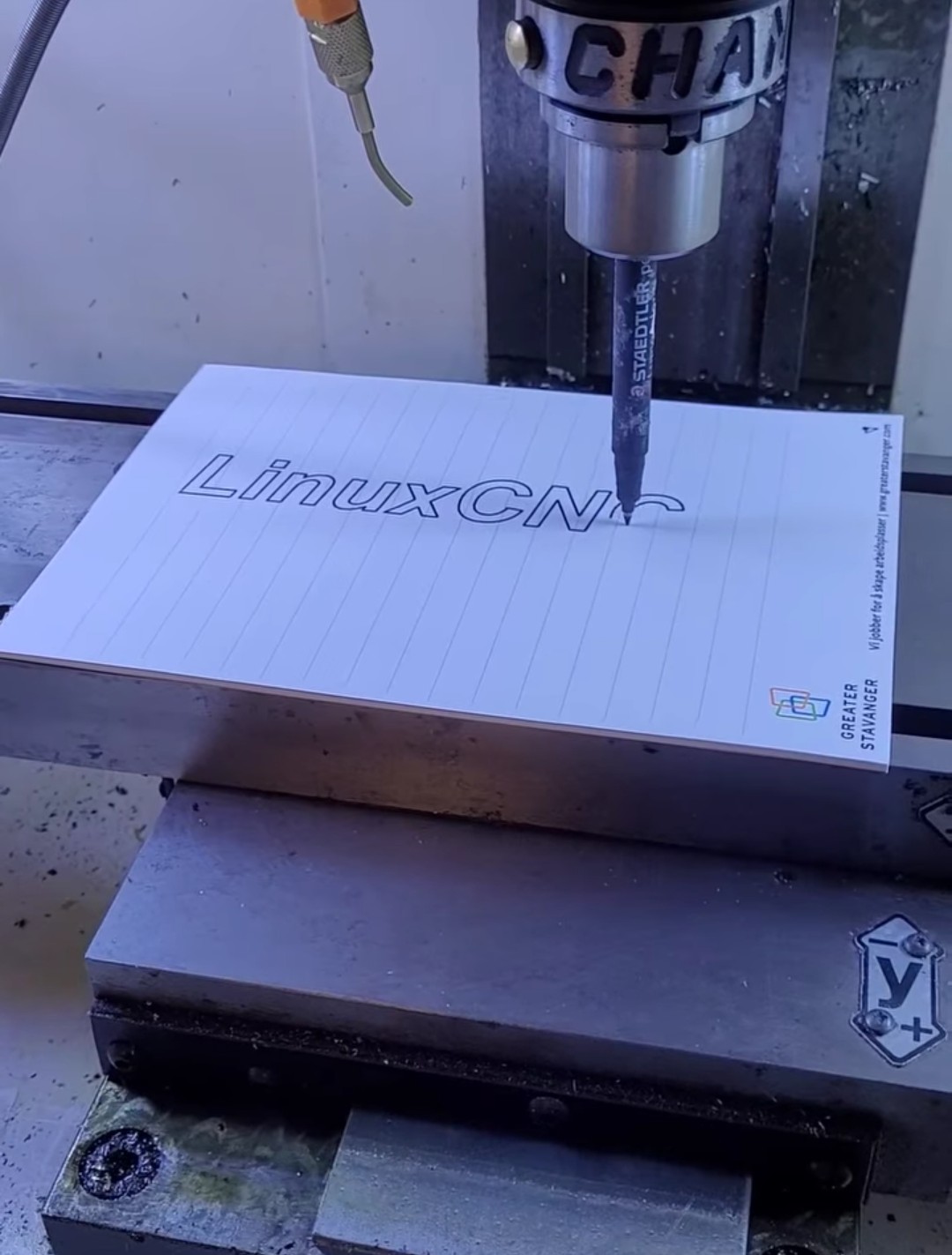

Its an entusiast build in a makerspace.With tool revolver/tool changer on top.added some photosIts name is "Phil the mill
24volt for most attachments
added a few photos
added a few photos

Cute machine!

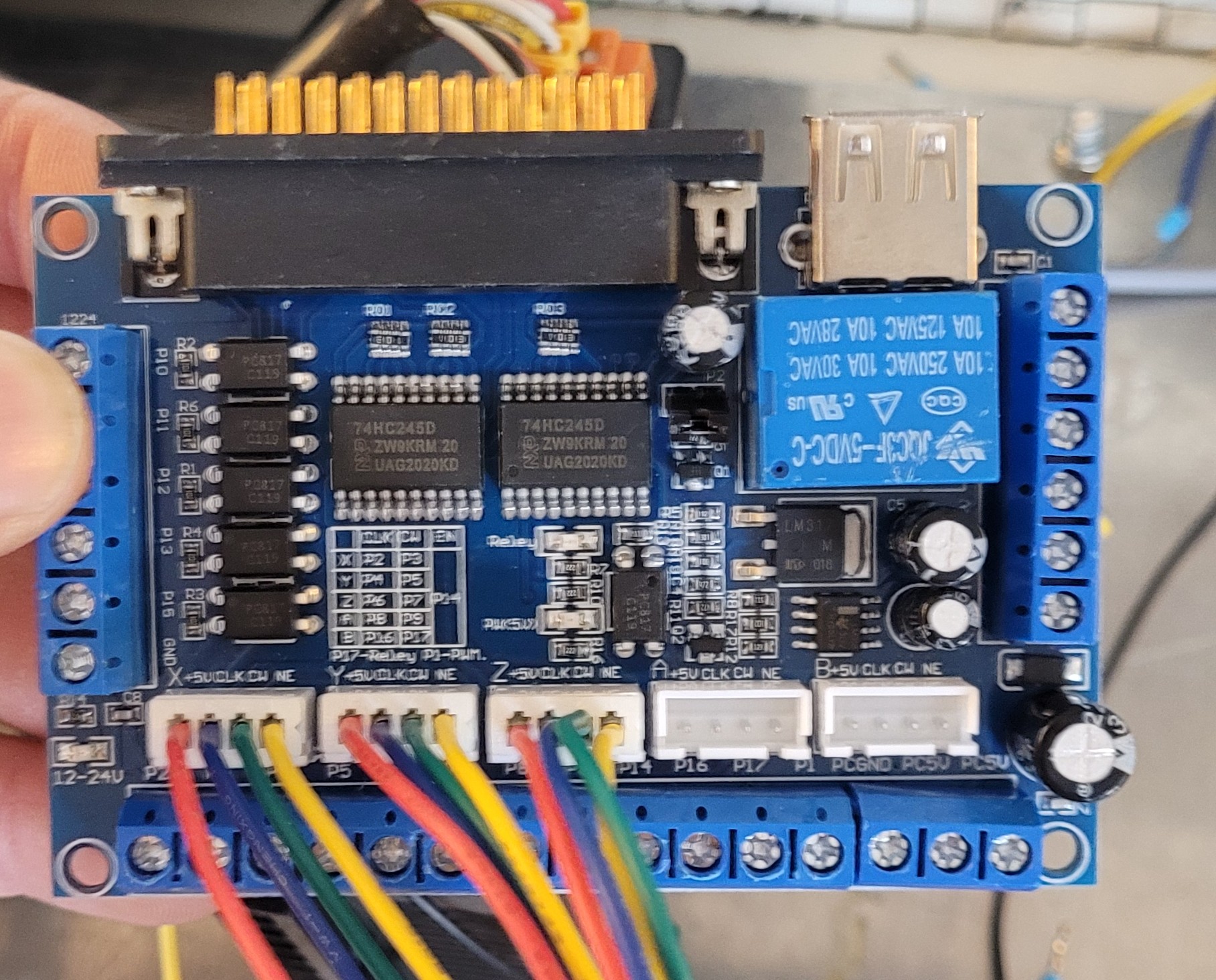

I did test it. But i cheated hooked up 10v to the spindel to make it run correctly.

The BOB in the picture (blue card) should have 0-10V output for spindle, so you might want to try configuring that, but it does require another 12V power supply.
You should double check this as i never used that type of BOB, and in general i do not use BOB's.
