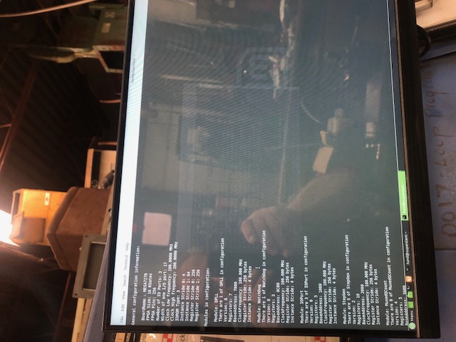

11 Nov 2024 08:43 #314246
by mjones@welfab.ca
Replied by mjones@welfab.ca on topic Mesa, Linuxcnc with step direction servo's for axis and analog servo spindle.
I put in
mesaflash --device 7i76e --readhmid
it said 'no 7i76e board found
I just got called out on a service call, so have to go, unfortunately.
- Posts: 18118
- Thank you received: 5336
11 Nov 2024 08:51 #314248
Replied by PCW on topic Mesa, Linuxcnc with step direction servo's for axis and analog servo spindle.
You need to provide the cards IP address:
mesaflash --device 7i76e --addr 10.10.10.10 --readhmid
or
mesaflash --device 7i76e --addr 192.168.1.121 --readhmid
or
- mjones@welfab.ca
- Posts: 95
- Thank you received: 6
11 Nov 2024 09:07 #314252
by mjones@welfab.ca
