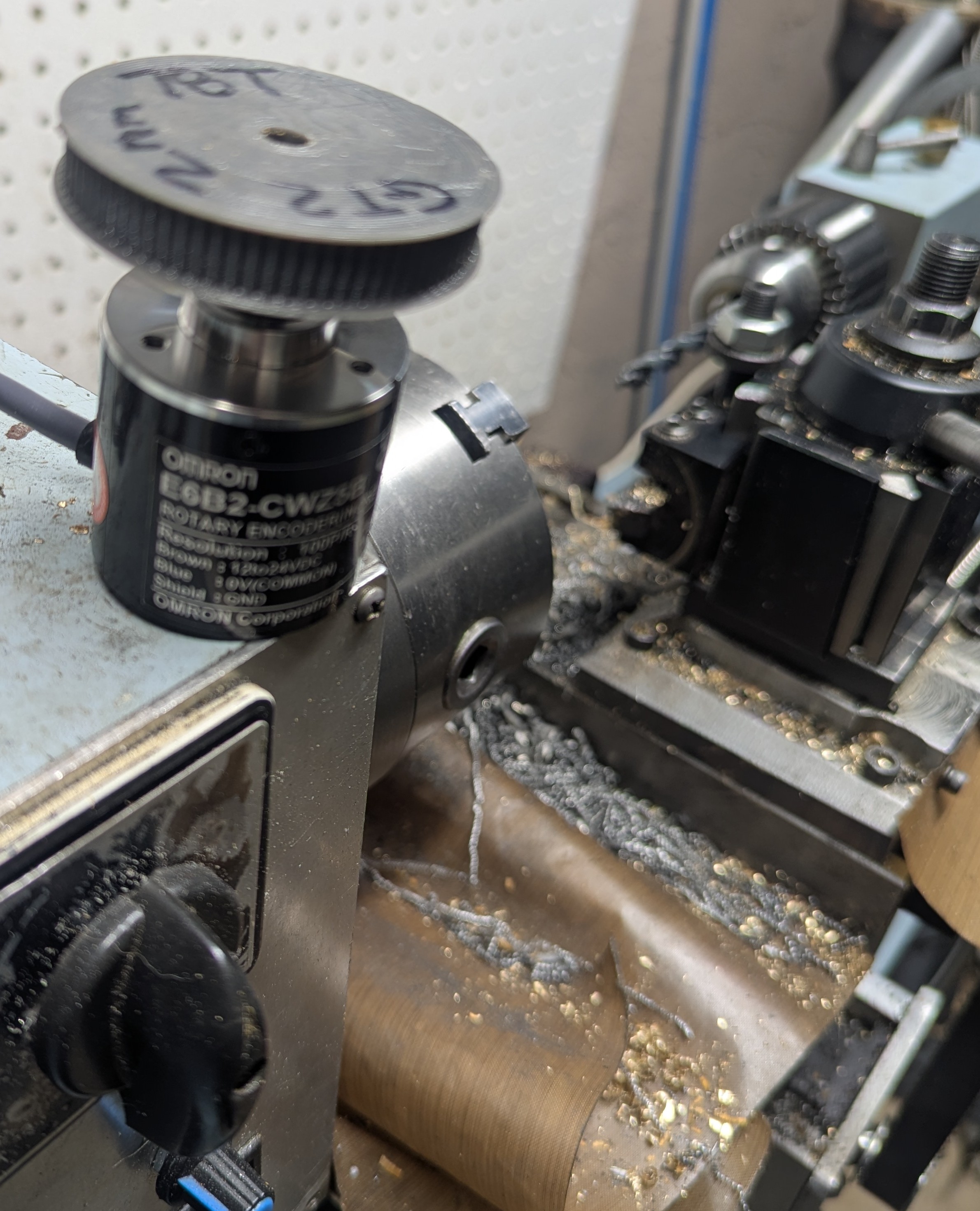

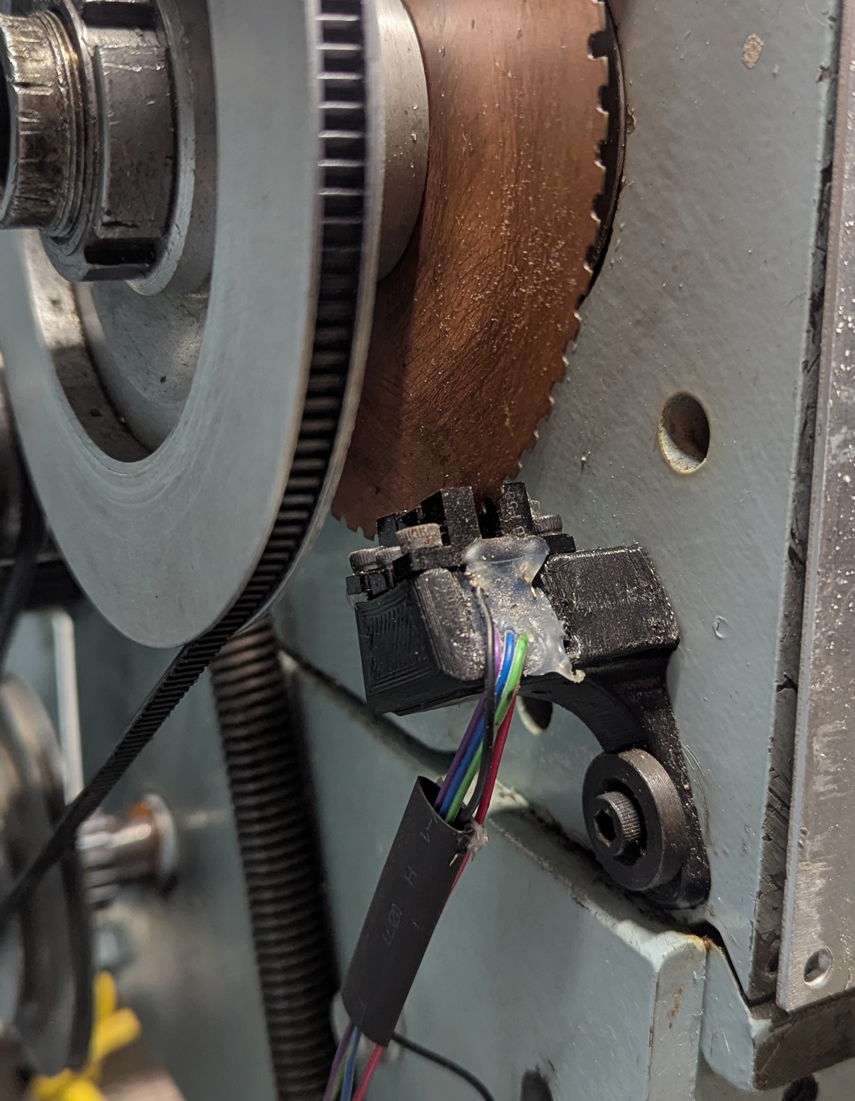

For my 9x20 spindle, I used optical sensors and cut 65 teeth into a thin disk. With two carefully offset sensors I get 260 quadrature counts and haven't had any problems threading 120-150 rpm. A third optical sensor provides the index from a deeper tooth.
I ordered an omron encoder off eBay ($20) that will be a lot cleaner. When I get around to installing it I will probably 3d print gears for a small belt running around spindle and encoder. If you go this route don't go over board on pulses per revolution. 1024 ppr will be more than enough for threading.
The most difficult part of my 9x20 conversion was the modifications to fit a small ball screw under the cross slide good luck!

07 Mar 2025 15:48 #323426
by jtrantow
Replied by jtrantow on topic Lathe spindle index only?
You can get a quadrature signal using the same slots and offsetting another detector approx 1/2 the spacing. It can be a little finicky to adjust but gives you 4x resolution and lets you track direction too. ( Important if you want to use spindle like a dividing head)
I added another detector to pick up index, missing tooth should be fine.
I expect the omron install will be a lot easier. I could probably just wrap a belt around the spindle shaft. The omron encoder spins with imperceptible drag to the spindle just about any belt or string is enough to spin it. I also have an omron encoder that I can position on my mill drawbar for rigid tapping. Janky but functional. It worked with a rubber band while I waited for a gt2 belt. After the mill install I ordered another for lathe but haven't gotten around to installing it.
