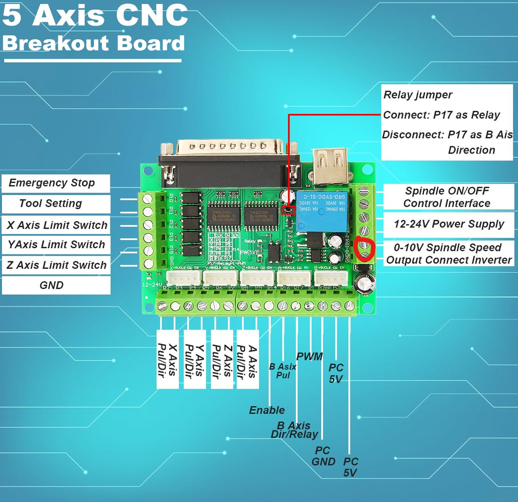

I currently am trying to control my spindle's speed using my BoB's analog output pin. It provides a max of 0-10 V out. I want to use this signal to control my KBIC speed controller, but it requires an analog voltage that is between 0 and 7 V. I'm not sure as to how to go about doing this. I've looked at the documentation but am still confused. I just want to test to see if it is actually working, so if someone could just slap together a HAL file that is able to do this so that I can test it, I would be really appreciative. I want my spindle to go at a maximum speed of 1400 RPM, and on my BoB the analog out is pin 1.

Be careful as many KBIC speed controllers have a analog speed control
input that connect directly to line power, so requires an isolated analog
voltage source.

I believe my BoB is optically isolated (
this is the link to it
). I just would like an example HAL file with my settings. When I measure with my multimeter after using stepconf, I get nothing even after I issue a command like s500 (my axes have all been zeroed).

I tend to think I'm making some sort of mistake. I currently am only making use of the PWM pin, do I also need to include pins for turning my spindle on and off as well?

I just measured it. The 5V and 12-24V voltages are isolated from each other, but 12-24V is also used to power the home, estop and probe inputs on the opposite side of the board. If there is a risk of applying high potential to the 12-24V power supply, it is safer to use a separate cheap Chinese PWM->0-10V board and a separate small power supply. As for the 0-7V range, it is probably enough to scale the spindle speed appropriately (for example, setp pwmgen.0.scale 2000 instead of 1400, i.e. 1400 rpm will be 70% of 10V)I believe my BoB is optically isolated ( this is the link to it).

I tend to think it'll be fine as all I'm using the 24V is for my homing switches and powering the board to let me control the spindle.
Regarding how I go about controlling the spindle, I'm not sure about how to do it. I have attached my hal file below. When I measure the voltage between the pins circled in red I get 0.01 Volts (even after I've homed my axes and and sent it an m3 s500).

You are looking at the wrong side of the problem, BOB is not the part with issues, KBIC is, so you must check and be sure the inputs on the KBIC are galvanically isolated from the rest of the board.
If they are not isolated, ... well i would throw it in the bin, but you can get some kind of isolation probably, or just use a relay to run it at full speed using the relay on the BOB should do, most probably.

I don't have my KBIC attached. I just wanted to see if I could read a voltage of 7 at 1400rpm from the terminals of the bob before I even attach it to the KBIC. The KBIC is not isolated, but the BoB is supposedly.

So no, BOB is not properly isolated for this case.... but 12-24V is also used to power the home, estop and probe inputs on the opposite side of the board.
You should really, really take his advice, and be very careful with wiring.it is safer to use a separate cheap Chinese PWM->0-10V board and a separate small power supply.

I see what you mean now about it not being properly isolated. I'll buy a cheap board off of amazon. In the mean time though, I just want to make sure I know how to set it up in general. I just want to know why I'm not getting anything out of it when I issue a s command.
