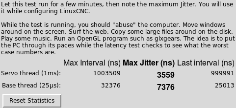

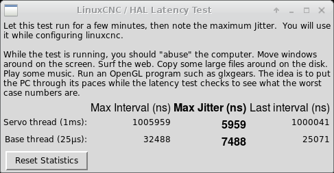

Replying to myself. This was probably my fault. When getting the repository from GitHub, I asked git to checkout version 2.7 instead of v2.7.15. It compiled OK, but still no luck with loading modules.
When executing latency-test it says
insmod: ERROR: could not insert module /usr/realtime/modules/linuxcnc/rtapi.ko: Unknown symbol in moduleStarting linuxcnc with axis yields the following message:

That link actually helped me to move forward a bit. I managed to start the latency-test, and it's looking pretty good with 6 x glxgears, YouTube, and who knows what.
All it took is adding rtai_shm to the module_whitelist[] array in the module_helper.c, and some editing of rtapi.conf file, so it ended like this for now:But the linuxcnc itself is not loading still. This time it is:modinfo sim_spindle.ko gives us hal_lib,rtapi,rtai_math. I think this rtai_math is the culprit. Will try to recompile rtai with diferent vesions of math library (NEWLIB, uCLIB, GLIBC, MUSL) before givig up. It is finicky! An updated SlackBuild included, yet to produce a wotking system...
