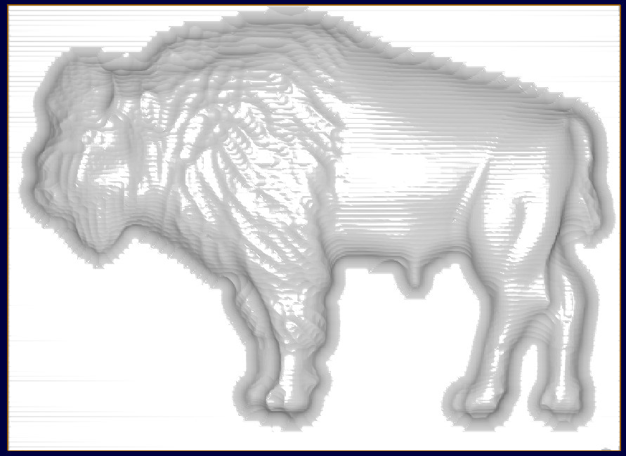

Wow!
Your buffalo is pretty much exactly what I have in mind - guess that's a "plate 3d sculpt"?
I don't know how big yours is, (particularly in terms of depth) or how scalable the gcode is but that image exemplifies the idea.
Now.. the wall this is going on is 118" (nearly 3M) wide by 90" (about 2.25M) from carpet to ceiling so net about 118 x 82 seems likely. My big issue, other than the gcode, is ensuring that the wood doesn't warp or expand/contract and that will be affected by the depth needed for the image. So, for this to work, how thick do you need the wood to be?

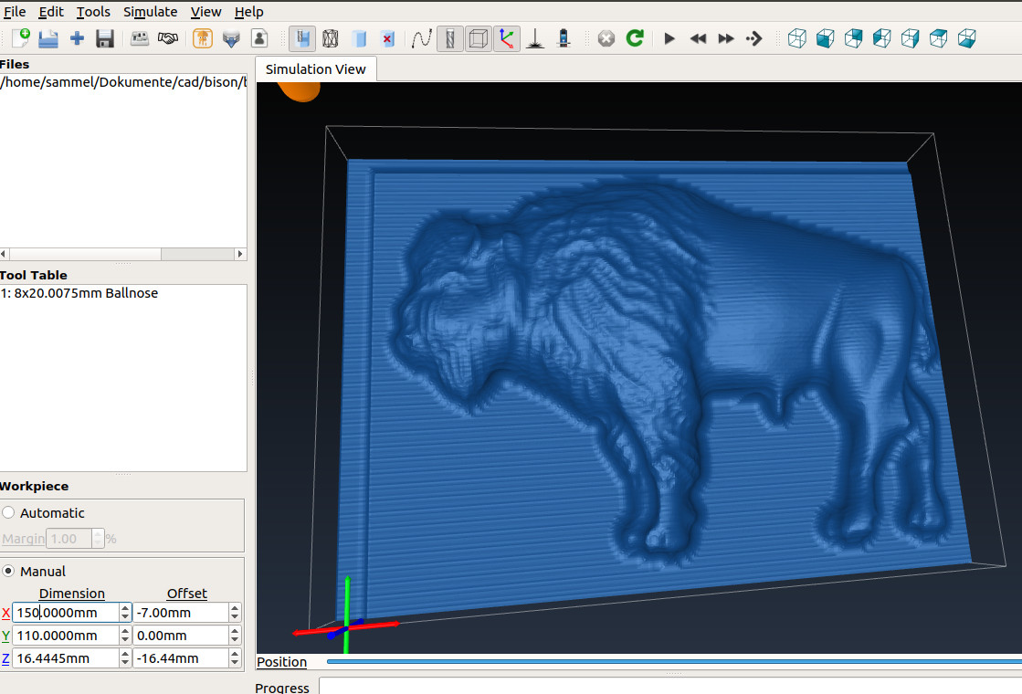

this is all scalable in all axis
Primary wood be to know what your friend can do
the toolsize BALL Cutter
the mashine Rough capability (( ok Feeds can be Changed )))
BUT nit the steps
IS Your friend able to get a G-code from a STL file i guess YES as he ownes a mashine
I will do a Gcode on your Request of the TOP tread

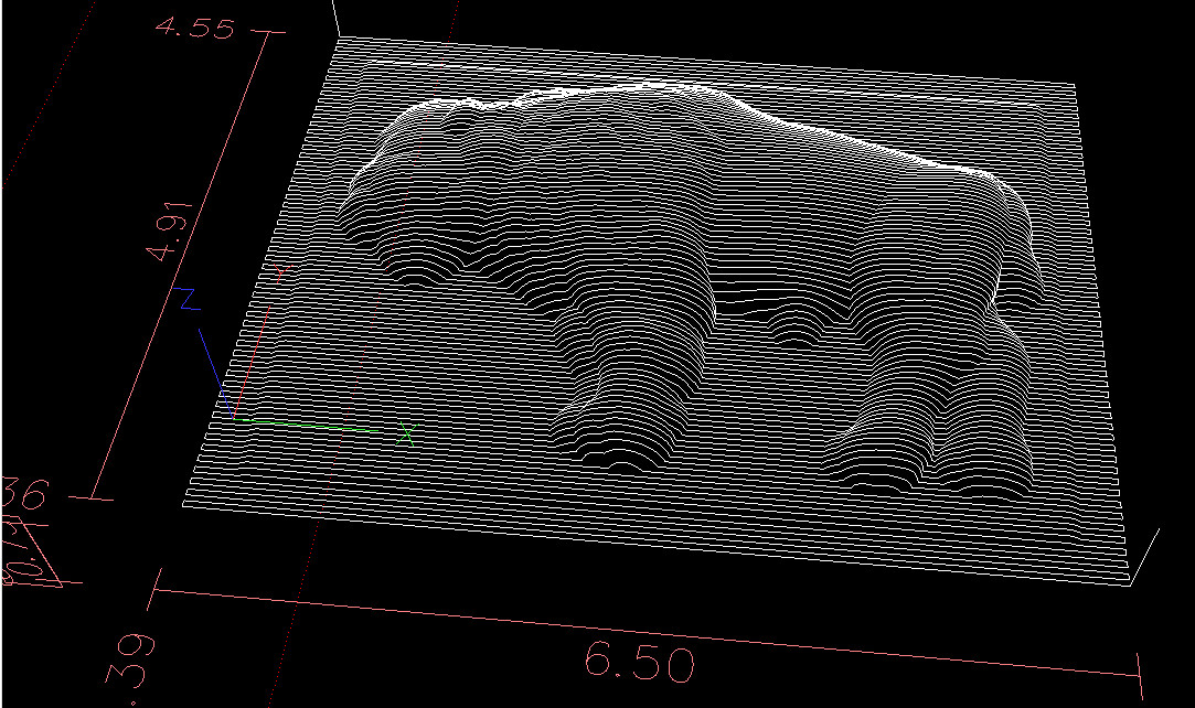

If the router in question runs LinuxCNC then you can just open the JPEG file in Axis.
That will automatically run the image-to-G-code application.

the image is to Dark for details
Tryed it
