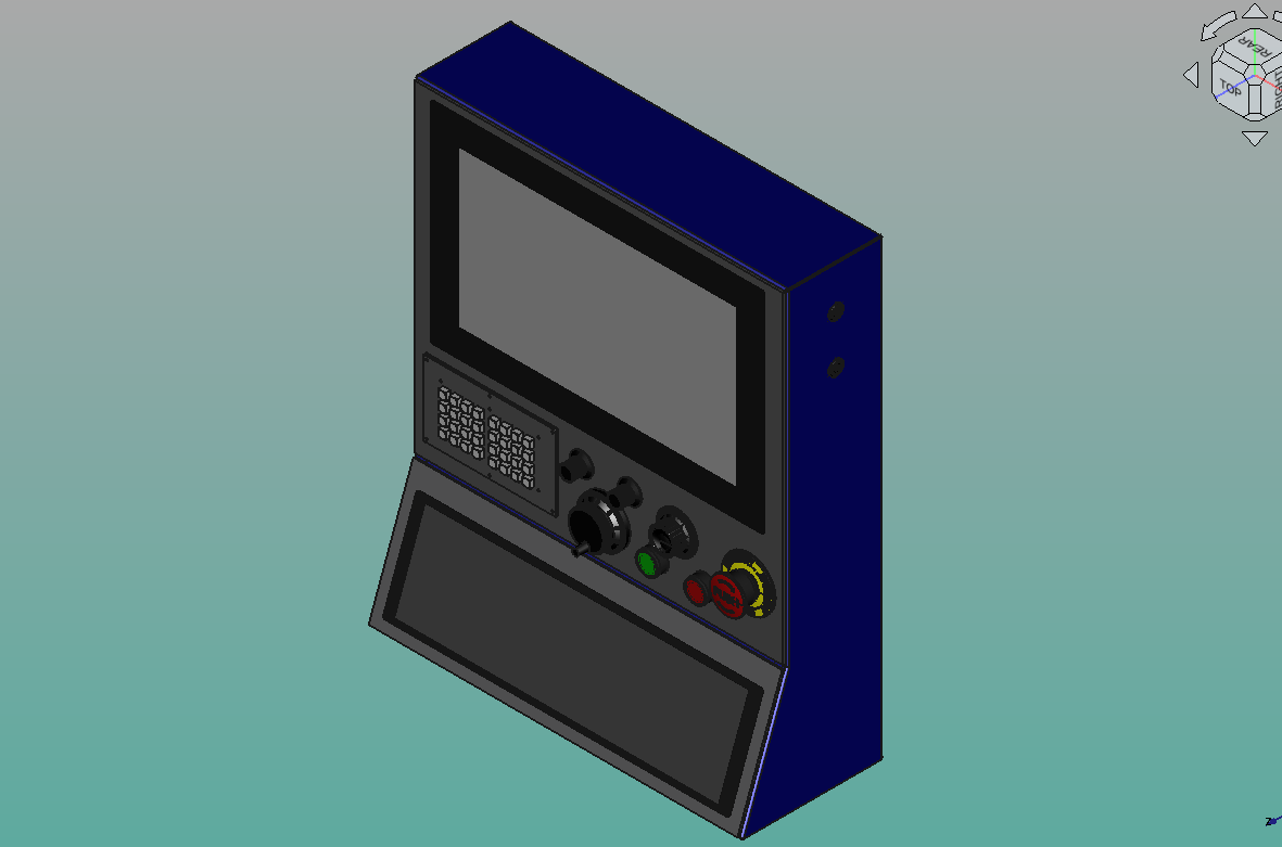

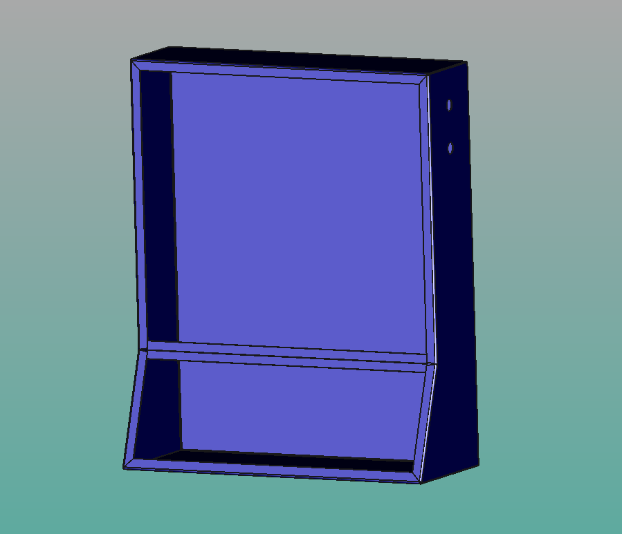

I sent an RFQ to sendcutsend for this but it dawned on me that there's probably some fellas around here with a cnc plasma/laser and a finger brake that might want some work. I can do the welding, just need it cut and bent. Thinking 18gauge steel for this.  The unfolded measurements are about 34" x 32" and after bending it's about 22" x 18". There's also 1/8" aluminum front panels that need to be cut for it but I'm more worried about the steel enclosure.

I've got a plasma that can handle it no sweat, but no finger-break.  I've found that if you're going to be welding, intermittent slots along the bend lines makes it easy to bend and then run over it with the tig.

I suppose that's a possibility. I can machine a 1/2" aluminum chill bars that sit inside the cavities that make that go a bit easier. I suppose it comes down to the cost difference of having to do alot more welding and grinding vs getting it all properly bent. Any guidance on the slot dimensions for a minimal gap on 18gauge?

Regarding the slot, it'd just be a kerf width - say 0.040" wide using the fine-cut tip.  I just clamp some stiff bars on both sides of the section to be bent and go to town with channies.  A 2" slot by 2" uncut segment makes for easy bending and not a miserable amount of welding.

Good price for that enclosure, bit too small though. I already have an industrial keyboard and monitor in mind so the size kind of revolves around those (about 22x18x4).
If it were like a one off thing I'd just cut up a sheet of 1/8" aluminum....I can tig 1/8" aluminum like nobodies business lol. I wanna make a few of these as like a standard controller for any machine I might do in the future. I'm going through the effort of making specific PCBs for key matrix's and stuff so it's not a huge wiring project to get one going.
Still working on it but the end goal is something like this:
