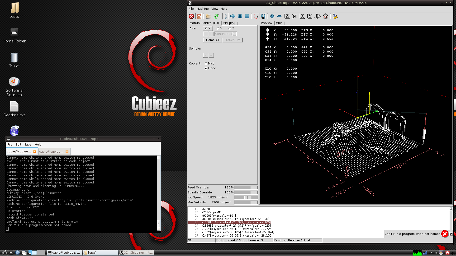

I was testing a few theorys regarding that's errors, the problem was solved I managed to put to work, but cost to me one entire day and a several cups of coffee, but I think that solution could help everybody what will work with that platform.
It was, simply the python libraries, i thought that's the problem was on the kernel, because the cubieboard doesn't boot like the raspberry with a partition mounted on /boot , he has a u-boot and the allwinner's developers have not distributed that codes yet for rebuild-it. The steps on the link work very well, if someone will try, my suggestion is to follow that instructions and install the python-tk libraries.
fortunately the problem was not in the kernel, I was managed to perform a latency-test on a cubieboard2 without any problem, I'll post a picture of that running, I still making the HAL patch's to run the step/dir commands over GPIO, so, soon I will publish my results.

That is some serious max jitter you have there (5.2M) :laugh:

I'm guessing the huge latencies are because thats a stock kernel, not a RT kernel
CaptHindsight and Memleak on IRC managed to get either
Xenomai or Preemt_RT running on the Cubie2 with ~ 80 usec latency IICRC
