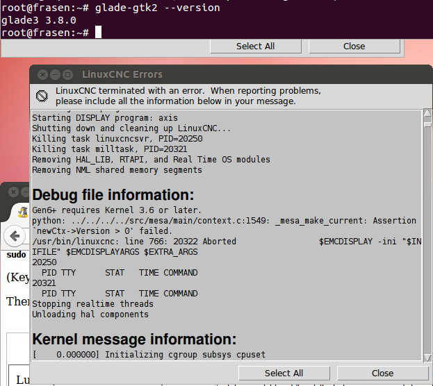

08 Oct 2014 04:49 - 08 Oct 2014 04:51 #51867 by Swapper
Hi
Installed a fresh Ubuntu 12.04 and followed this guide
wiki.linuxcnc.org/cgi-bin/wiki.pl?UpdatingTo2.6
Getting some problems i cant get my head arround, and the searches im doing on the subject is not many.
File Attachment:
File Name: debug.txt
File Size:65 KB
Last edit: 08 Oct 2014 04:51 by Swapper.
08 Oct 2014 04:55 - 08 Oct 2014 04:57 #51868 by BigJohnT
Unless there is some reason to use Ubuntu it is better to use Debian Wheezy so I've been told.
www.linuxcnc.org/index.php/english/download
This does seem to be the problem.
Debug file information:
Gen6+ requires Kernel 3.6 or later.
python: ../../../../src/mesa/main/context.c:1549: _mesa_make_current: Assertion `newCtx->Version > 0' failed.

08 Oct 2014 13:19 - 08 Oct 2014 13:22 #51876 by Swapper
i tried Wheezy and got nothing but problems getting it as good as ubuntu since VNC support is diffrent using X11vnc.
And the whole reason i upgraded to 12.04 was to get my new Dell touchscreen working (Quanta chip) and that did not run in Wheezy.
Got the touch working yesterday in Ubuntu 12.04 but hit the problems in my first post.
As i understand this its a intel driver for my grapics card that is yelling that it needs a newer kernel.
askubuntu.com/questions/300300/intel-hd-...ntu-12-04-kernel-3-5
Anyone know if there is a 3.6 RTAI kernel available for Ubuntu 12.04 ?

08 Oct 2014 15:19 #51879 by ArcEye
Hi
Your basic problem is that you are trying to run Linuxcnc with hardware not supported by the available kernels.
That is very often the case when trying to do everything on one machine.
I am not sure why VNC is important, that is normally a sign that the user is unable to wean themselves off windoze and just wants to access Linux from windoze
If you were remotely accessing a machine running Linuxcnc from the machine with the HD3000 chip, none of this would be an issue.
There are no > 3.6-rtai kernels I am aware of for 12.04. It may be LTS, but effectively 12 and 13 are dead and the libraries are getting old..
There is a 3.8.13-rtai kernel in the MachineKit repos running on Trusty (14.04)
It has corresponding headers and realtime
deb.dovetail-automata.com/pool/main/
You would need to check that it has the correct drivers built, but no reason to think they would not be.
regards
