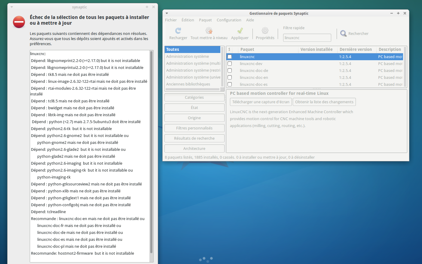

- metal89
- Posts: 10
25 Apr 2015 00:08 #58088
by metal89
Replied by metal89 on topic Linux CNC and Xunbutu
I attached a screenshot of the dependencies that are lacking.
- Posts: 23550
- Thank you received: 5019
25 Apr 2015 00:09 #58089
Hmm, I see.
Well, all it is really doing is setting up the software sources, which you can do by hand.
However, I just noticed that I don't know what version of Xubuntu you are using. Is your version of Xubuntu based on Precise Pangolin, Lucid Lynx or Trusty Tahr?
Replied by andypugh on topic Linux CNC and Xunbutu
the lucid script aborts on Xunbutu.
Hmm, I see.

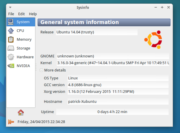

- metal89
- Posts: 10
25 Apr 2015 03:39 #58093
by metal89
Xubuntu 14.04 Trusty
See attachment for details
my desktop is Xfce 4.10
Patrick
Patrick
- Posts: 23550
25 Apr 2015 04:14 #58097
That is likely to be fun.
You are probably going to have to compile LinuxCNC from source. (not actually very difficult) but the real problem is likely to be the realtime kernel.
Which kernel version does 14.04 need?

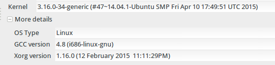

- metal89
- Posts: 10
25 Apr 2015 13:08 #58105
by metal89
the kernel is 3.16.0
see attachment for full details
- Posts: 23550
25 Apr 2015 20:14 #58112
Well, there _is_ someone running LinuxCNC on an RTAI version of that kernel:
mail.rtai.org/pipermail/rtai/2014-December/026592.html
How much of a voyage of discovery do you fancy?
