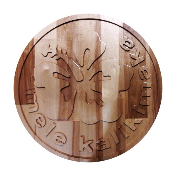

Attachment above was a project ran on the mill this time a year or two ago approx. 12" [305mm] diameter.
The screensaver cut in and pushed my jitters to 15k ns for Servo and 25k ns for Base.
