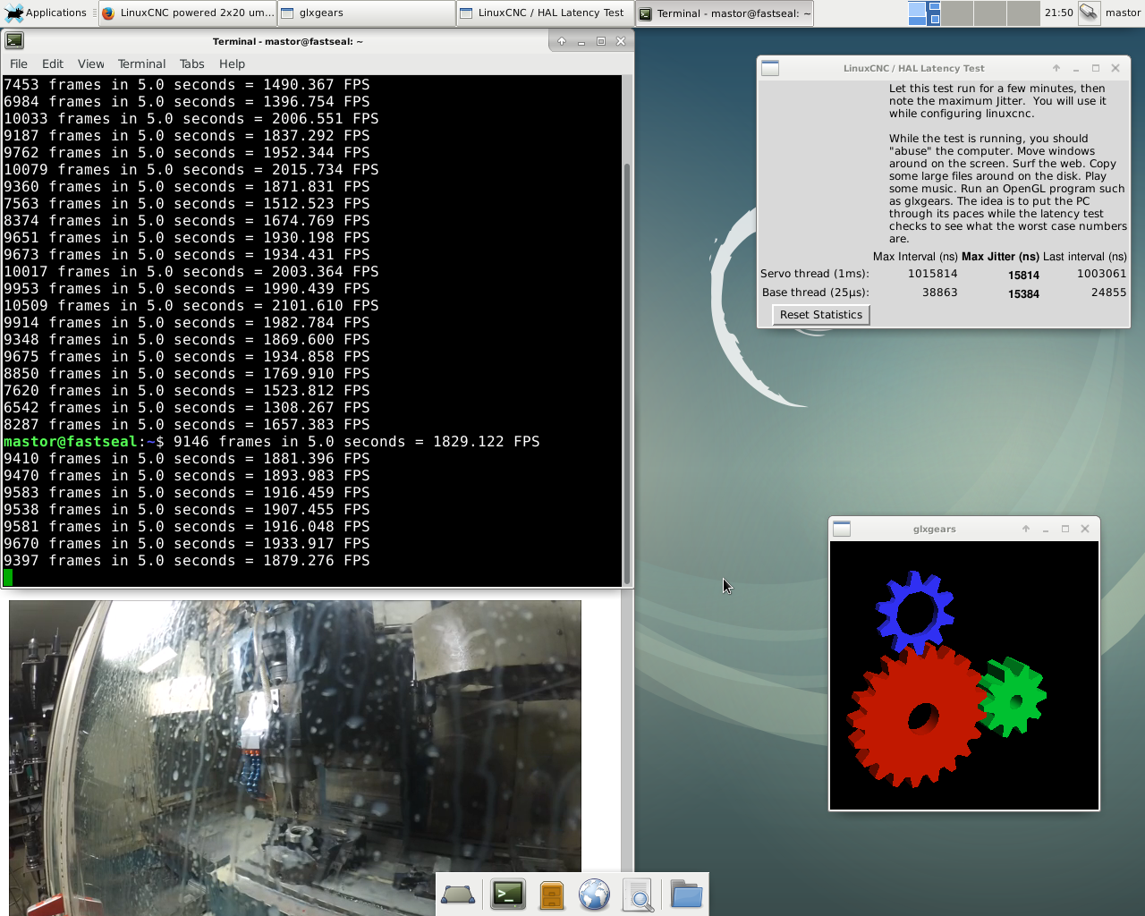

I know that you are asking for ubuntu.
If you want to try debian, just download and install the latest, debian in www.linuxcnc.org/testing-stretch-rtpreempt/
(note: It is experimental, but I am running a older version at about one year on a daily use machine without major errors)
This version have most of things working out of the box like ubuntu.
I just did (right now on a new setup), and without any tweek, mods, drivers, bios changes, anything I got the attachment...
It is a 30 min job.
Update: While downloading and installing packages I got a worst latency, but still a good one:
1ms: 20124
25us: 15384
