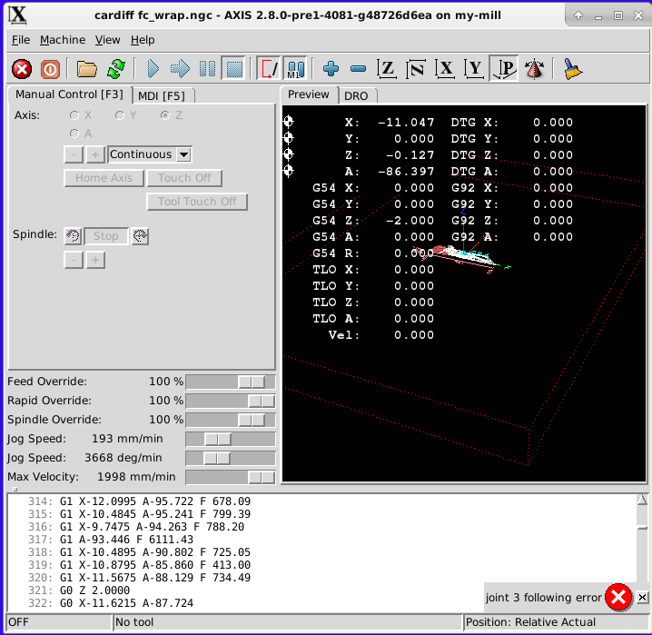

Hi guys, and seasons greetings. I haven't been on the forum much lately as I haven't had any issues or been able to assist in any way.
Until now that is???
I have been using, testing, playing with www.linuxcnc.org/testing-stretch-rtpreempt/ from pretty much day one of it being there and always kept up with the latest version.
I think it currently dishes out version 2.7.14 but I could be wrong, whatever, it works flawlessly for me and I love it.
Recently, in fact, yesterday I did an apt-get upgrade for another reason and it pulled down version 2.8.0-pre1-4081-g48726d6ea.
Fine I thought, I have used the testing 2.8 versions before and known no difference, all worked well.

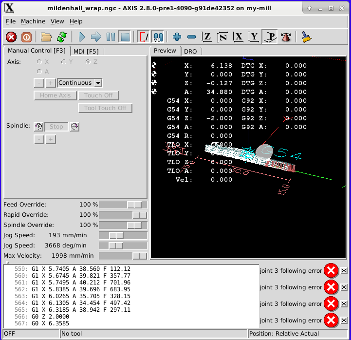

Unfortunately for me, this version plays havoc with my A axis, "joint3 following error" is the warning but no specific error is given.

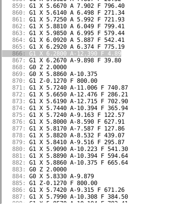

I have attached a pic of the line it stalls on and I have to skip a line to resume.
I have also added sample files if anyone wants to replicate the issue. File 1.ngc works perfectly but when wrapped for rotary as in 1_wrap.ngc it gives muchly grief.
And this is an issue through all my wrap files which work perfectly well in all previous versions.
Any thoughts other than going back to the install version which of course I have done?

It might be useful to plot the following error with halscope to get a handle on whats going wrong here.

A following error _is_ a specific plottable error
That is you can trigger halscope on the following error to get
some idea of whats going wrong.
If you "halscope" joint.3.f-error and trigger on joint.3.f-errored
you should get a lot more information than just the fault popup.
Its probably useful to plot joint.3.vel-cmd at the same time

OK I'm a bit confused here, Your hal and ini files are LinuxCNC 2.7 version files (using Axis not joints)

Your old 2.7 config has a MinFerror of 0.25 for A
The new 2.8 config has a MinFerror of 0.10 for A
If you change the value, you will have the same behavior in both configs!
