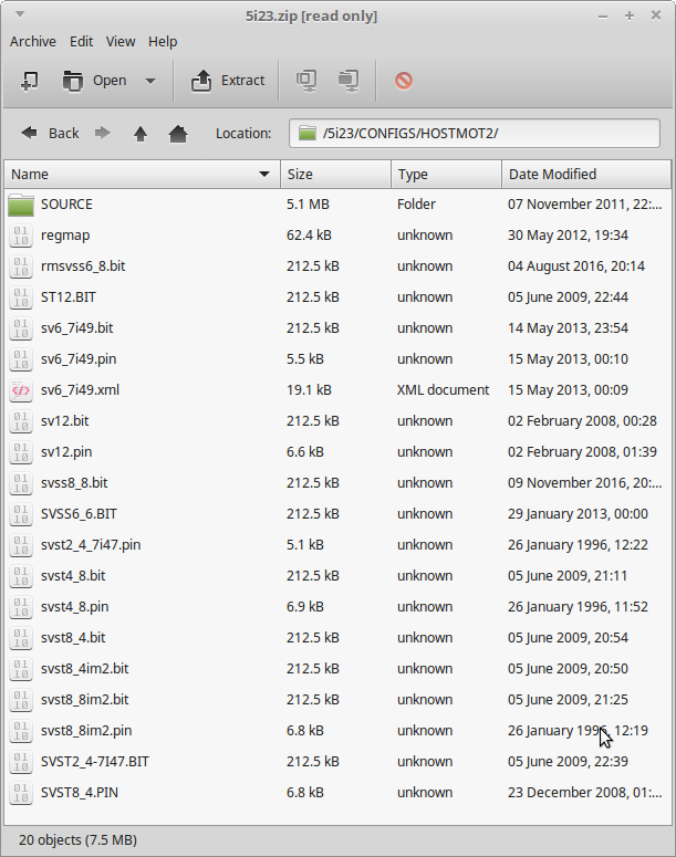

I installed a fresh machine with stretch and preempt following instruction on gnipsel.com, (thank's John for that)
- cp over my config files from another machine running wheezy and 2.8.
- configs fail to start because of missing Mesa firmware files.
- opening synaptic search hostmot2 -> no results
I know there is a lot of possibilities to get mesa firmware to the right place on my computer and make my new install work.
But because I see a lot of cleanup going on I'll ask
What's the "official way" to get mesa firmware installed by apt?
Ju

18 Jun 2019 11:29 #137180
by BigJohnT
Replied by BigJohnT on topic stretch install no hostmot2 in synaptic
For some reason unknown to me the hostmot2 drivers are not in stretch. The last release to have the hostmot2 drivers was Ubuntu 10.04 Lucid.
I searched through the linuxcnc.org/dists/ to be sure. The hostmot2 drivers are in the base/source directory.
You would have to build and install the hostmot2 drivers from the github repo.
github.com/LinuxCNC/hostmot2-firmware
JT

- jgnoss
- Posts: 28
18 Jun 2019 15:17 - 18 Jun 2019 15:24 #137193
by jgnoss
Replied by jgnoss on topic stretch install no hostmot2 in synaptic
As I wrote in my last post, I do have that firmware on another machine, so I don't
need to build them myself.
The question is, what do another users do if they come across that problem?
What do you do suggest?
Changing the wiki to say
- users have to install the Xilinx ISE and compile the firmware themselves
- hacking the apt source list file to get the firmware from older Debian distribution
- downloading it from somewhere else in the web
I think we shouldn't provide hack's, better is straight forward install.

- jgnoss
- Posts: 28
18 Jun 2019 15:56 - 18 Jun 2019 15:57 #137201
by jgnoss
You guys are talking about drivers.
I may be ignorant but isn't it the firmware for the Mesa cards that's missing?
If I copy the firmware to the right folder on my new stretch install all works fine.
On my understanding, the firmware is the bit code that get's loaded into the FPGA
that sits on mesa cards like 5I23.
That code is not easy to compile/generate. Installing the xilix ISE is pretty heavy load.
Isn't it easier to provide precompiled firmware for that cards in binary and include that
in the distro tree as it was before?
