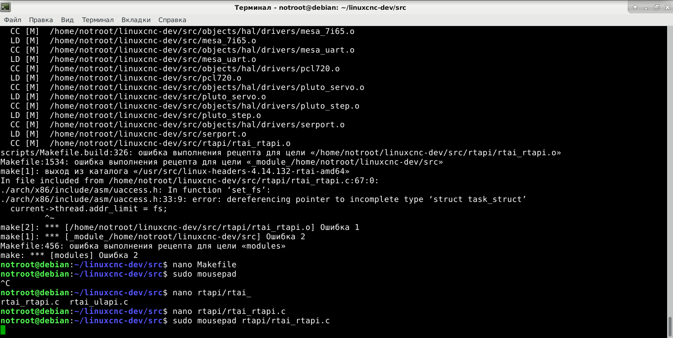

UPD:
I installed linuxcnc-stretch-uspace-amd64-r13.iso and check latency:
~136000
After that I removed linuxcnc and installed 4.14.132-rtai kernel with user version of linuxcnc. Latency test showed: ~30000
It is very fine for my work, but I need dev version to add my changes.
I removed linuxcnc and download linuxcnc-dev version. I typed "make" command and it crashed with error (attached). I think this problem with changes in new kernel. But default version worked. Why?)
~136000

I don't know what you mean by "linuxcnc-dev version".
Andy's packages don't require any building, just installing.
If you want to build from source here is the howto:
wiki.linuxcnc.org/cgi-bin/wiki.pl?Building_RTAI_5.2_Packages

7 years 3 months ago #141061
by neller
Replied by neller on topic The image of new system with RTAI
Thank you again, Bari.
"You must first apply all patches to LinuxCNC located in the linuxcnc_patches directory of the NTULINUX/RTAI repository before you run ./autogen.sh inside it's source tree." - it is the solution
