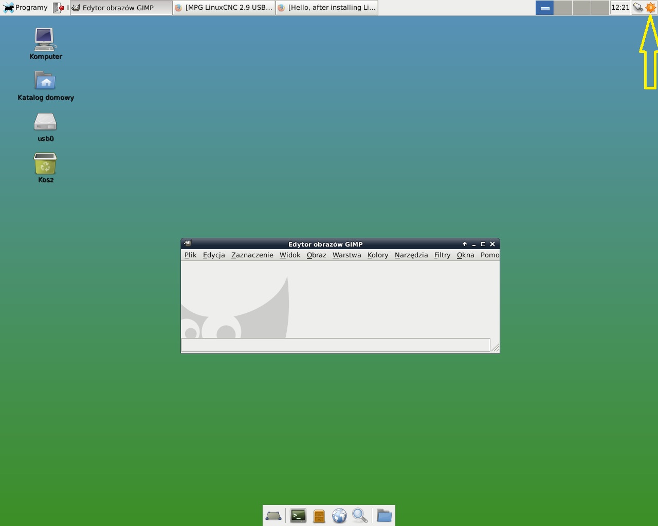

Hello, after installing Linuxcnc 2.7.14, my terminal commands don't work was created by jarcysgru
lsusb
sudo apt-get install caja
sudo apt-get install gedit
j@debian:~$ lsusb
bash: lsusb: nie znaleziono polecenia
j@debian:~$
j@debian:~$ sudo apt-get install caja
[sudo] password for j:
Czytanie list pakietów... Gotowe
Budowanie drzewa zależności
Odczyt informacji o stanie... Gotowe
E: Nie udało się odnaleźć pakietu caja
j@debian:~$
j@debian:~$ sudo apt-get install gedit
E: Nie udało się odnaleźć pakietu gedit
j@debian:~$
lsusb
j@debian:~$ lsusb
j@debian:~$
j@debian:~$
j@debian:~$

- BeagleBrainz
- Visitor
26 Jan 2020 14:22 #155844
by BeagleBrainz
Replied by BeagleBrainz on topic Hello, after installing Linuxcnc 2.7.14, my terminal commands don't work
- jarcysgru
- Posts: 104
- Thank you received: 6
26 Jan 2020 14:59 #155851
by jarcysgru
Replied by jarcysgru on topic Hello, after installing Linuxcnc 2.7.14, my terminal commands don't work
- BeagleBrainz
- Visitor
26 Jan 2020 16:58 #155866
by BeagleBrainz
Edit your /etc/apt/sources.list to exactly what is shown in the linked post.
Run sudo apt-get update
Then you can install extra packages as required.
I know this works. I did a clean install of Linuxcnc 2.7.14 iso 4 days ago and made the changes, then I posted the required changes.
Note that all lines with wheezy/updates have been commented out.
To install caja the following 2 lines must be added to /etc/apt/sources.list after doing the above
Then run
lsusb is from usbutils
run
I have confirmed this working
deb http://archive.debian.org/debian wheezy-backports main contrib non-free
deb-src http://archive.debian.org/debian wheezy-backports main contrib non-freeThen run
sudo apt-get update
sudo apt-get install cajalsusb is from usbutils
run
sudo apt-get install usbutilsI have confirmed this working
